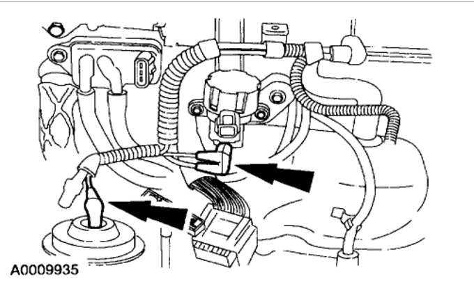

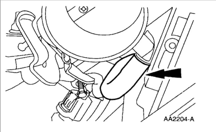

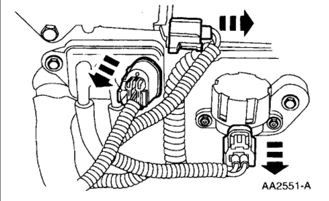

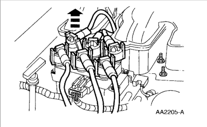

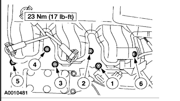

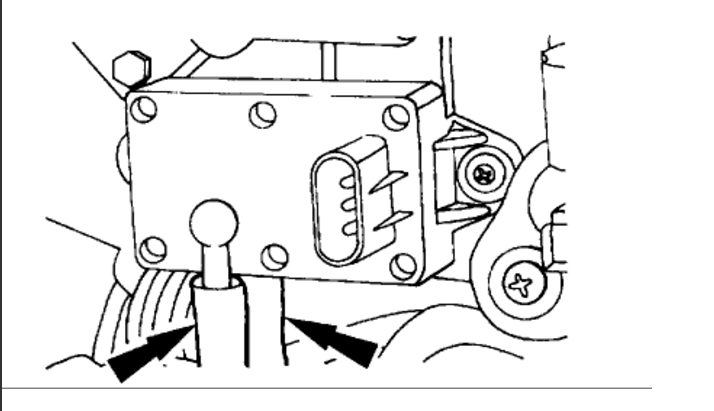

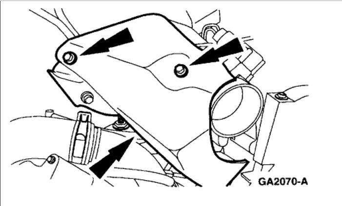

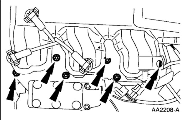

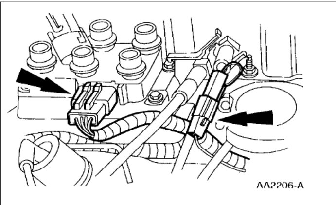

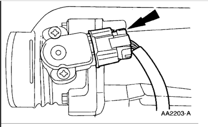

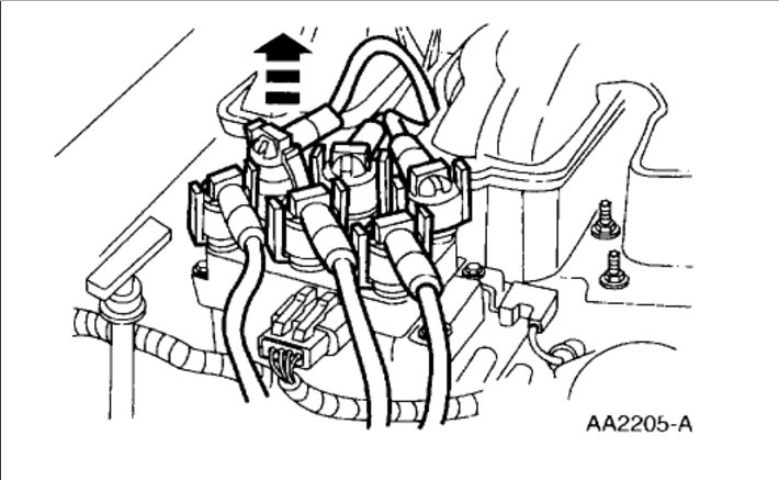

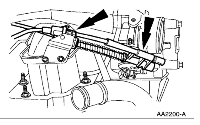

what is the torque and sequence?
Aug 3, 2017 at 12:06 PM
Experienced Mechanic
55,658 POSTS

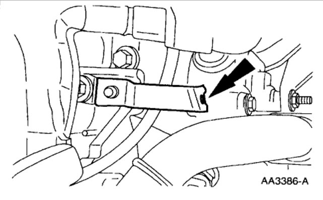

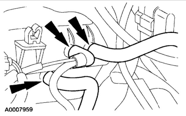

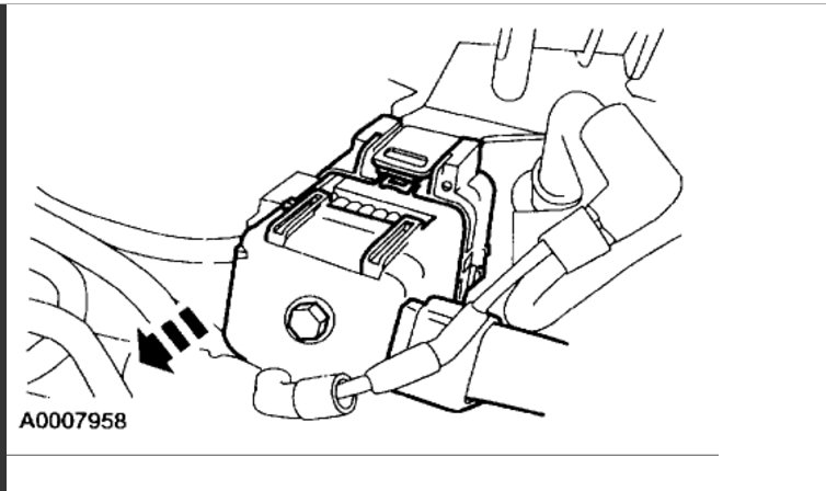

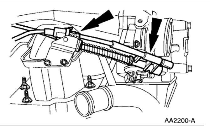

Here is a guide that will give you an idea on what you are in for when doing the job and I have included the torque secs and sequence so you can get the job done.
https://www.2carpros.com/articles/replace-intake-manifold-gasket
Images (Click to enlarge)
Aug 5, 2017 at 1:26 PM
55,658 POSTS
Check out the last image in the series it shows the torque and sequence.
