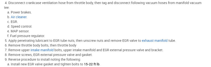

I need the torque specs for the upper intake manifold on the truck listed above.

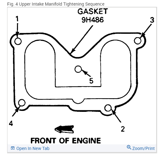

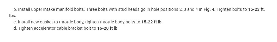

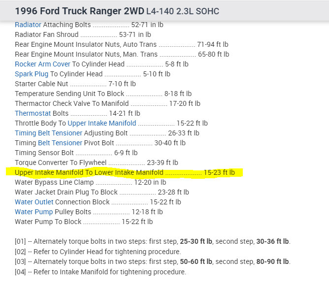

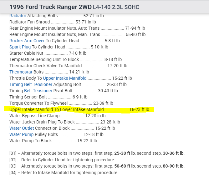

As far as the torque specs are concerned, see pic 1 below.

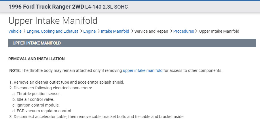

I don't know if you need them, but the remaining pics are the directions for the removal and replacement of the upper intake manifold. I don't know if you already did the work or not, so I figured I would add them in case. Plus, they include the torque sequence when tightening them.
I hope this helps. Let me know how things turn out for you.
