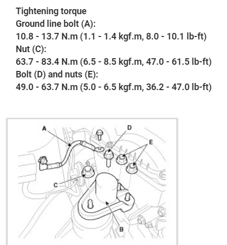

What are the torque specs for the upper engine mount bolts on the car listed above? Haynes manual didn't have any specs that I could find.

Here is the information you requested. I've attached a picture below for you.Hope this helps and thanks for using 2CarPros.
