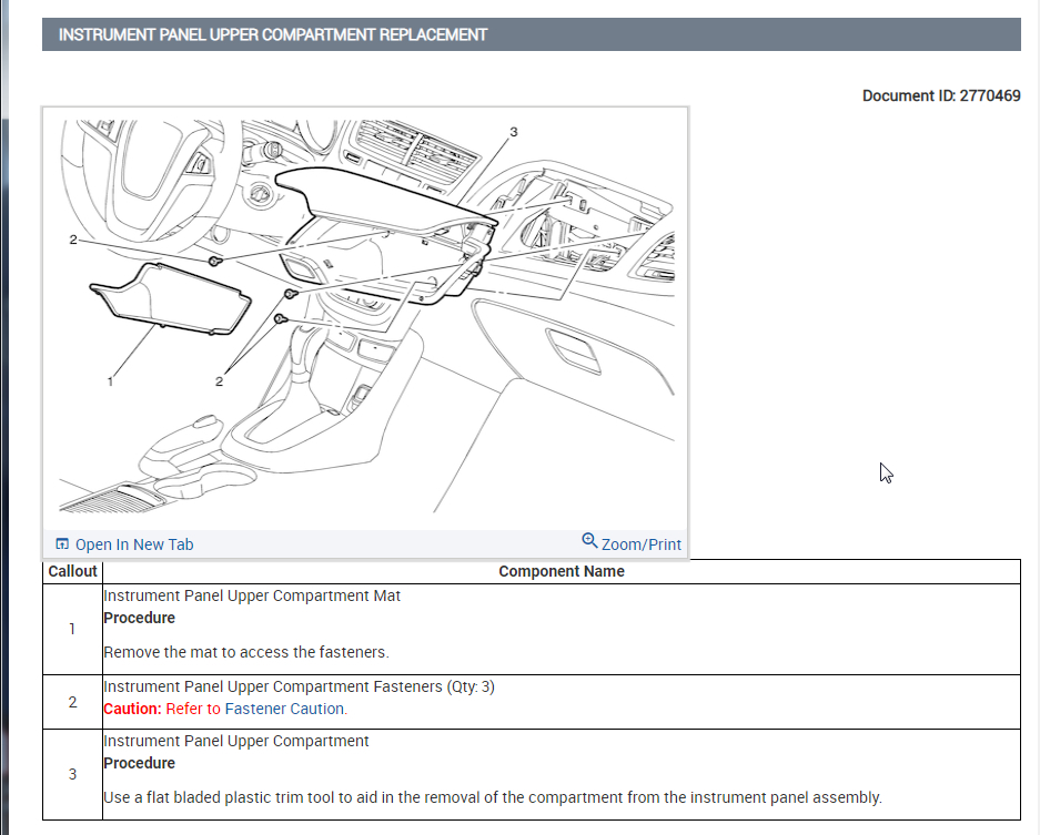

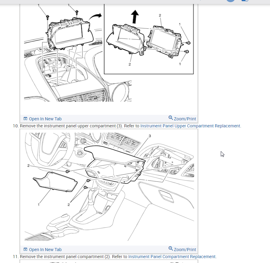

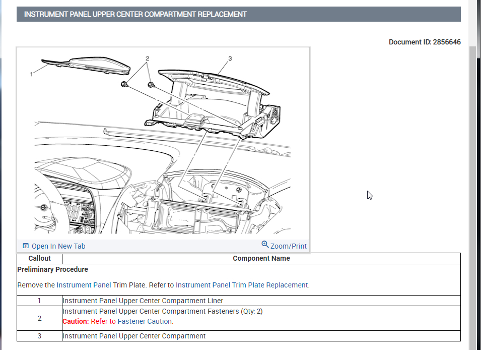

Need to know how to remove glove box door for a replacement. This is the upper box on the dashboard.

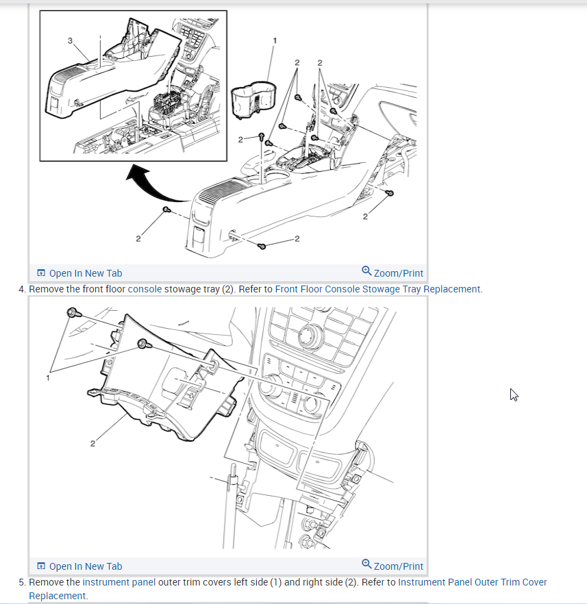

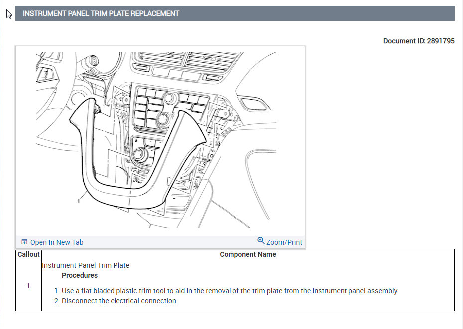

I am attaching the info from the manual on the upper unit on the dashboard.
Let us know if you need other info. Thanks
Feb 10, 2021 at 2:52 PM

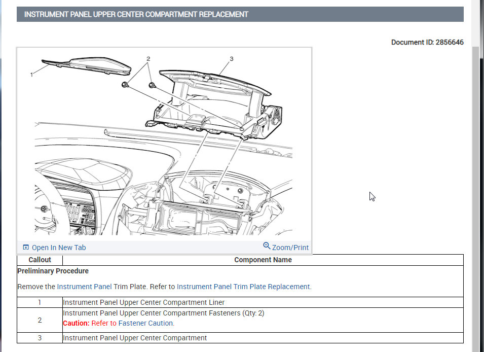

Thanks KaseKenny1. It appears the diagrams are not related to the passenger side upper compartment. This compartment is directly above the lower glove box on the 2015 Buick Encore. Might there be a similar diagram for the upper compartment?
Many Thanks
Feb 10, 2021 at 3:37 PM

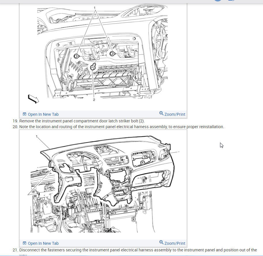

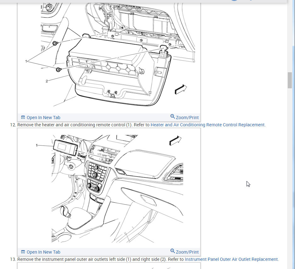

I am sorry. I mistook the upper compartment with the upper "center" compartment. Not sure why they can't change the name slightly more.
Below is what you need. Thanks and sorry again.
Feb 10, 2021 at 7:01 PM

Outstanding! Many thanks for your help KaseKenny1.

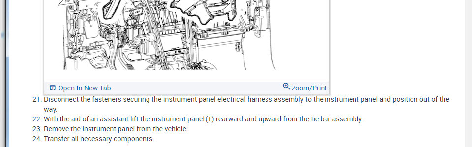

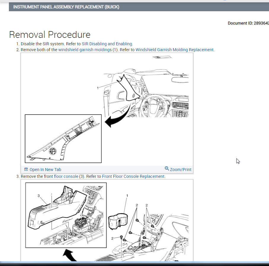

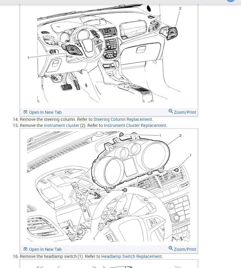

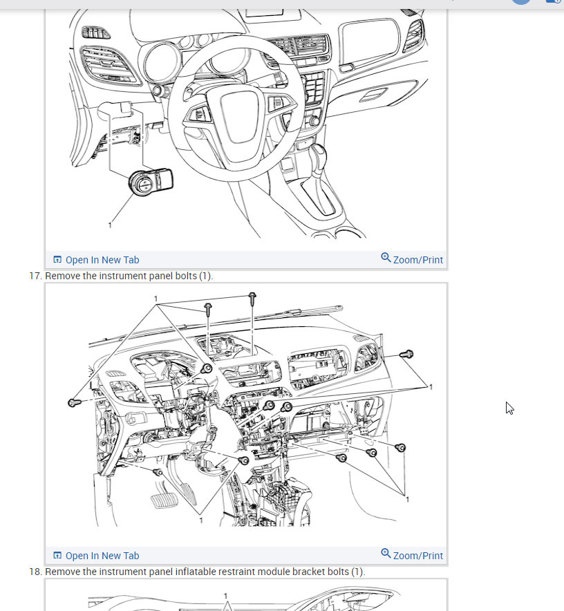

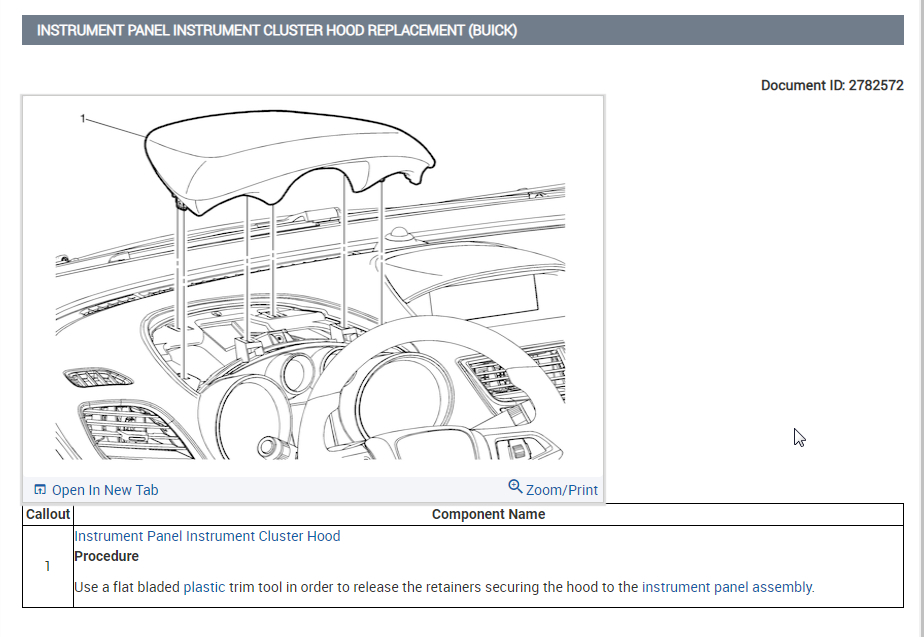

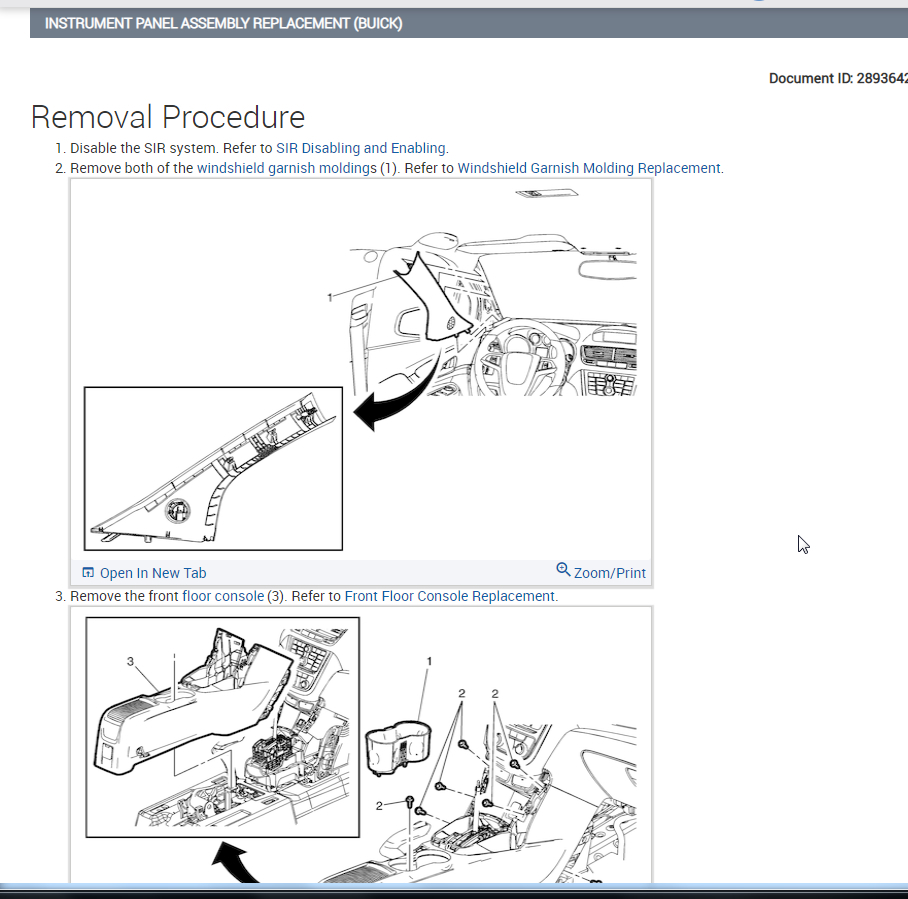

KaseKenny1, do you have a similar diagram that will explain how to remove the upper dashboard? If so, do you have any idea how difficult this task would be?
Thank you so much.
Feb 11, 2021 at 10:45 AM

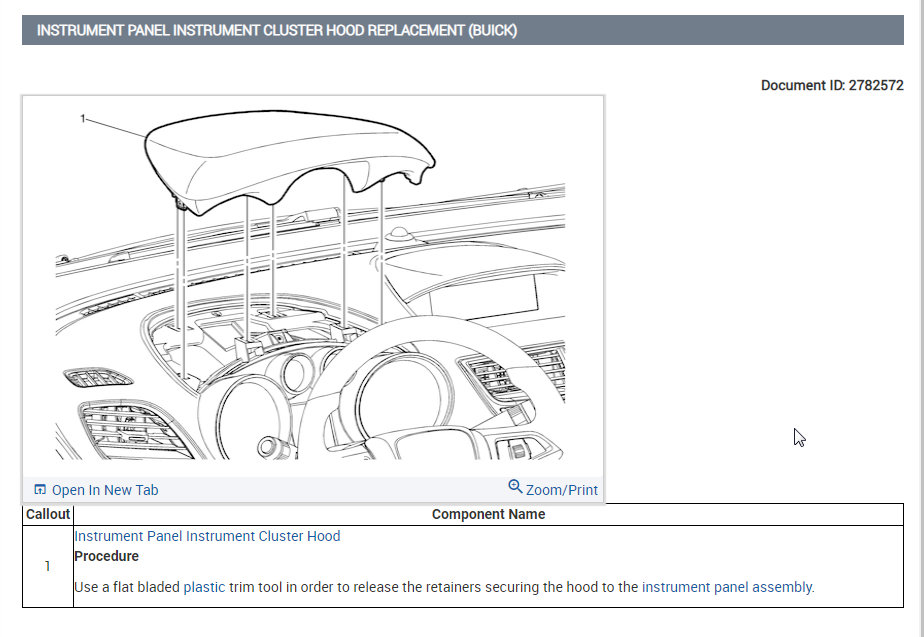

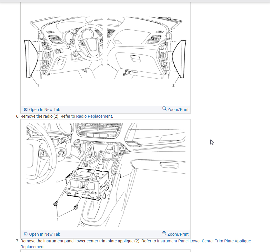

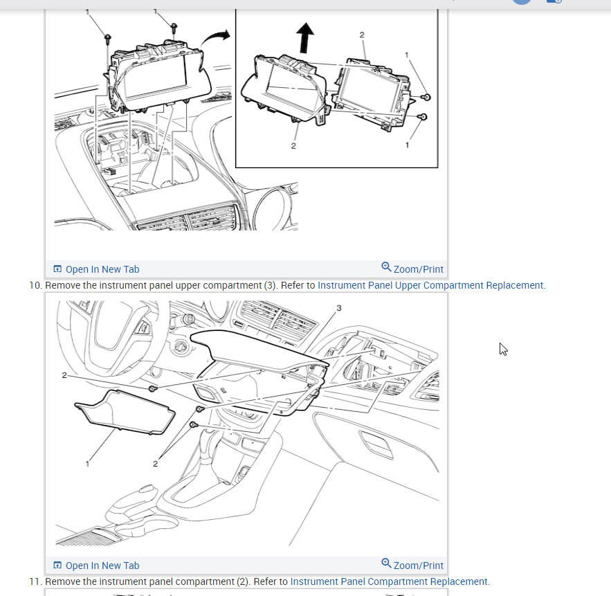

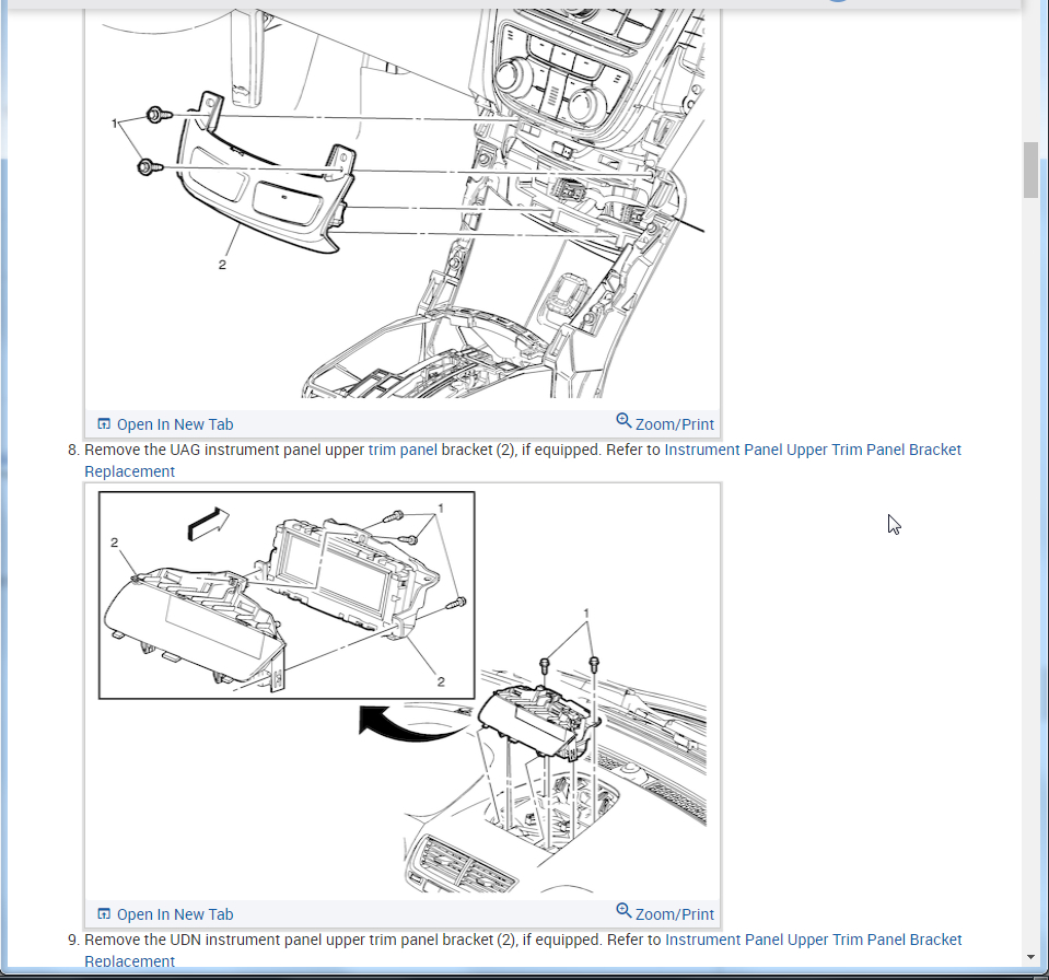

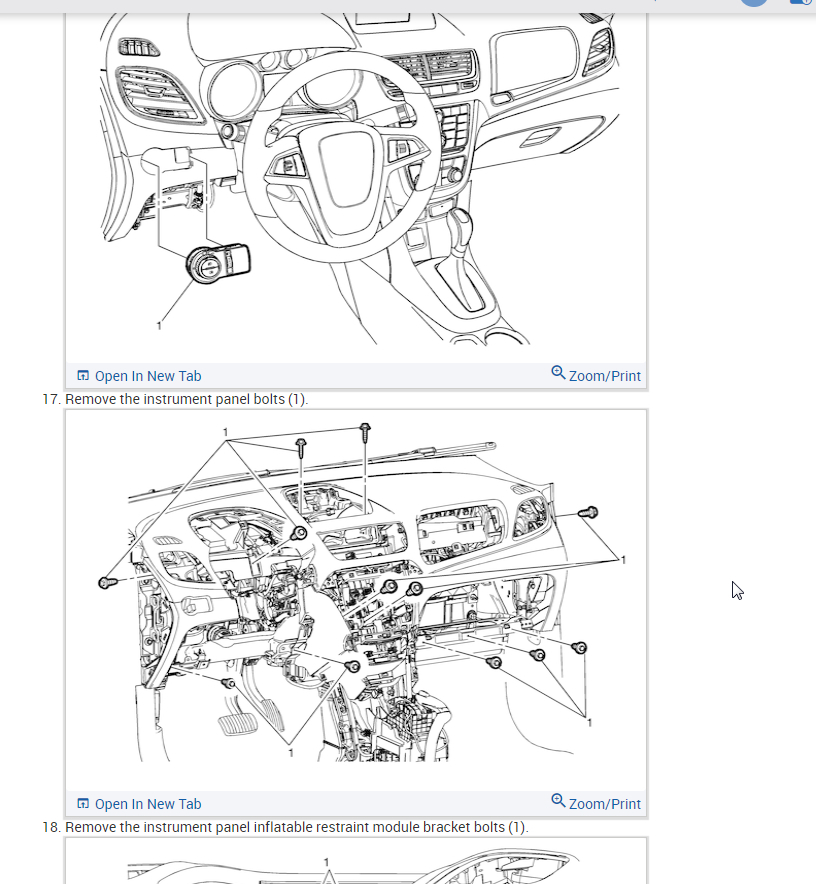

Do you mean the dome over the cluster or the entire dash panel? I attached the process for both below.
Let me know if you need something different. Thanks
