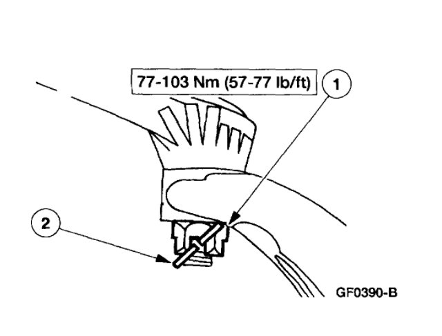

Is it possible that on a replacement the left and right control arms could be switched by mistake?
2021 FORD EXPEDITION
87,000 MILES • 4.6L • V8 • 2WD • AUTOMATIC
GORPYGORDON
Also how important is the ball joint torque for the upper? I understand for this model it should be 57 foot pounds. Is this correct?
Thank you

Sorry, my engine is not a turbo and it has clearly marked on the air filter (Painted) 4.6 Liter and it is a V8 Thank you for your help. Mine is a 2001 Expedition (my mistake maybe).

To answer your questions no, upper control arms cannot be installed on the wrong sides. They physically would not fit due to design. Yes, the ball joint torque is important to provide structural integrity. Yes, the proper torque is 57-77 lb-ft or 77-103 NM. I've attached the specification picture below. Hope this helps and thanks again for using 2CarPros.
