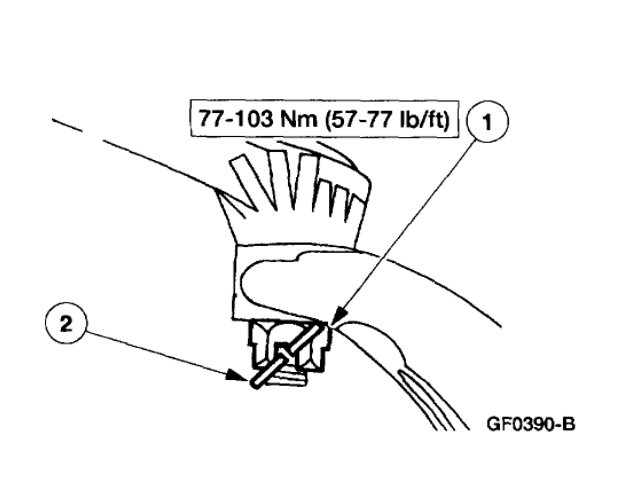

Is it possible that on a replacement the left and right control arms could be switched by mistake?

Also how important is the ball joint torque for the upper? I understand for this model it should be 57 foot pounds. Is this correct?

To answer your questions no, upper control arms cannot be installed on the wrong sides. They physically would not fit due to design. Yes, the ball joint torque is important to provide structural integrity. Yes, the proper torque is 57-77 lb-ft or 77-103 NM. I've attached the specification picture below. Hope this helps and thanks again for using 2CarPros.
