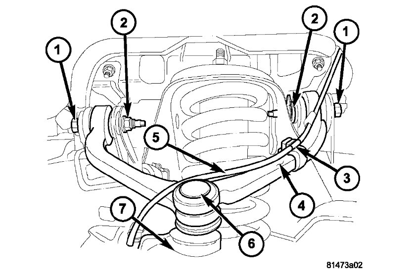

Is there a certain way or pieces to align to put control arm back on?
Jul 18, 2018 at 5:21 PM
Good morning.
Procedure below for you to view. an alignment is required after replacement.

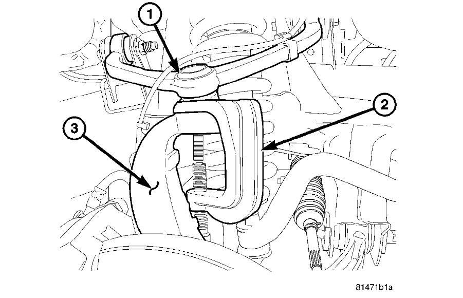

3. Remove the nut from upper ball joint.
imageZoom/Print
4. Separate upper ball joint (1) from the steering knuckle (3) with puller 8677 (2).
CAUTION: When installing puller 8677 (2) to separate the ball joint, be careful not to damage the ball joint seal.
imageZoom/Print
5. Remove the wheel speed sensor wire (5) from the retaining brackets (3) to the upper control arm (4).
6. Remove the control arm pivot bolts (1) and nuts (2) and remove control arm (4).

imageZoom/Print
1. Position the control arm (4) into the frame brackets. Install bolts (1) and nuts (2). Tighten to 176 Nm (130 ft. lbs.).
2. Reposition the wheel speed wire (5) into the retaining brackets (3).
3. Insert ball joint (6) in steering knuckle (7) and tighten ball joint nut to 95 Nm (70 ft. lbs.).
4. Install the wheel and tire assembly,.
5. Remove the support and lower vehicle.
6. Perform a wheel alignment.

Why is a alignment needed not even messing with tie rod ends or rack pinion. What size tools are needed do I have to have ball joint seperater?

Since you are replacing the arm, the caster or camber may have changed from the new component being replaced. The tie rods only do toe in not caster camber.
It does not list sizes of wrenches for the job.
As I remember, 15/16 is one for the attaching bolts to the frame and 3/4 or 7/8 for the ball joint nut.
