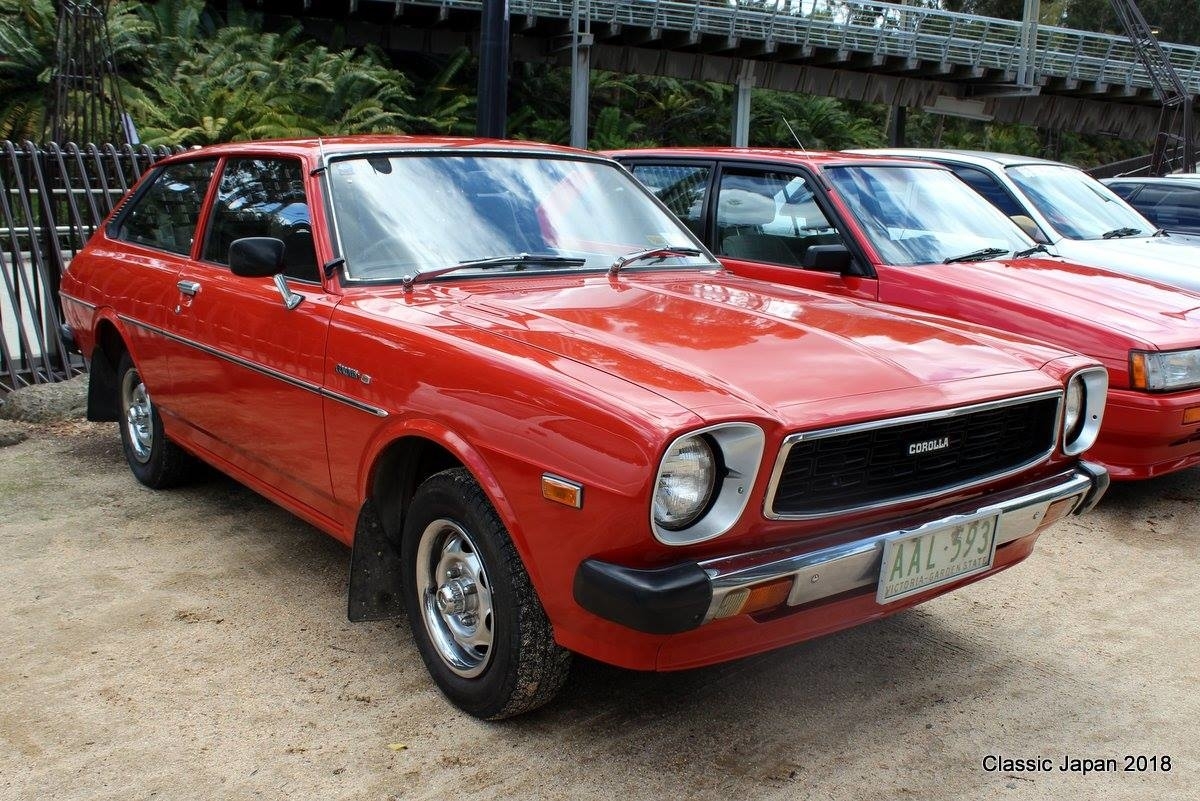

Here she is, over 41 years old, and I've owned her for over 30. I call her the Little Red Rocket. :)

I love it! Wow, I can't believe what great shape it is in (or should I say what great shape She is in). I live in PA (United States) and nothing here lasts more than ten years without major rust issues. It is a pleasure to see your car in such great condition. I understand why it's important to you. I assume you are in the UK based on you using the term Bonnet. Is that correct?

Hi, I'm in Australia, and yes, rust was becoming an issue. so after over thirty years of custodianship I gave her a well-earned 'spa treatment'. She deserved it! This shot was taken at the Classic Japan display in December. Over 500 cars over 25 yo on display, yet she was the only one of her model! A rare gem indeed, which is why I want to keep her going for as long as possible, as long as she's reliable, and it's safe to do so. Thanks for your enthusiasm and 'paying it forward'. :)
