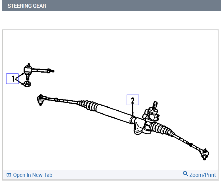

Drivers side wheel feels wobbly/unstable when going over uneven road at 60/70 MPH. I also Hear a clunk/thump when turning and there’s a clunk when shifting into reverse. All this sounds/feels like the driver's side. I think it’s my axle, but the shop says it looks fine. I still think that’s what could be wrong. What do you think it could be? I have Mostly all new suspension parts just not tire rods which they said looked good also. New tires as well.

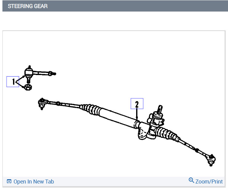

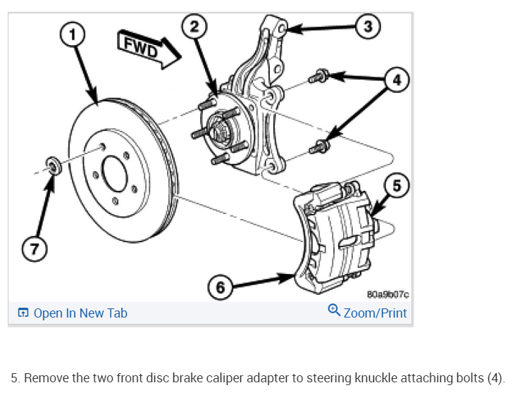

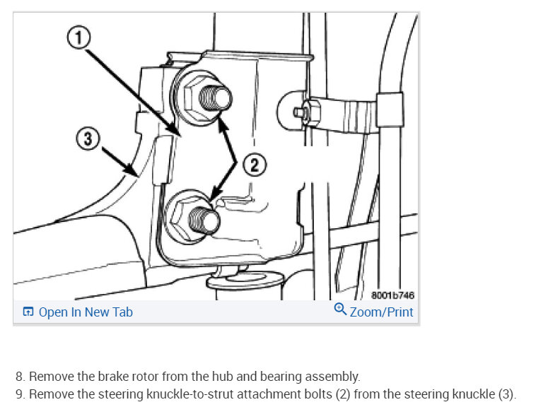

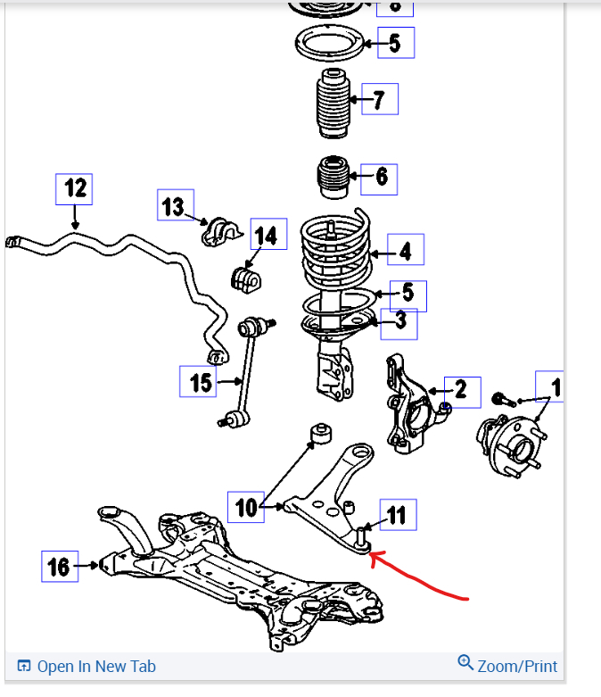

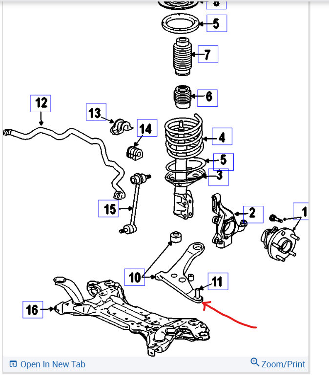

The first thing I would say is tie rods, did they check the inner tie rods? These can wear as well and cause the problem you are describing. I have also seen the lower control arm bushing or ball joint do out as well. can I ask if the car has new struts? This guide may help and i have included images below so we can be on the same page:

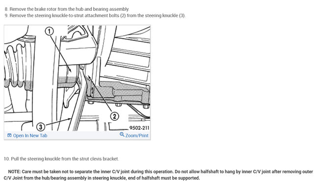

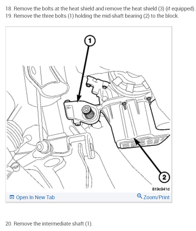

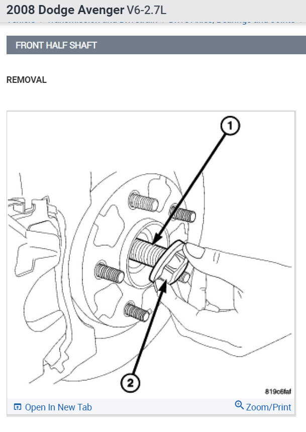

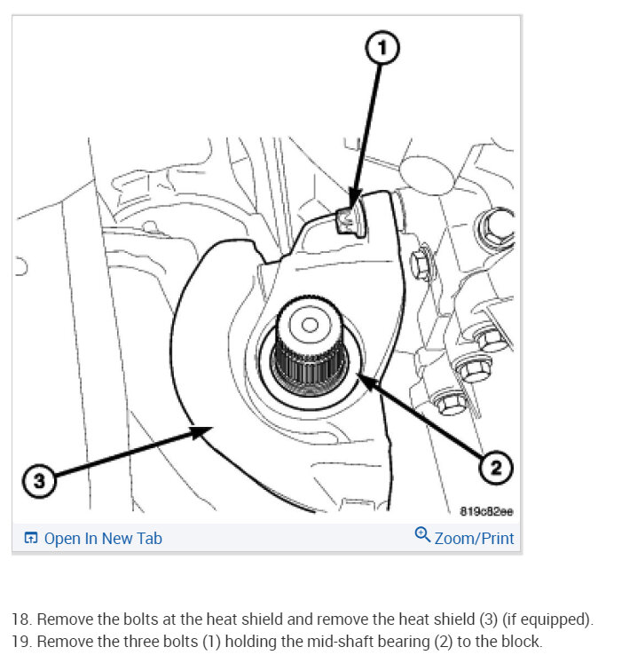

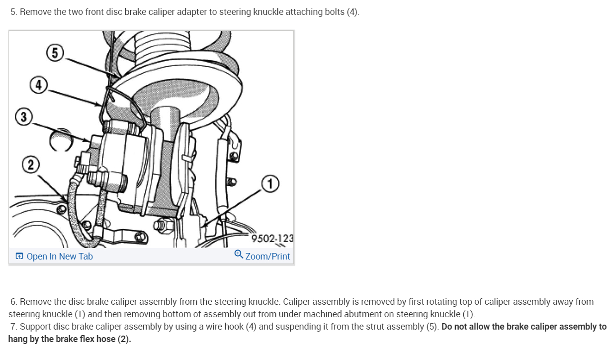

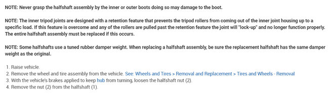

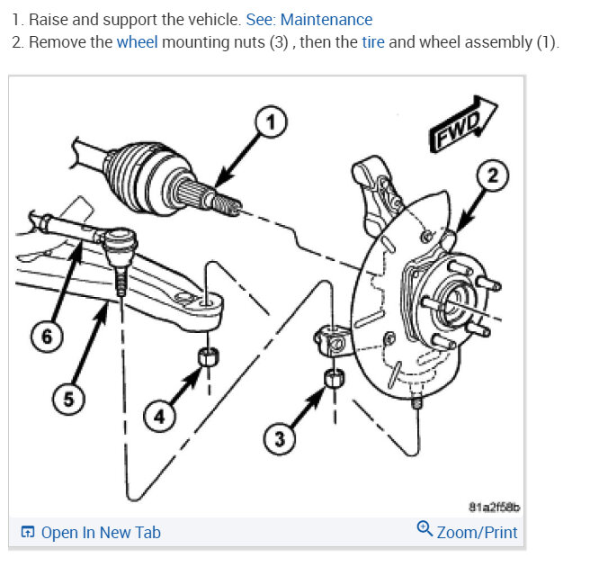

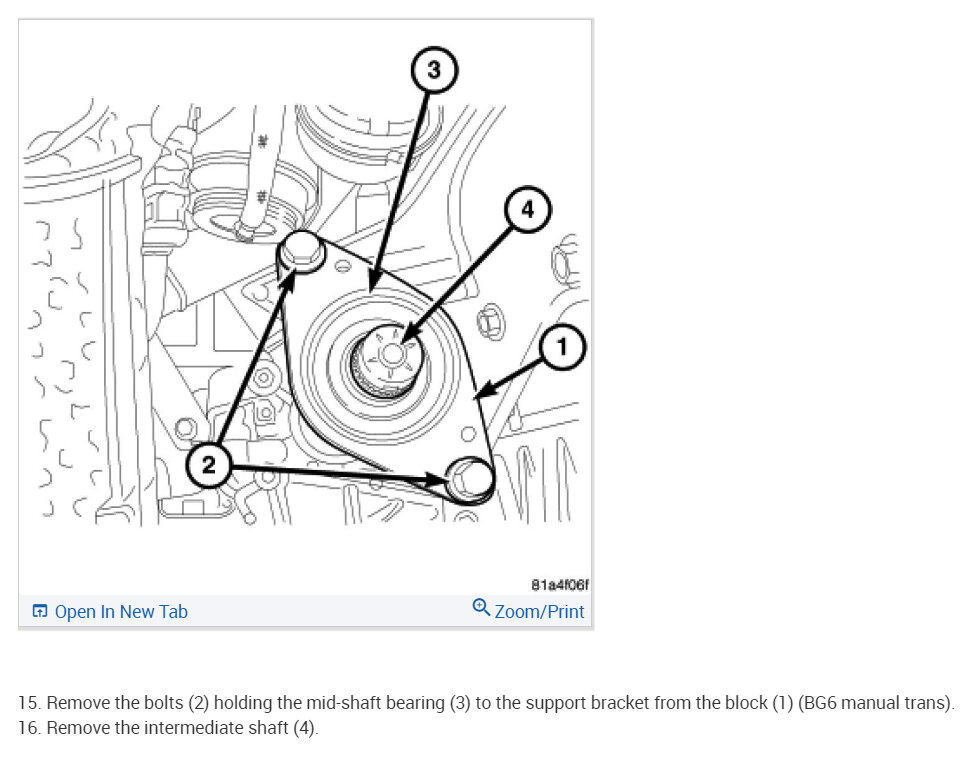

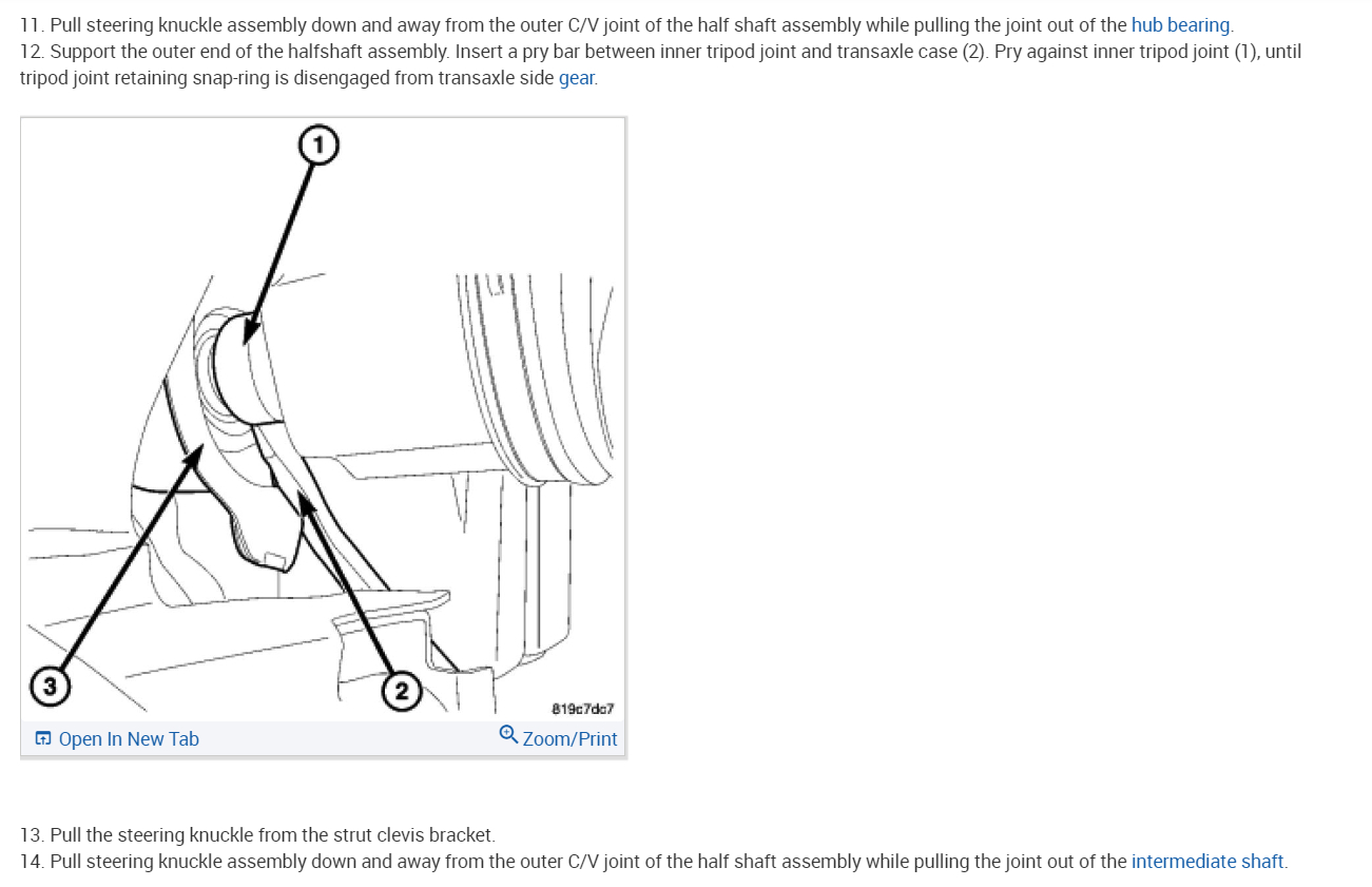

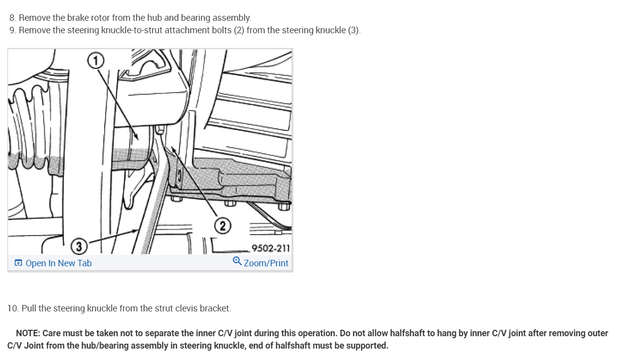

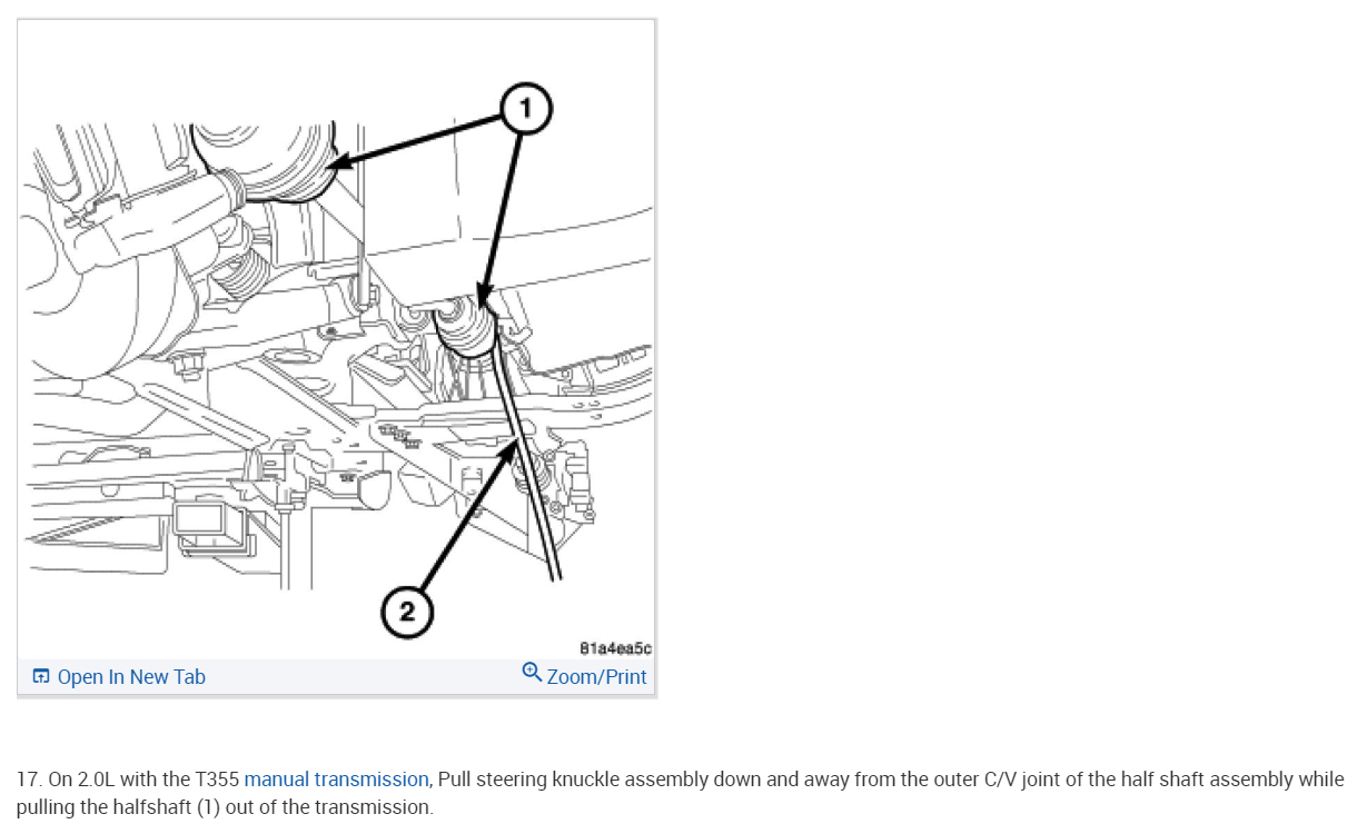

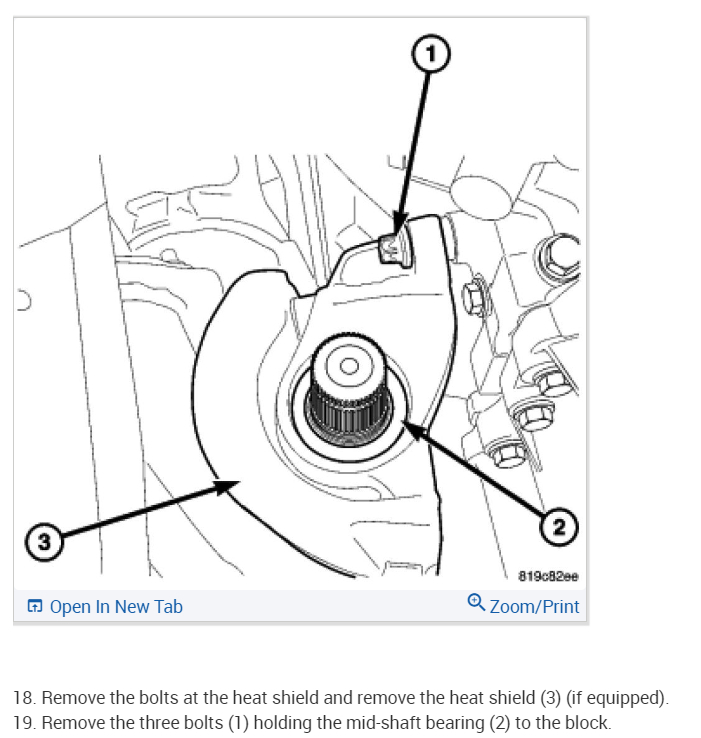

Yep, I need to agree with you I think the CV axle is bad which can cause this problem. I would replace both sides. Here are the instructions on how to do the job. Check out the images (below). Please let us know how it goes.
Oct 26, 2023 at 4:31 AM
