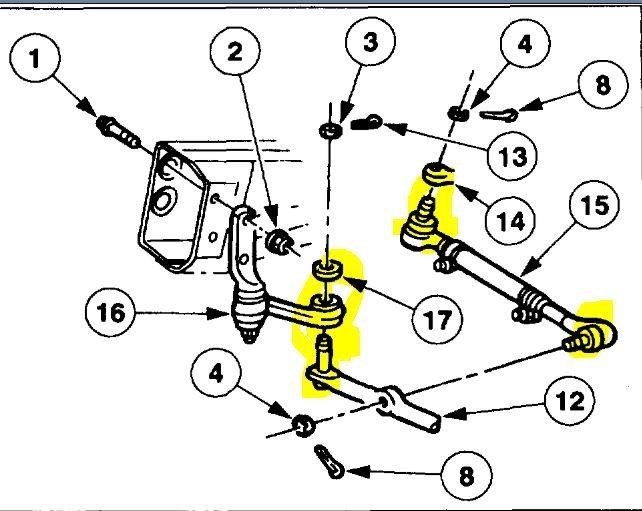

Driving down the road steering tends to wander left or right and very hard to gain control.

Most likely, you have worn steering components. Things such as worn tie rods, ball joints, a sector shaft, drag link and so on cause excessive play in the steering. These components can break and cause a loss of steering, so it needs checked.
If you can, lift one side of the front end at a time. Safely support it. Place your hands at 3 and 9 o'clock and see if you can wiggle the wheel back and forth. If you can, have a helper do the same thing as you watch under the vehicle for loose components. Do the same by placing your hands at 6 and 12 o'clock.

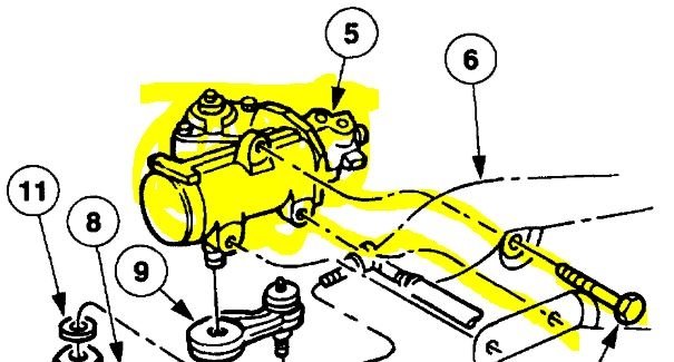

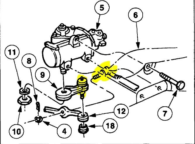

If you look at pic 1, I highlighted the sector shaft and the drag link joints. Check them for play. Pic 2 shows the idler arm and a tie rod. Note that there are tie rods on both sides of the vehicle. All need checked.
If everything is tight, confirm the power steering gear is tight. Pic 3 shows the gear. Make sure the bolts are tight.
