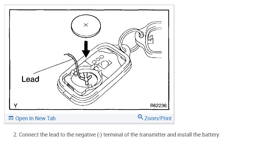

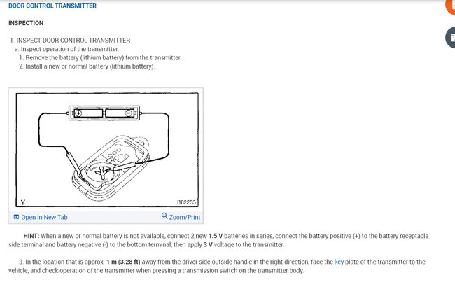

It sounds like the buttons on your remote are bad, but we should run a CAN scan to see what comes up, you can get a CAN scanner from Amazon for about $30.00.

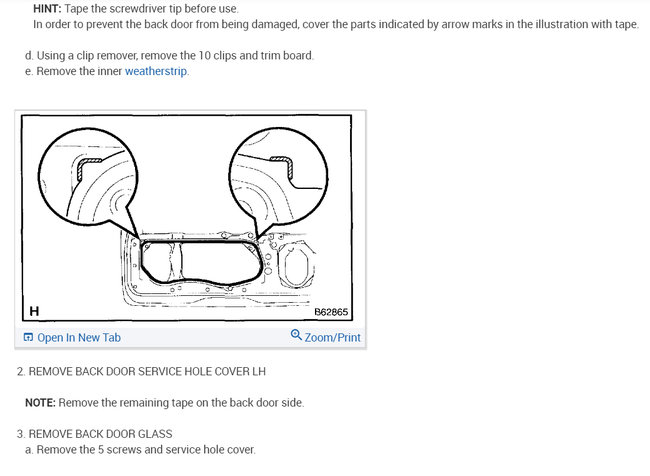

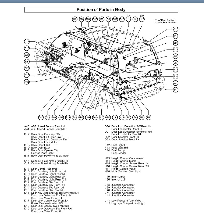

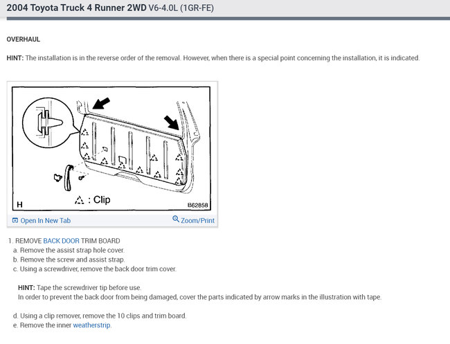

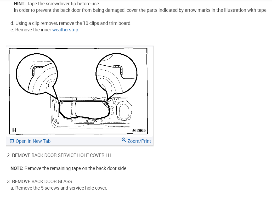

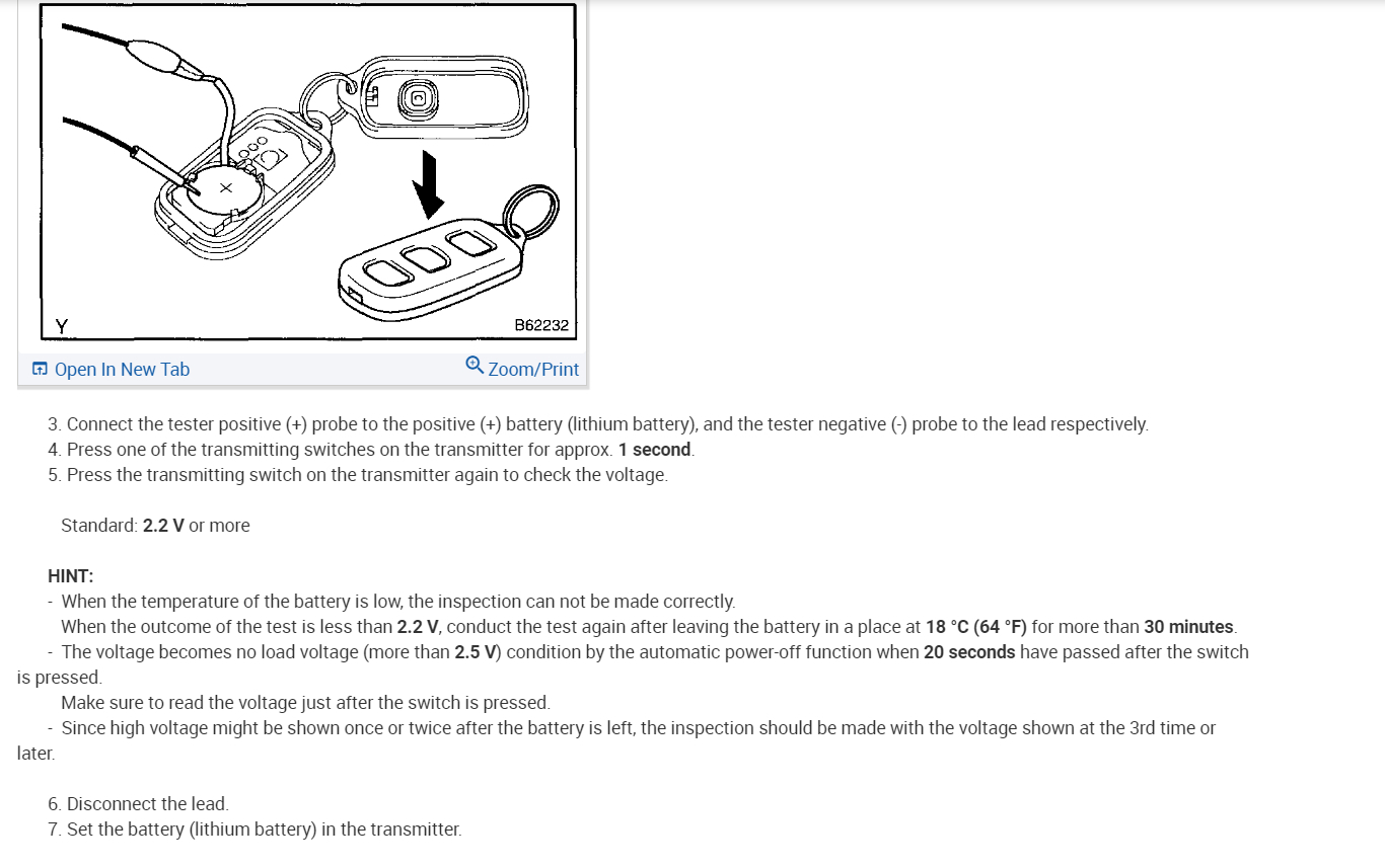

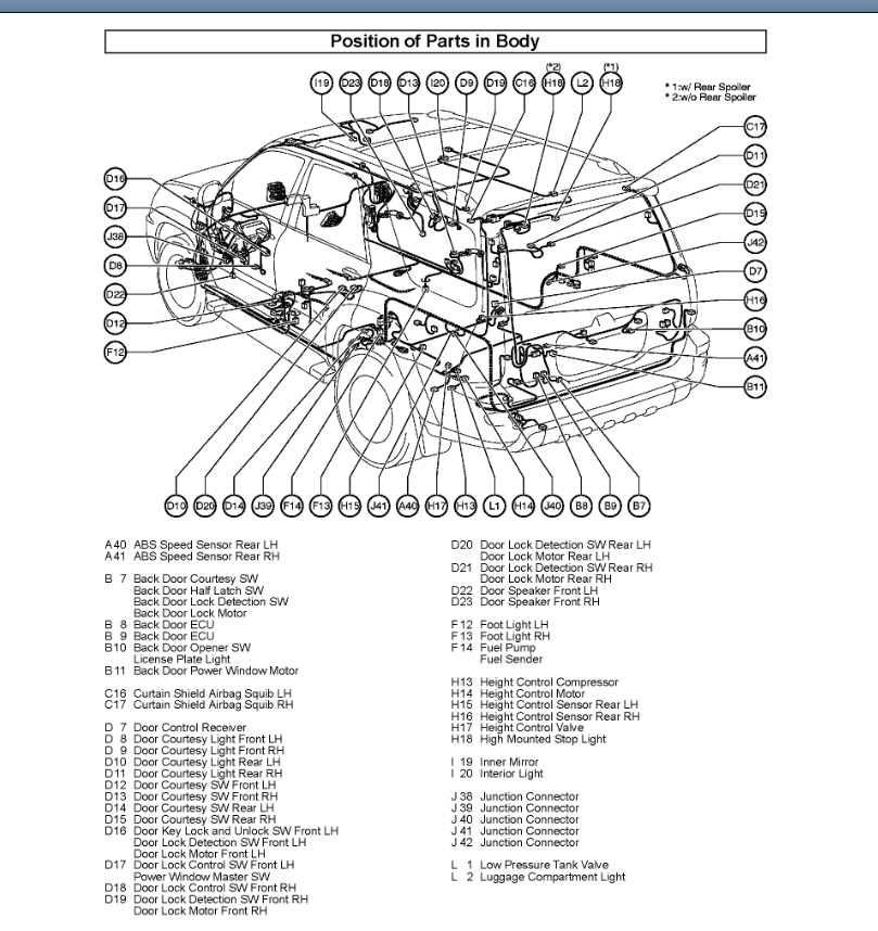

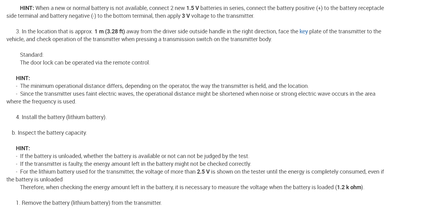

It sounds like the liftback latch actuator is bad, here is how you can replace it. Check out the diagrams (below). Please let us know what you find.
