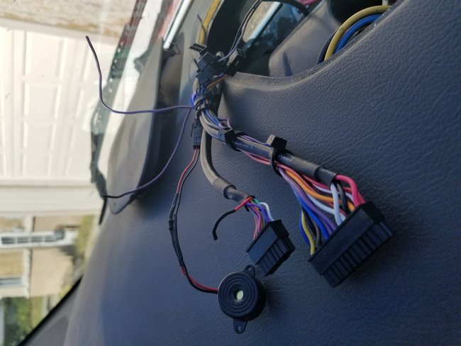

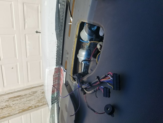

I just noticed I have a removable panel on the top of my dash by the windshield, upon further investigation I found a wiring harness disconnected inside. Does anyone have an idea as to the purpose of this harness?

Do you have a little history on this van? Have you owned it since new? If not, do you know if it was used as a business vehicle prior to you owning it?
The reason I ask is, this does not appear to be a factory harness. The loose wires that are hanging off it is not done by the factory because they don't build a vehicle with extra wiring like this. Also, the lack of friction tape or wrapping for the harness is not factory. Basically, they wrap the harness in black tape or other protective coverings to protect it from rub through.
What I suspect this is, was an addition to the van by a previous owner for a tracking device or other module that was needed for their business.
Let me know if this history matches up with my suspicions.

The van was originally owned by Charter Communications.

Okay. If this was owned by a charter company, I can almost guarantee that this was a tracking device or some other component that they use for their business. If it is bothering you, you can track the wires and remove them then repair any splices that they made. Otherwise, you can leave it alone. It should not bother anything if nothing is connected to it.
Let me know if you have more questions. Thanks
