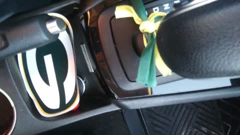

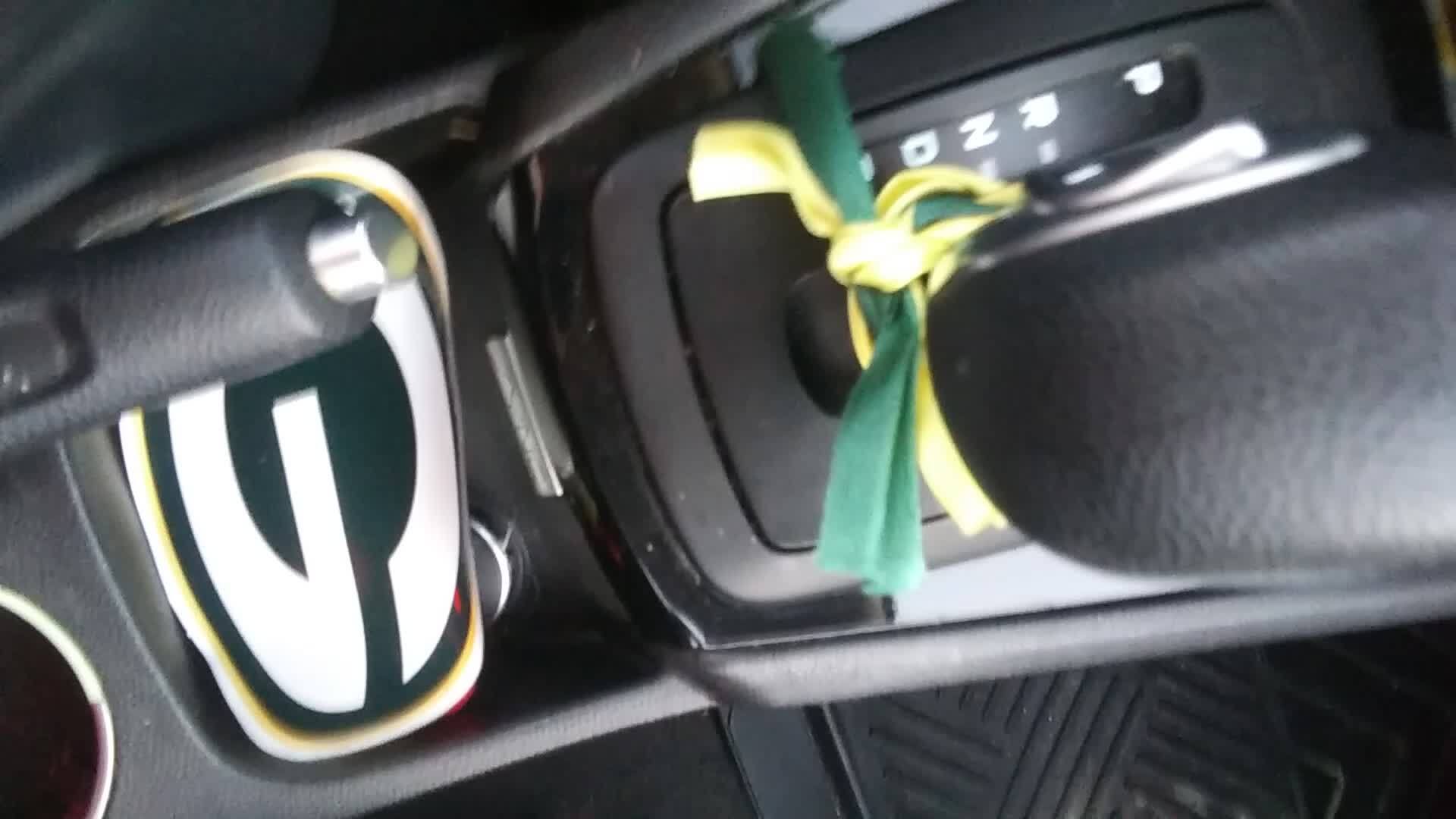

Thanks. I think it may be transmission related. It's a DPS6. Car has 91,000 miles.
Ticking pauses slightly when gears shift up but not down and no ticking when at idle or coasting.
Could it be just a noisy transmission?
Plus, it is very faint.
I'll attach a video.
Oct 26, 2022 at 4:39 PM
ZEBRASOT
  • 16 POSTS
Video attached.
Oct 26, 2022 at 5:41 PM
  • 110,194 POSTS
I'm so sorry, but I can't hear a ticking. If it's faint, it may have been lost in the transfer of info. Are you able to hear it on the device you used to record it?
