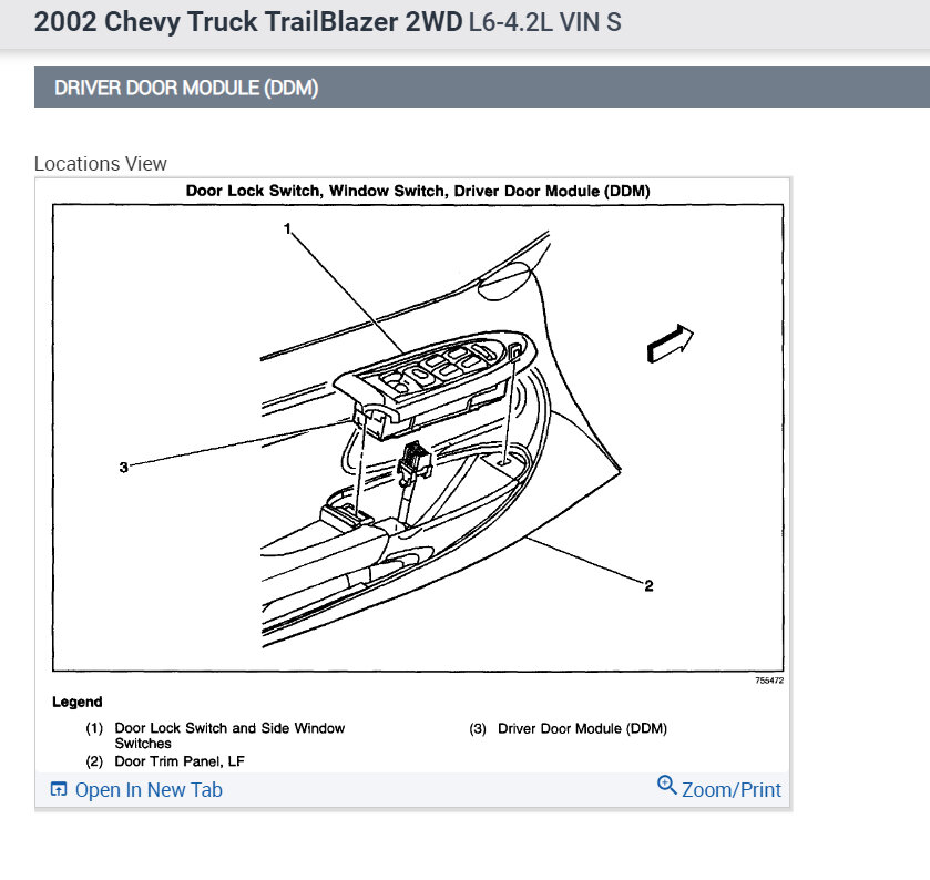

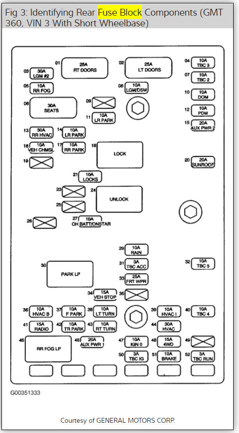

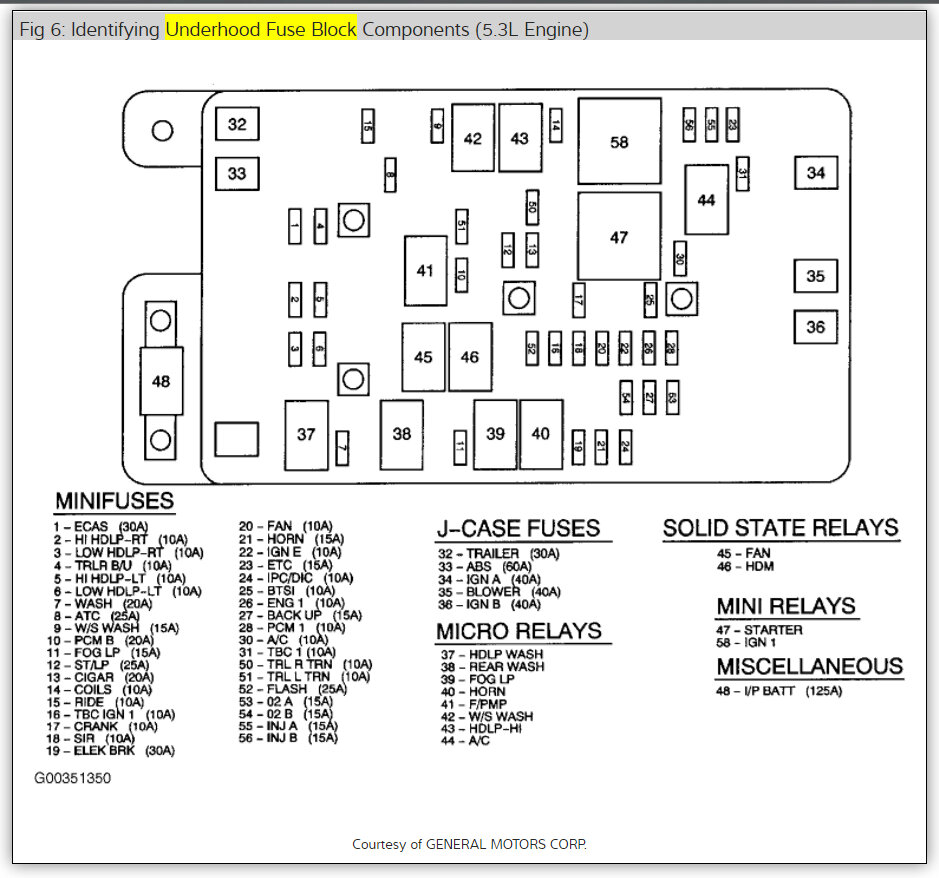

I have the vehicle listed above that has been immobile for almost a year now. It started saying unknown driver after the battery drained one day. I had to take the back of the steering wheel column off to push the button to release the key when I turn the key it does not crank and doesn’t start, and I’ve been noticing a buzzing sound sort of like a radio out of tune noise coming from somewhere I can’t really pinpoint where. Sounded as if it was coming from the door panel but I’m not sure thought maybe it could be the relay. The only way to get it to crank but not start is from a wire straight to the starter touching the positive side of battery.

This happens when the driver door module (DDM) goes out or the system needs to be reset, here is the location and how to replace it in the images below. and the instructions on how to reset the system.
Try to start the engine, then leave the key on. Watch the security light until it stops flashing (about 10 minutes) then turn the ignition switch from off to crank, turn off the ignition, and wait about 5 seconds. Do this a few more times until the message stops. The system will be reset.
Check out the images (below). Let us know what happens and please upload pictures or videos of the problem.

I’ve tried to do that reset several times with no change because i thought it would help but what is weird is that the security system light is not on at all! But it does crank from the starter but there’s no gas getting to the motor because the security system I guess the security system has stopped the fuel to the motor.

Okay, it sounds like the DDM is out or the battery is low on charge, but we should check the security system fuses TBC1 (under hood fuse panel) and Fuse IGN0 in the rear fuse block under the rear seat before we go further.
Check the fuse for power with the key on.
