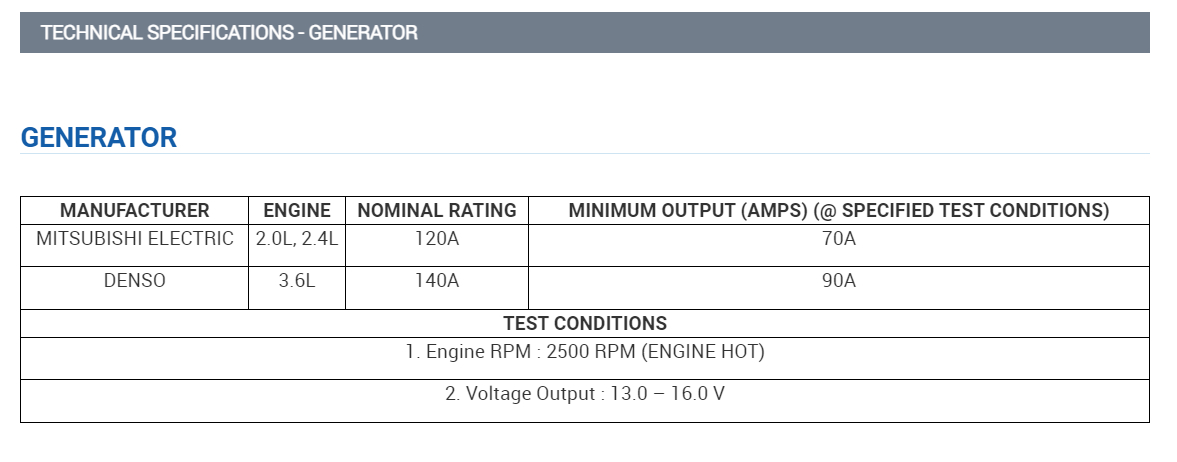

My vehicle needs a new alternator, however there are no markings on the casing, and there are two different amperage ratings available. My VIN number is 1C3CDFBB3ED745414.
Thank you

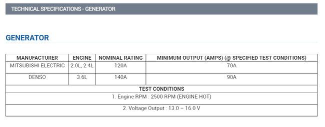

Hello, the 2.4liter engine takes the 70amp alternator. Here's the service info on your vehicle. Check out the images (below). Let us know if you need anything else.
