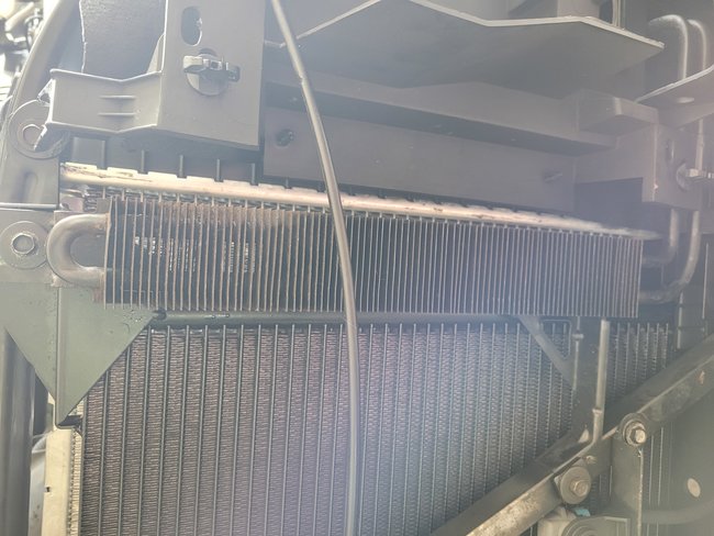

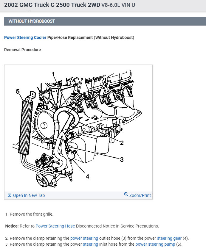

I am trying to identify the part on my condenser related to cooling something. Image is attached. Please identify this part, as I may have to replace it.

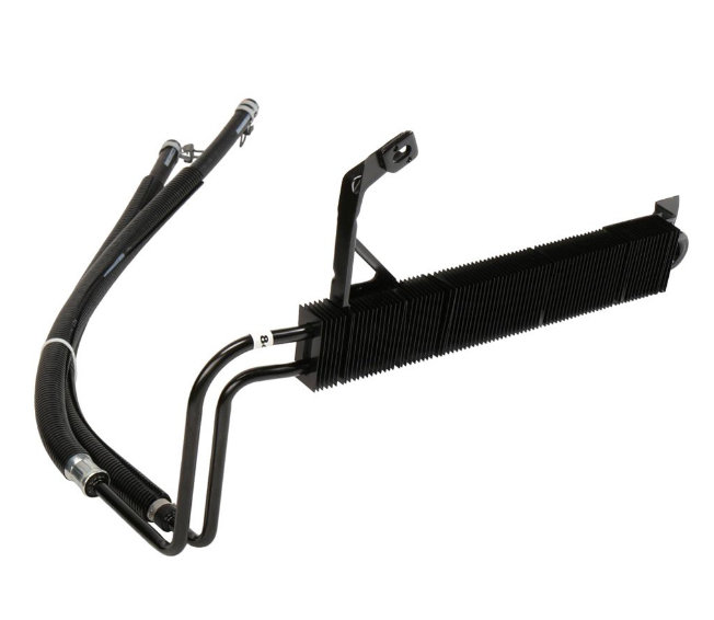

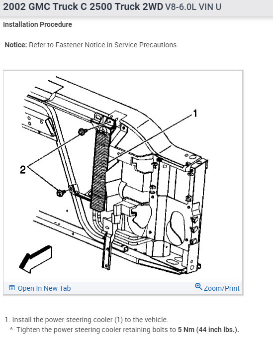

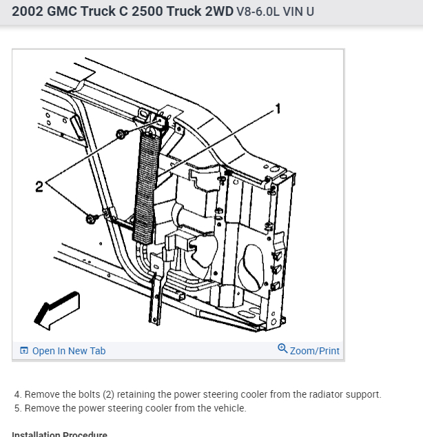

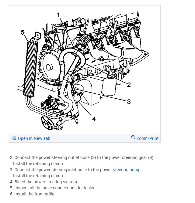

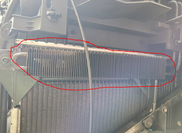

If you are talking about the vertical component, it is the cooler for the power steering fluid. I have circled the picture below.
Also attached is the replacement procedure for your reference.
Let me know of any questions.
