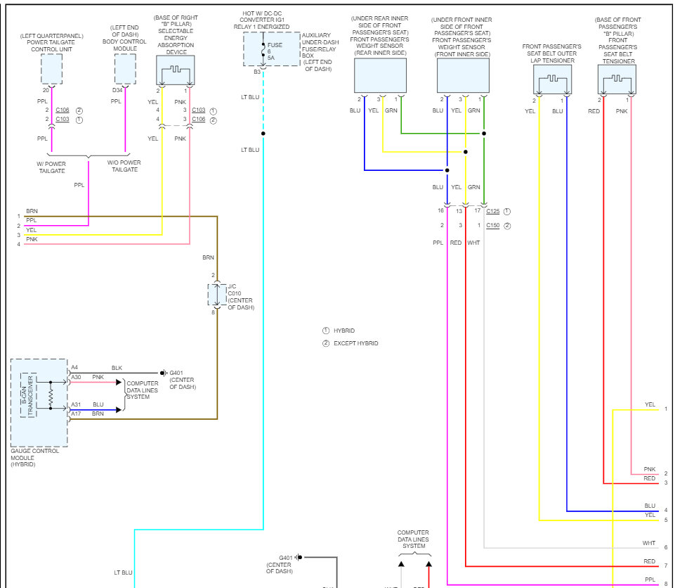

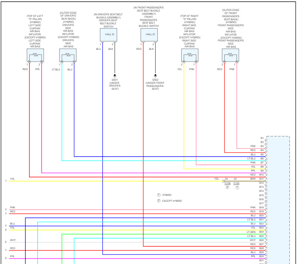

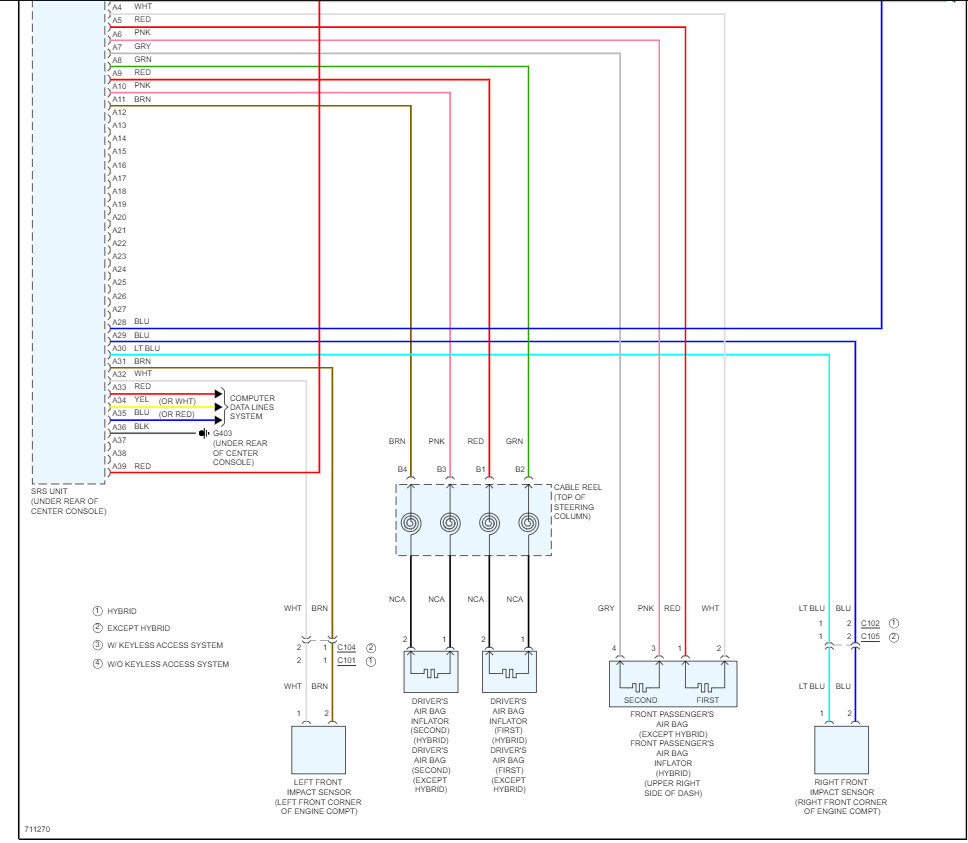

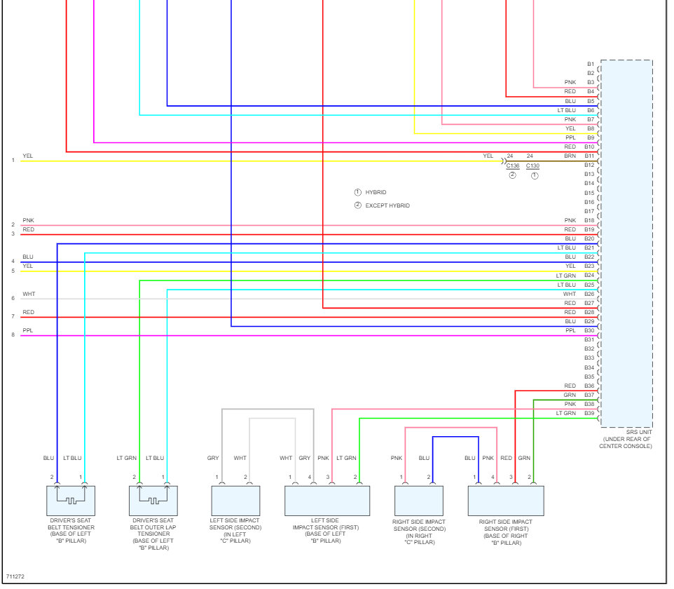

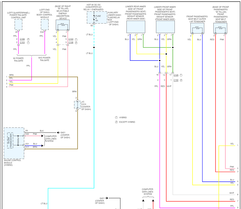

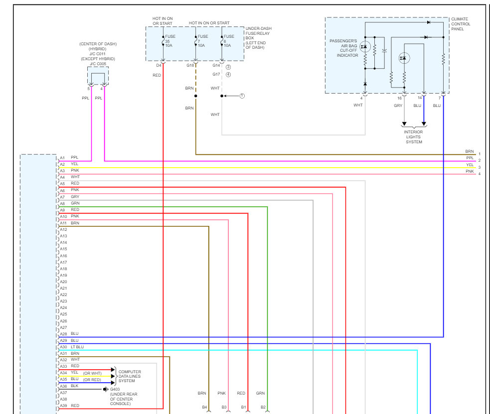

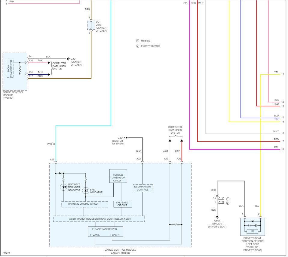

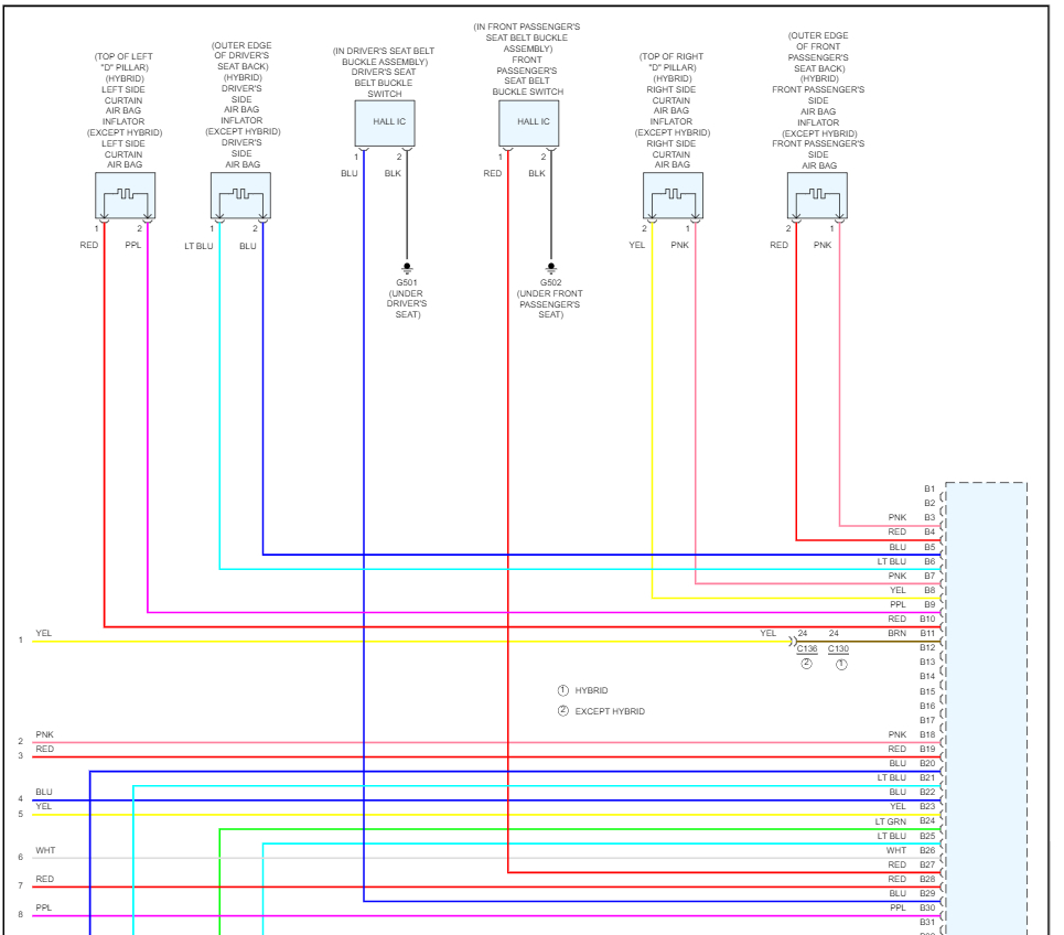

I accidentally unplugged the 2 wires with metal pieces on the ends that slide into the yellow airbag port under the passenger seat. The wires are not broken or damaged, but I can't figure out which way they go in.
May 14, 2023 at 3:21 AM
  • 55,423 POSTS
I would disconnect the battery before working on the airbag system. Can you please shoot a quick video with your phone so I can see what's going on? You can upload it here with your response. Here are the airbag wiring diagrams so you can see how the wires match up. Check out the images (below). Please let us know what happens.
