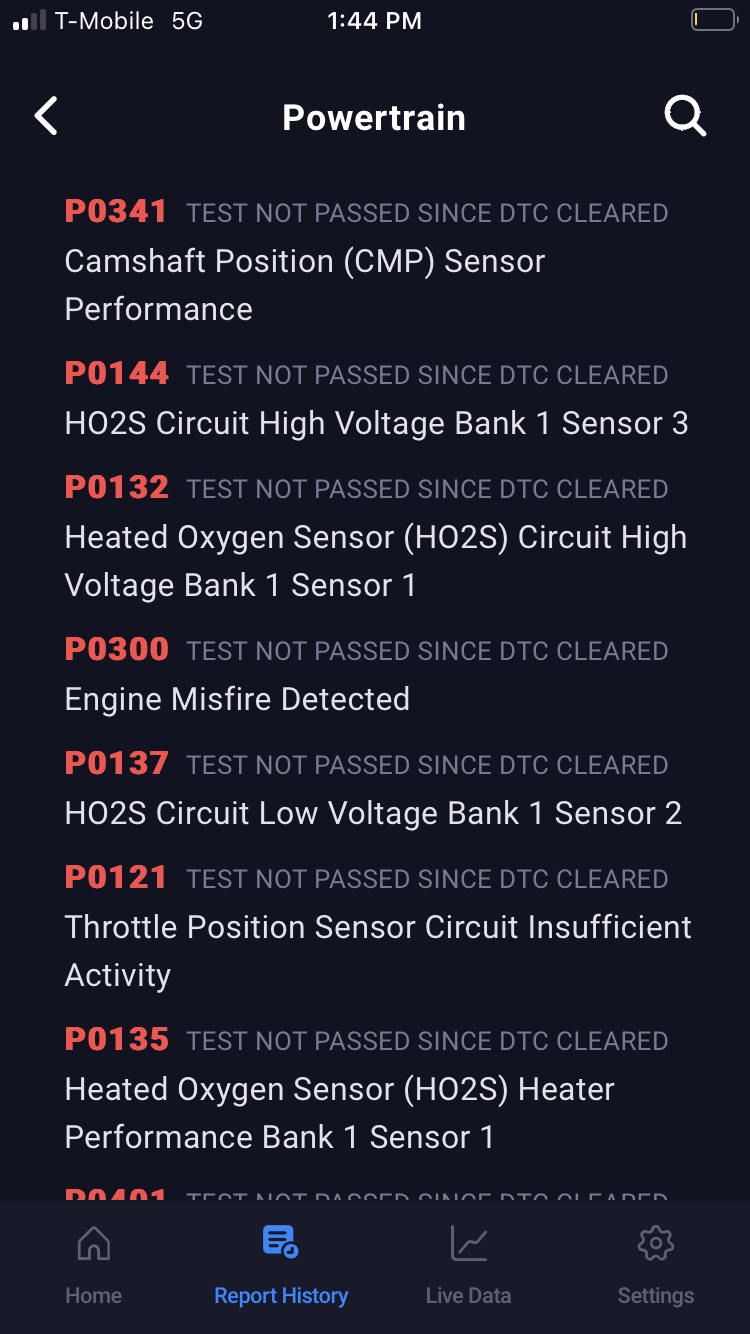

While idling at normal operating temperature, 197F. I unhooked MAF sensor harness and the engine stalled almost immediately. Now I cannot get it to start. Cranks but no start. Can smell gas after multiple attempts. Drained and filled gas tank with fresh gas. I tried starting with no air filter, also tried with gas pedal pressed to the floor. Checked fuses and seen no obviously blown ones. Tried a little starting fluid. Let it sit overnight and tried it. All with no change.
Have not checked spark yet.

My findings were.
No spark. Checked two plugs and two different wires.
I tested the ignition control module and it all looked good but couldn’t get a reading on and on/off signal from computer. Coil was replaced 30,000 miles ago with Napa brand.
Spark plug 1 was dry and number 3 possibly had some fuel on it.
No check engine codes but under Powertrain it shows all the sensors as incomplete or failed test.
Tuesday, August 22nd, 2023 AT 10:46 AM

Do me a favor. That is a large list. Record the numbers so you have them and then clear the codes.

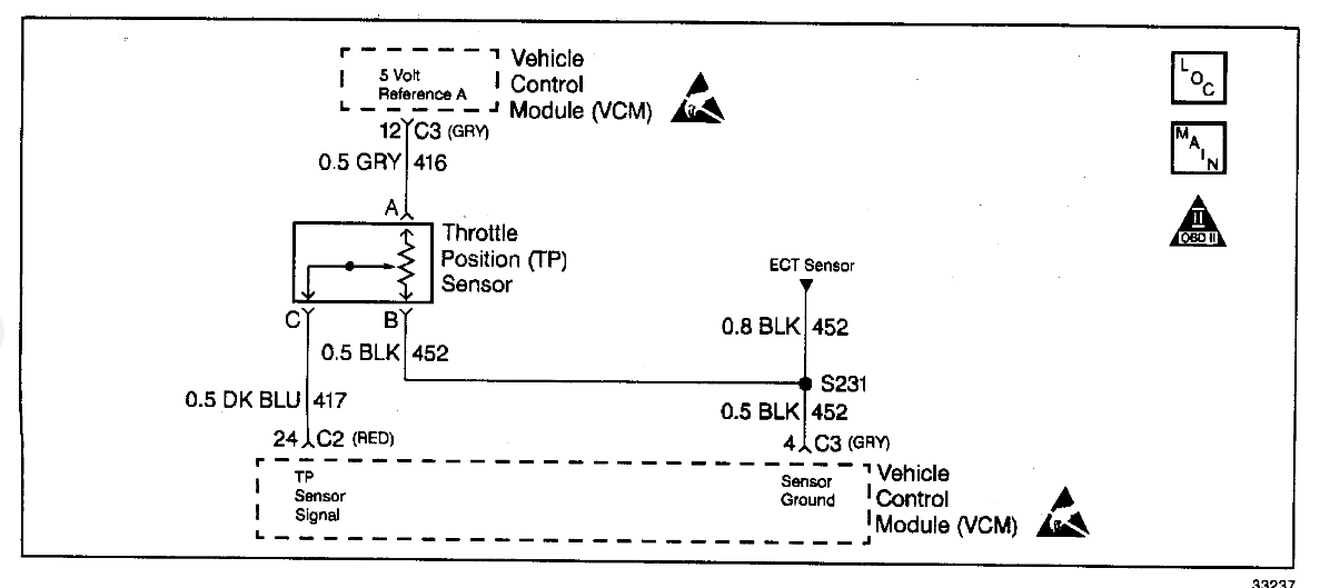

Once you do that, see what code or codes come back first. Looking at the list, I'm not seeing one thing that would prevent the engine from starting. Actually, the P0121 could, but that is questionable.

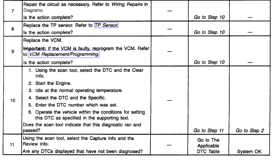

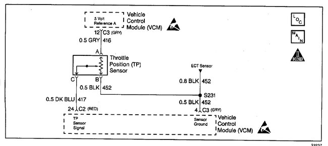

Do me a favor, I attached diagnostics below for the P0121. Take a look through them and let me know if you are comfortable performing them, if you decide to clear the codes, save any freezeframe data that is stored.
