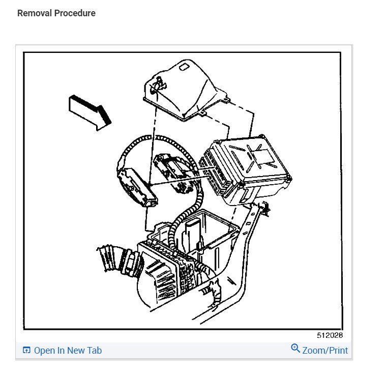

I recently bought this car to flip and make a little cash on it. Replaced the heads (used but known to be good), intake manifold, head gasket set, EGR valve, MAF sensor, fuel pressure regulator, CKP, harmonic balancer, plugs, wires, and coil packs. Currently it runs but has a general misfire dtc. I’m also getting dtc’s for the MAF sensor. When I start it, it will idle for less than 5 minutes and then stop running. It always starts right back up when I turn the key. I’m starting to think that I might have to consider that the PCM may be going bad. Thoughts?

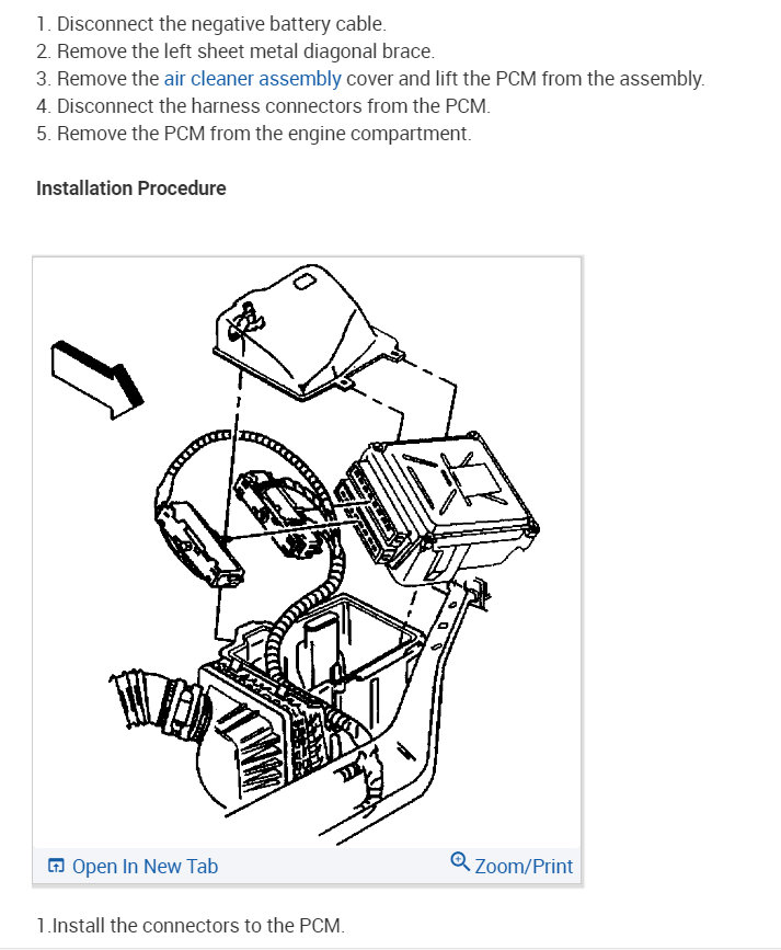

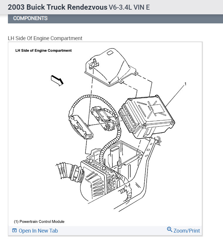

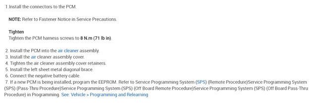

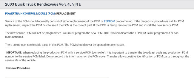

Yep, it could be bad, I would clear the codes, then turn the key on without cranking the engine over and then run the codes again, this will give us the most prominent code to address first. Also, you can try to reboot the system by touching the negative battery cable to the positive terminal for 2 minutes, this will discharge the capacitators in the system and allow a reboot. Let me know what happens. Here is how to change out the PCM in case you need it. You can get a preprogrammed unit online. Check out the diagrams (below). Please let us know what happens.
Jul 5, 2022 at 5:46 AM
