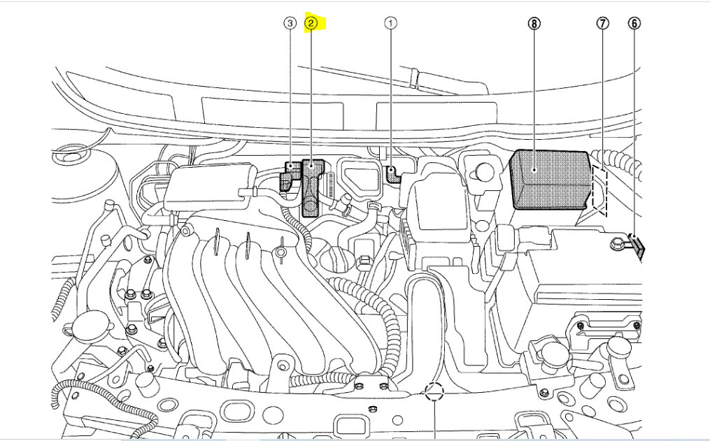

Hi, when I stop at the red lights and I have the air-conditioning on I notice that the tachometer rpm fluctuates between 500 RPMs and 1,000 RPMs, but the check engine light won't come on to give me any codes, it just idles unevenly with the air-conditioning on. Could it be the air-conditioning cycling pressure switch? the PCV valve? the charcoal canister or charcoal canister purge solenoid? I don't know which other sensors or solenoids to name as the possible culprits because I don't know much about cars, thank you in advance for your help. Alex Stathas

The first thing I'm going to recommend is to check the wiring and connector at the throttle control actuator. See pic 1 below.
The ECM controls the engine idle speed to a specified level through the fine adjustment of the air, which is let into the intake manifold by operating the electric throttle control actuator. When you run the A/C, there is an added load on the engine and the ECM needs to control the actuator to increase the idle speed to compensate for the added load.
In this case, the actuator may be failing, or you could simply have an engine vacuum leak. So, if the wiring appears to be in good condition, free of corrosion or dirt, and the connector is tight and not damaged, I would recommend checking for leaks. Here is a link that explains how it's done:
Let me know what you find.
See pic below.

Yes, I noticed the electronic throttle control actuator even before the rough idle with the air-conditioning on, the electronic throttle control actuator takes the place of the throttle cable in older cars, I am too scared to mess with the engine electronics because I am afraid of causing a no start condition and I can't take it to the repair shop because I am afraid they will charge me a small fortune. Also, I can't mess with the vacuum hoses because I am afraid of causing stalling. so, I will have to live with the rough idle and hope that the three-month interval bulk synthetic oil changes at Walmart will keep the engine from seizing up. Your reply was very informative though. thank you very much.

I understand your concerns. However, take a minute and just inspect the vacuum hoses. You may find one disconnected or cracked. Honestly, unless you disconnect many of them, you won't cause a no-start condition. The same with the actuator. Simply inspect the connector to make sure nothing appears damaged. If you want, you can take a few pictures and upload them for me to see. I will try my best to identify any possible issues and let you know.
