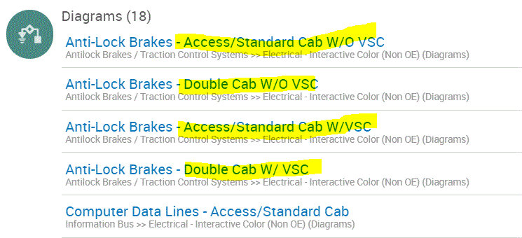

You know, I had another quick test for you to try. If you remove the ABS fuses from the vehicle, it will turn off the ABS. You will still have standard (non-abs) brakes. That would tell us if what you hear is coming from the ABS.
I thought it would be easy to identify the fuse, but as expected, it isn't. LOL I need to know if you have a crew cab, if the vehicle has stability control, if it is a regular cab, and so on. The fuses are all in different locations based on the vehicle.
If you look at the attached pic below, it identifies the options. If you want to try this, let me know which one you have and I'll be able to look up the correct information.
See pic below.

This is a 2006 Toyota Tundra Crew Cab SR5, 4.7L engine, 2WD, disk brakes on front, drum brakes on rear, no stability control.

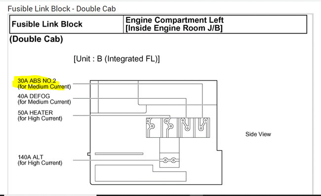

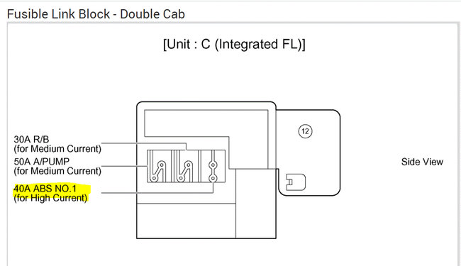

Well, I got the owner's manual out tonight to try to find the ABS fuse(s) and lo and behold, the fuse box diagram does not match what is actually under the hood. So I went to 3 different websites to try and track down the info and guess what? all three websites referenced different fuse numbers to control ABS. So at this point, I am very confused where to go next. One site even stated the ABS fuse also controlled the multiport fuel injection system. If that is correct? that does away the theory of driving with the ABS fuse uninstalled to run the test.
May 24, 2021 at 12:16 PM
  • 110,251 POSTS

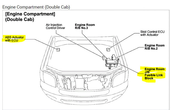

I found it, but it is a fusible link and not a traditional fuse. It is in the fusible link box under the hood. It won't be something that can easily be removed.

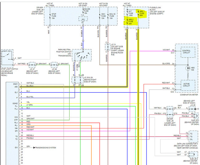

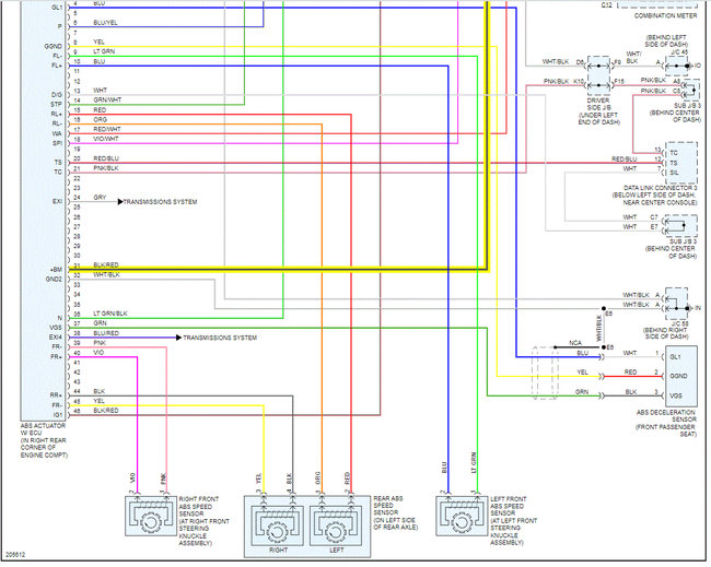

I attached the wiring schematic for this vehicle's ABS system. I highlighted the power supplies to the ABS and added the pics of the fusible link.

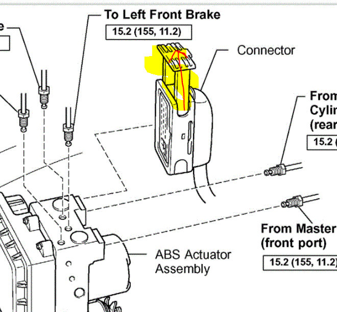

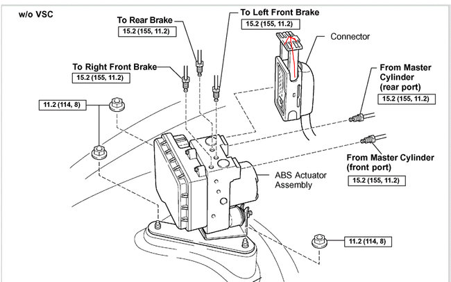

I have to be honest. It would likely be easier to disconnect the ABS actuator to see what happens. It will set the ABS light on until it's reconnected.
The actuator is under the hood on the passenger side of the vehicle. There is a cover over it. You will need to remove the cover to access it.
If you look at pic 4, it shows the location of the actuator. Pic 5 shows the actuator and the connector. There is a slide that you move upward and then the connector will come off.
If you still want to try this, you can pick which you feel more comfortable doing.
Let me know what you find.

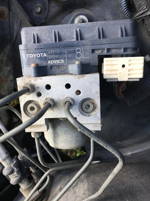

Joe,
Is this the ABS actuator that you advised me as the best way to temporarily disconnect the ABS? Since it has five lines leading to the master cylinder and I assume each brake, I believe this is it. It has an unusual electrical connector that looks like it may be difficult to disconnect.
May 26, 2021 at 1:08 PM
  • 110,251 POSTS
That's it. As far as the connector, pull up on the slide. That will release the lock and then you will be able to remove the connector.
I attached a pic below showing the lock slide.
