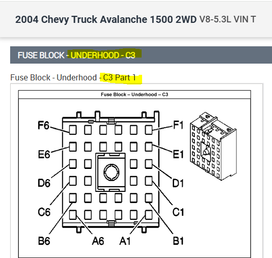

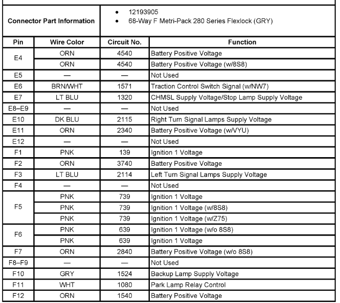

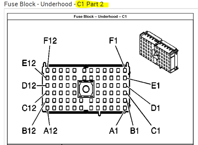

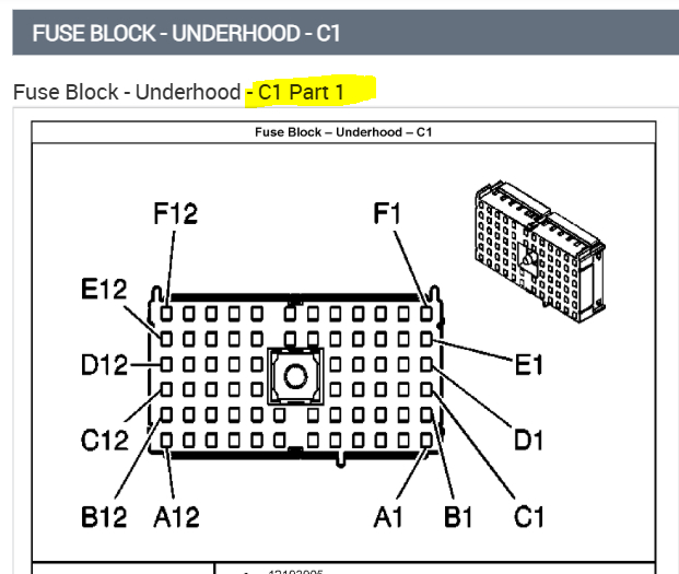

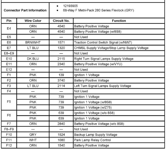

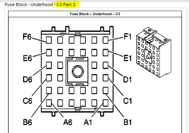

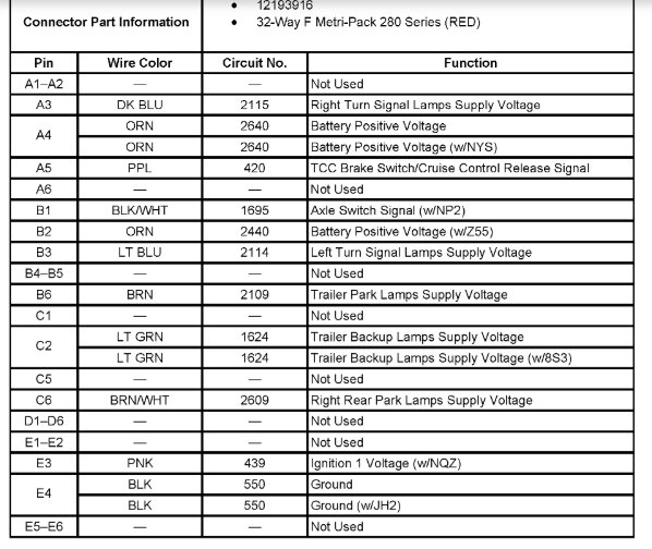

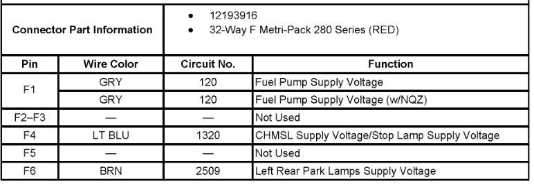

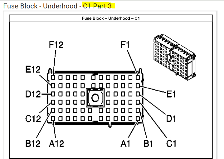

Do you have diagrams for c1 and c3
Apr 15, 2026 at 9:04 AM
  • 110,246 POSTS

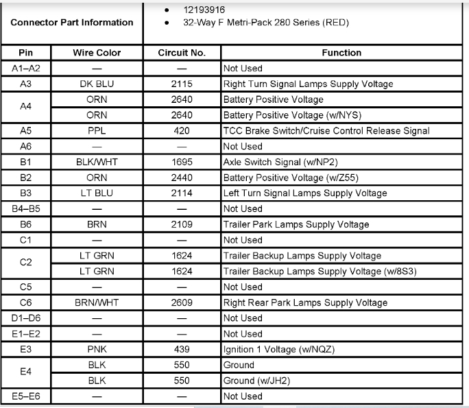

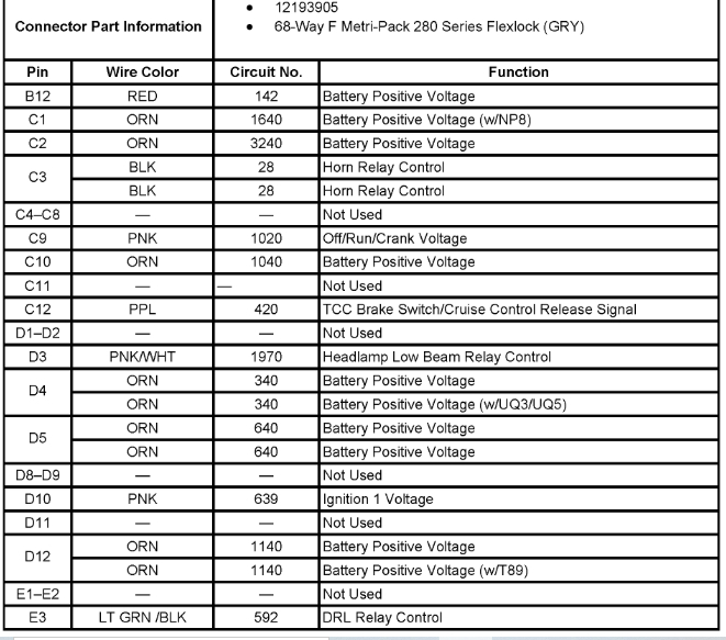

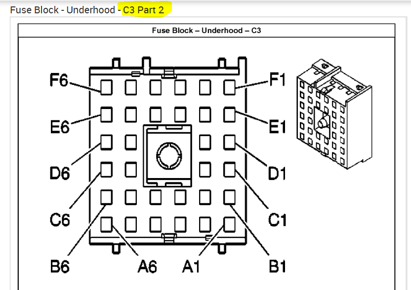

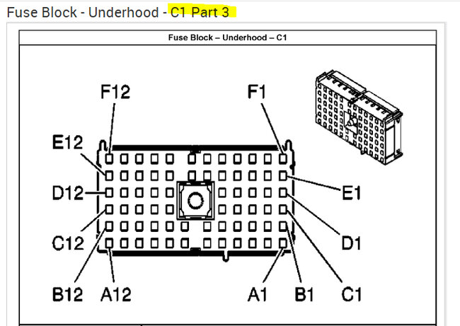

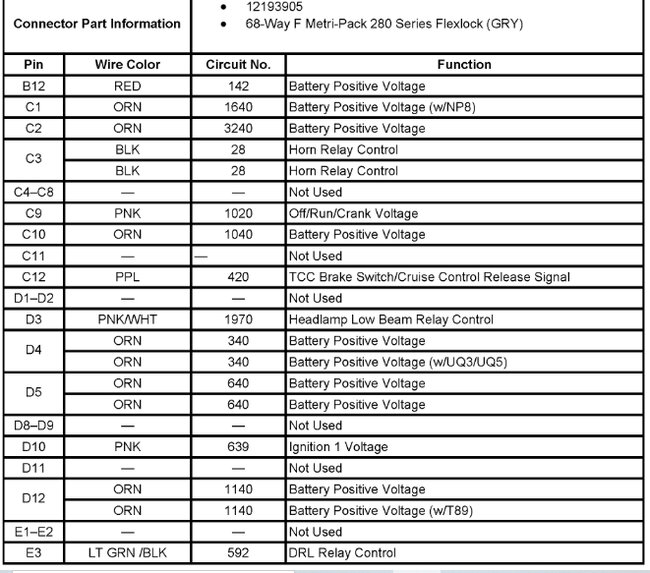

Hi:
I found the pin-outs for the C1 and C3 connector. If you look below, I attached several pics.
I started with the C1 connector. It shows the connector and the following pictures identify what each connector is for. Take a look over things and let me know if you have questions.
See pics below
