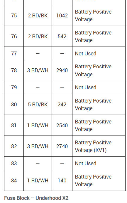

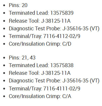

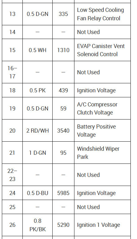

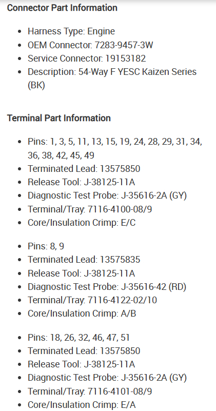

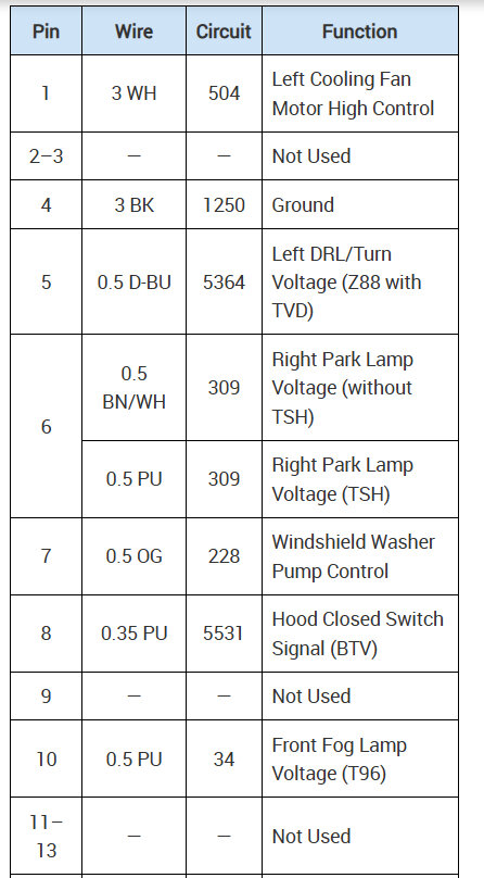

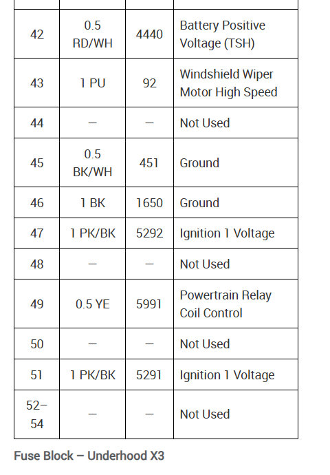

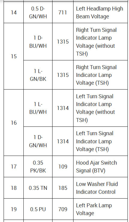

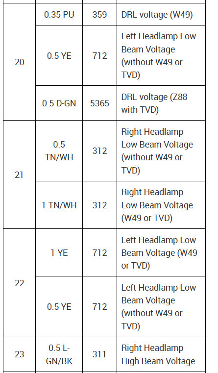

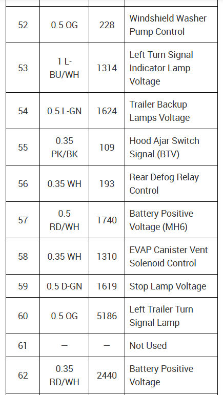

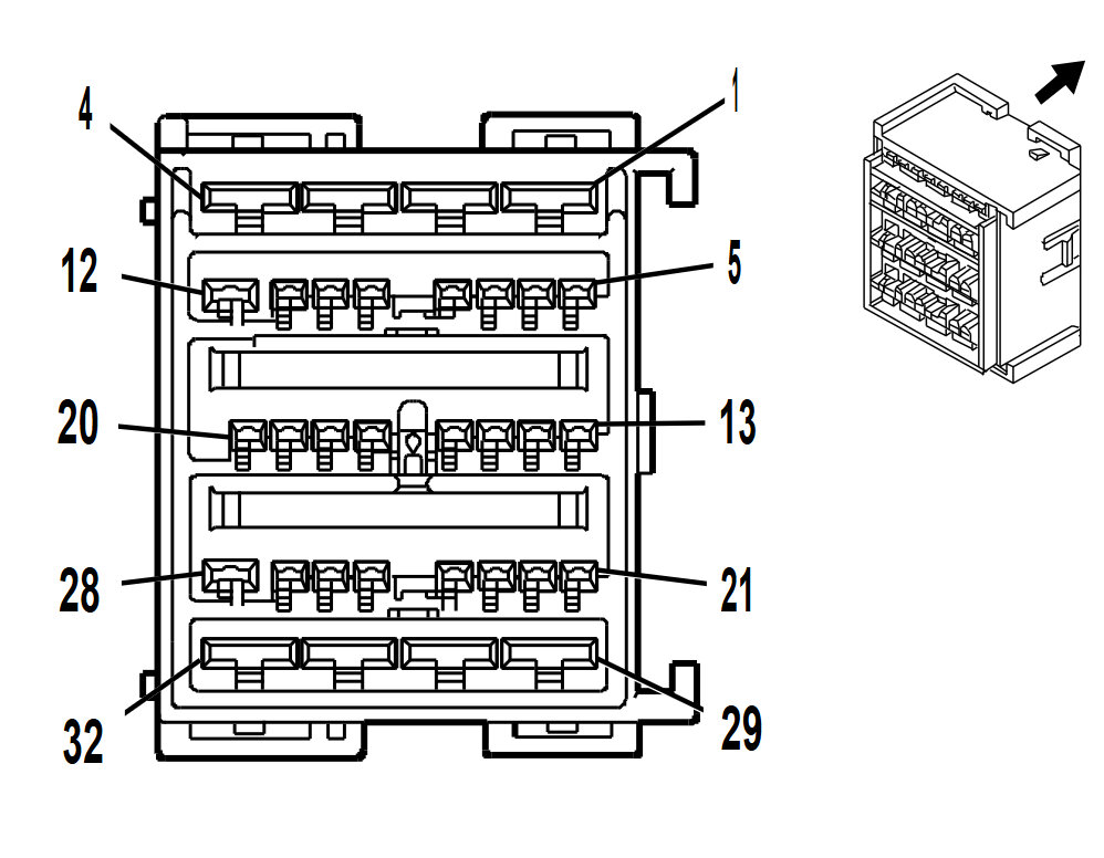

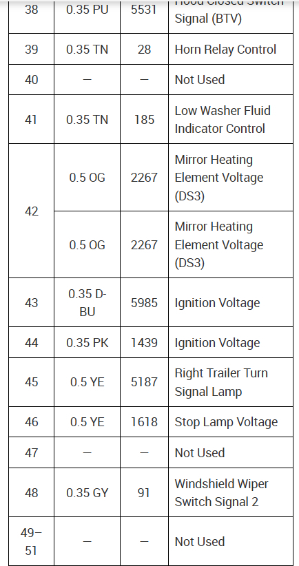

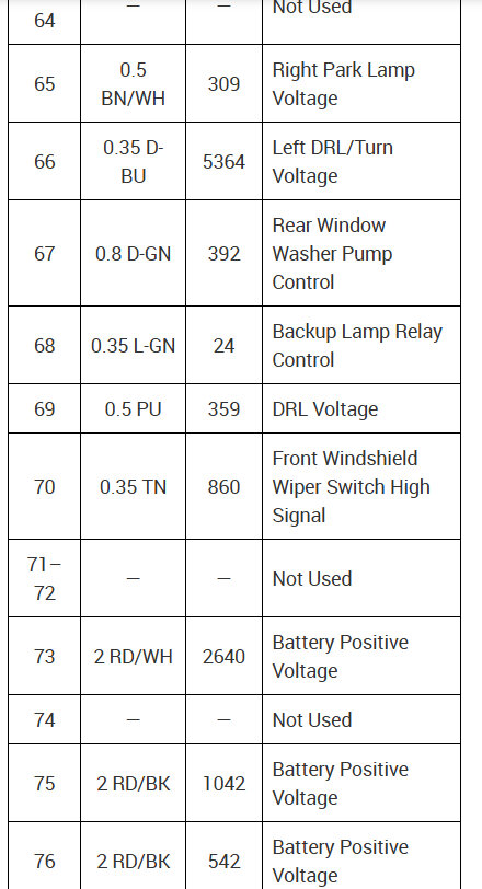

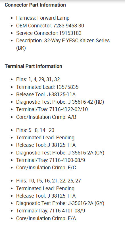

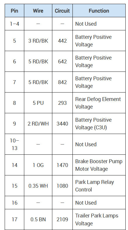

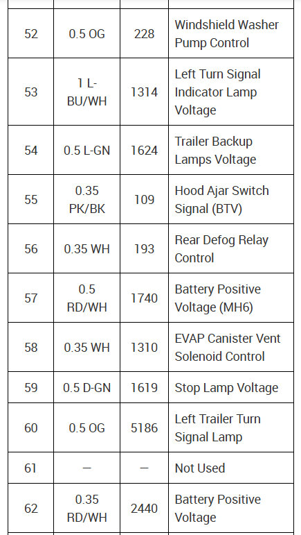

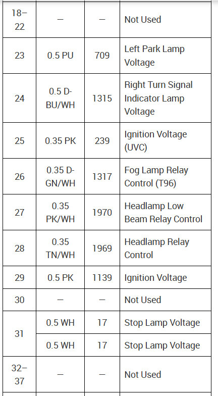

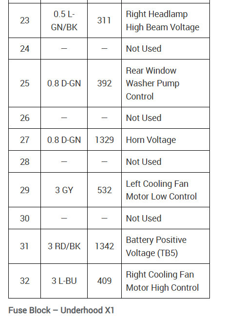

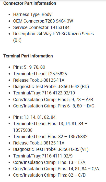

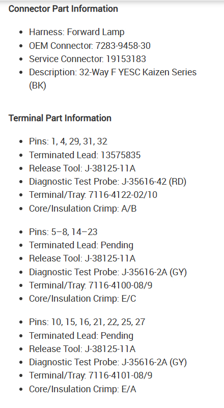

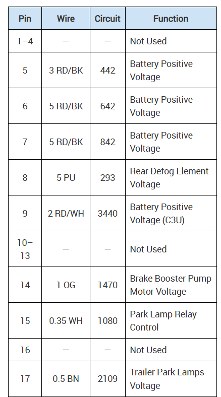

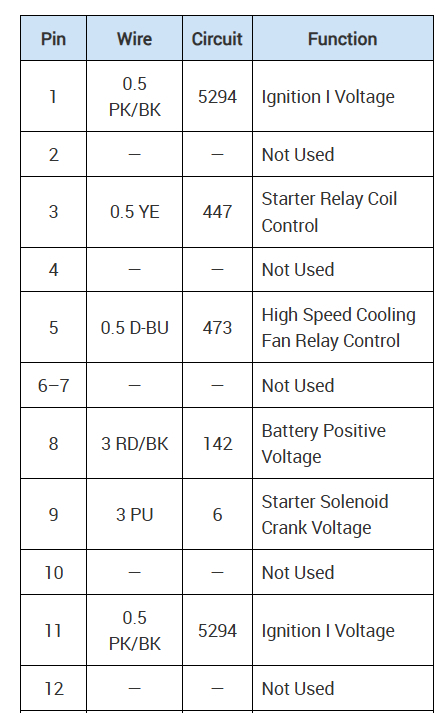

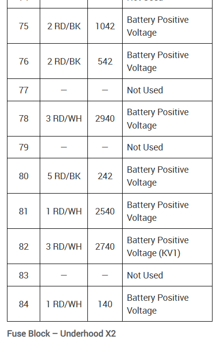

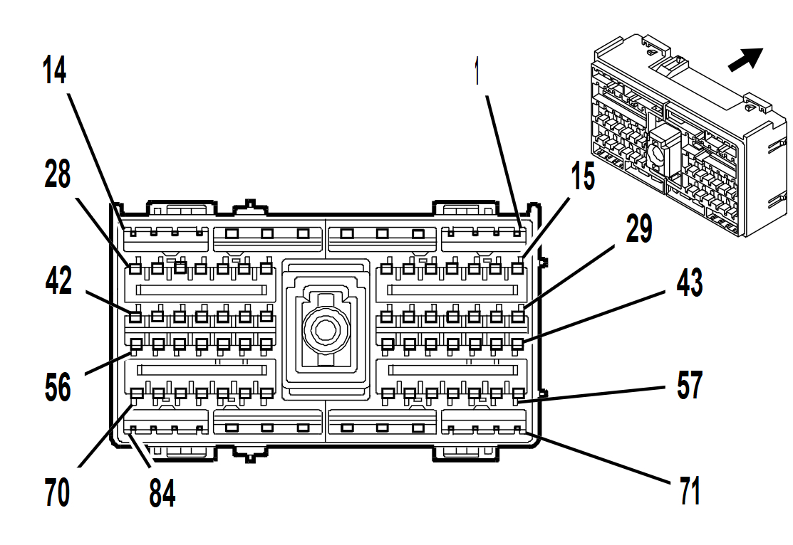

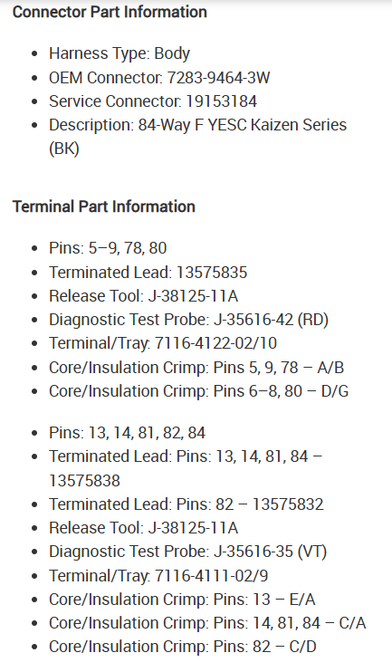

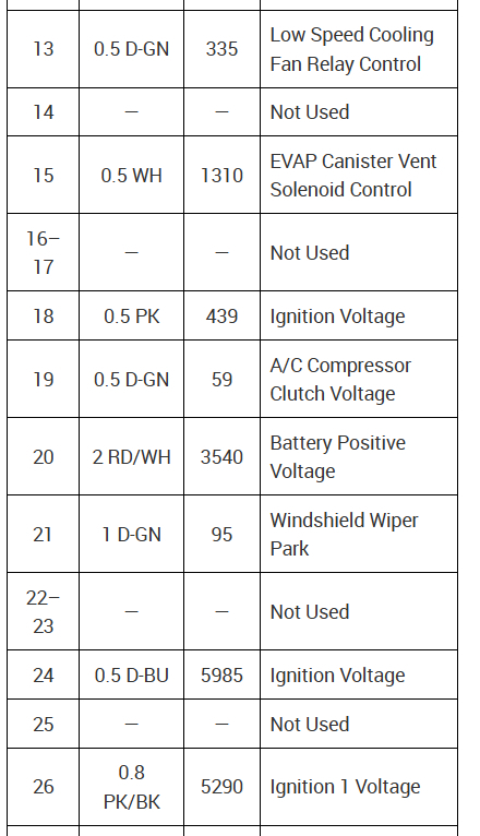

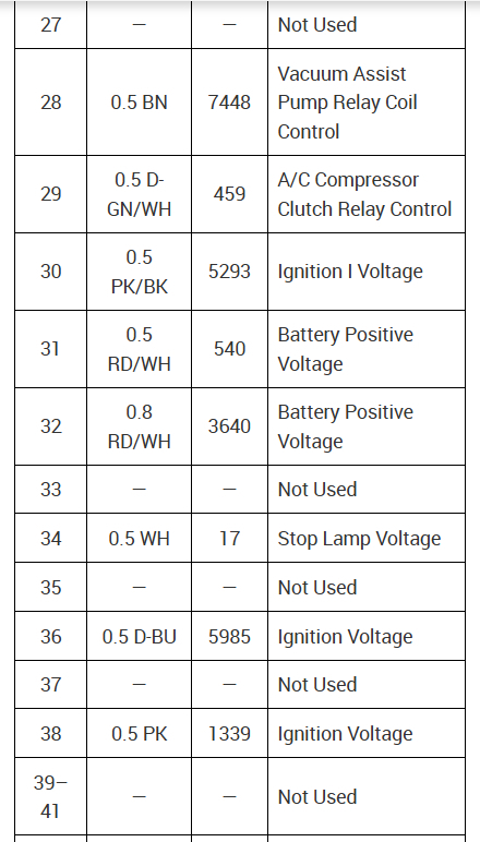

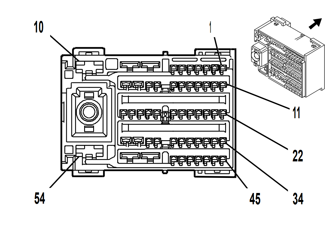

Can you please help me with the diagrams I need for my wiring harness for my vehicle listed above? Here is the VIN if you need more info. 1GKKVRED6BJ257868. The connectors, the pins that hook up underneath the fuse block and also the ends that meet under that. Please and thank you.
Mar 13, 2025 at 5:21 PM
  • 55,423 POSTS
Hello! yep, that will be some wiring, here are the connector views with the wiring locations for the fuse panel connectors. Check out the images (below). Let us know if you need anything else. Here is an answer AI can't do :)
