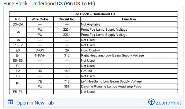

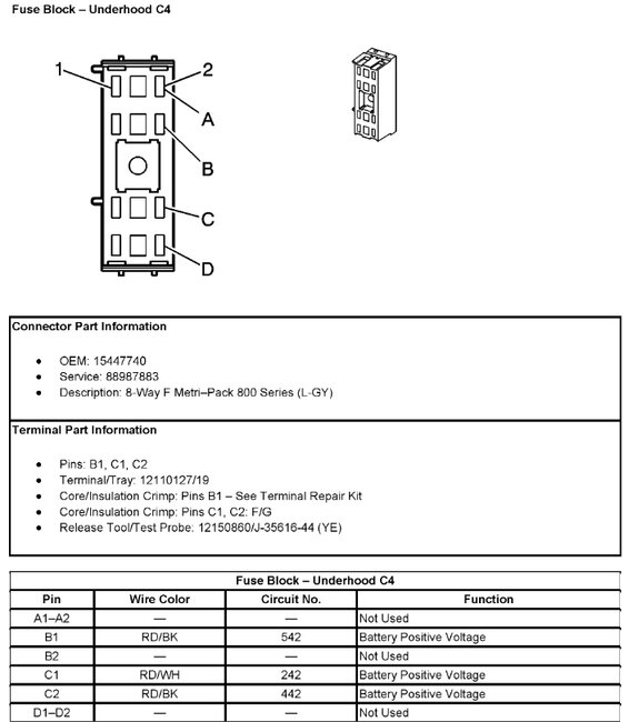

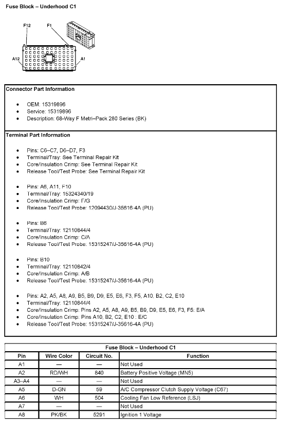

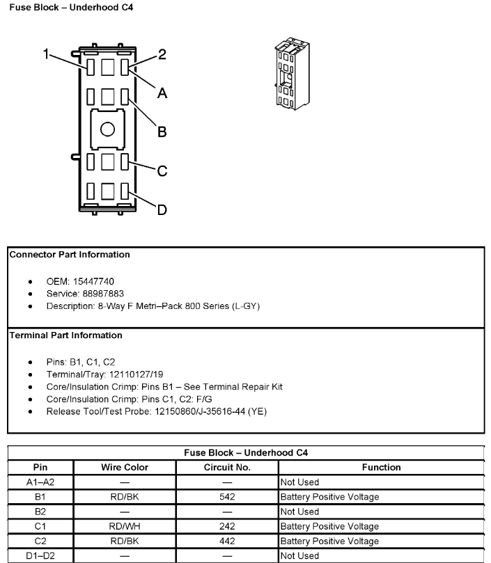

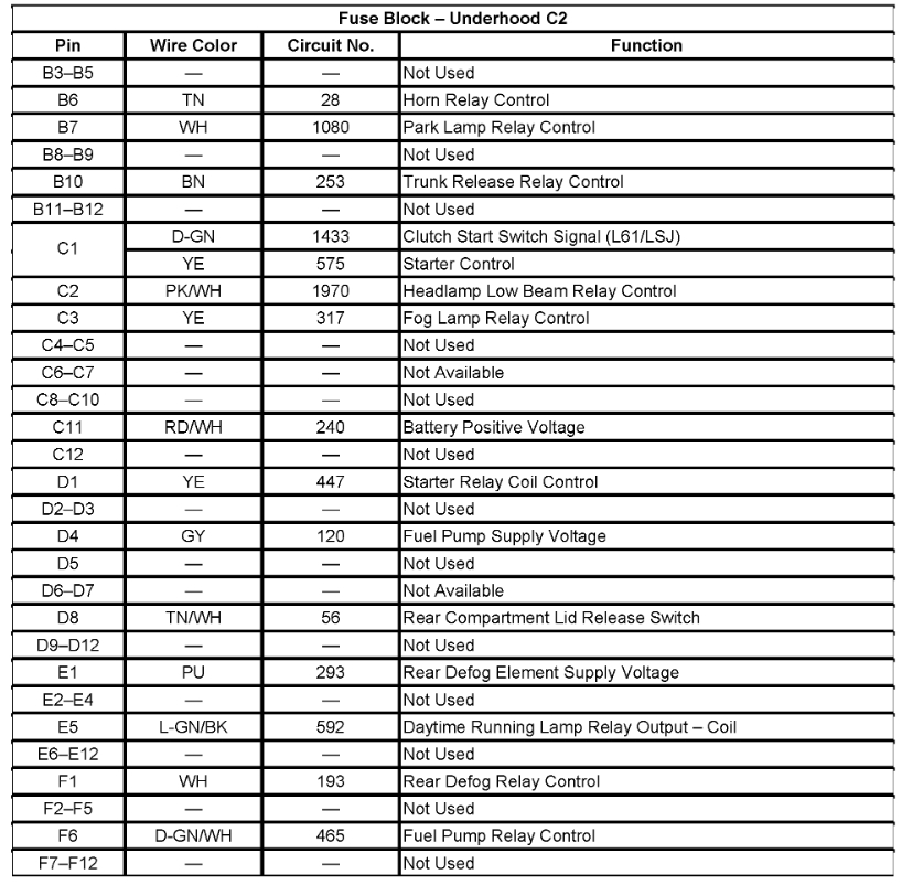

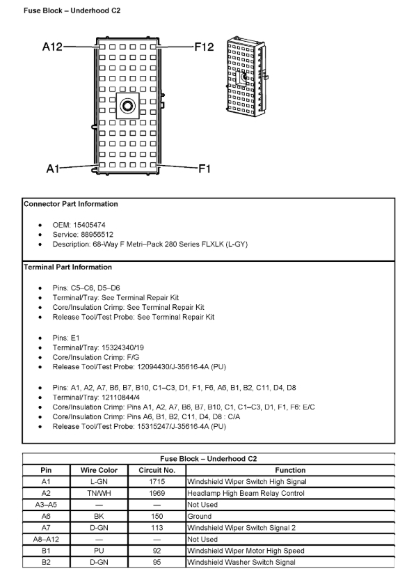

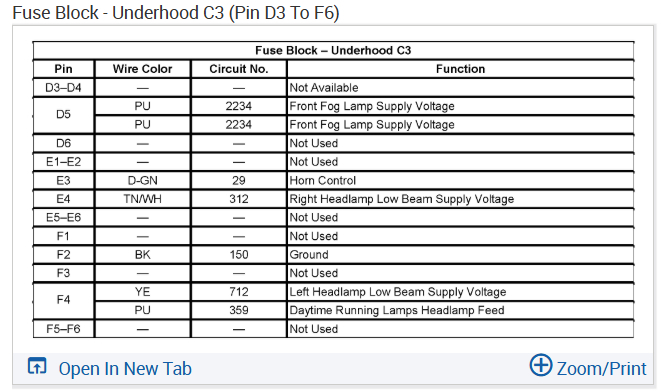

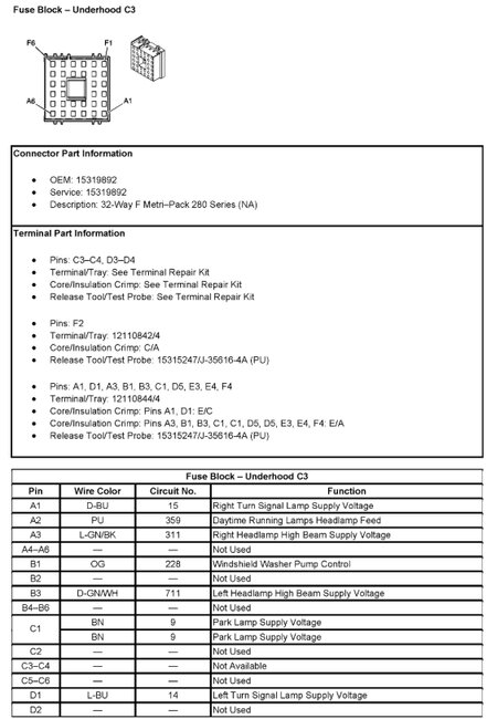

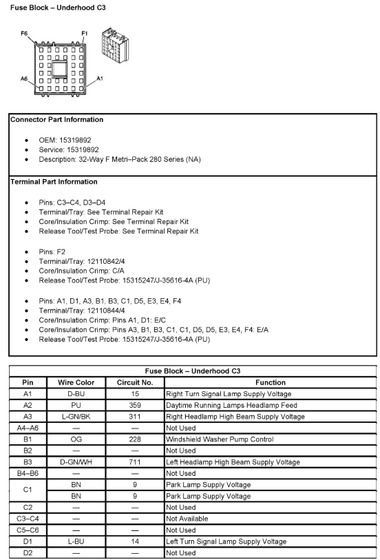

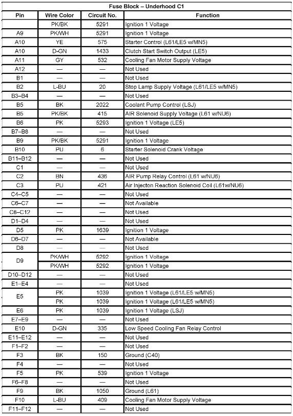

I need the wire layout and colors for the underhood fuse block connectors just did a engine swap and the connectors that plug into the bottoms of the fuse block the wires got pulled out. Need a diagram and picture of the colors of the wires and where they go on c1 c2 c3 c4

Sure here are the fuse panel wiring diagrams for the connectors as requested. Check out the images (below). Let me know if you need anything else.
