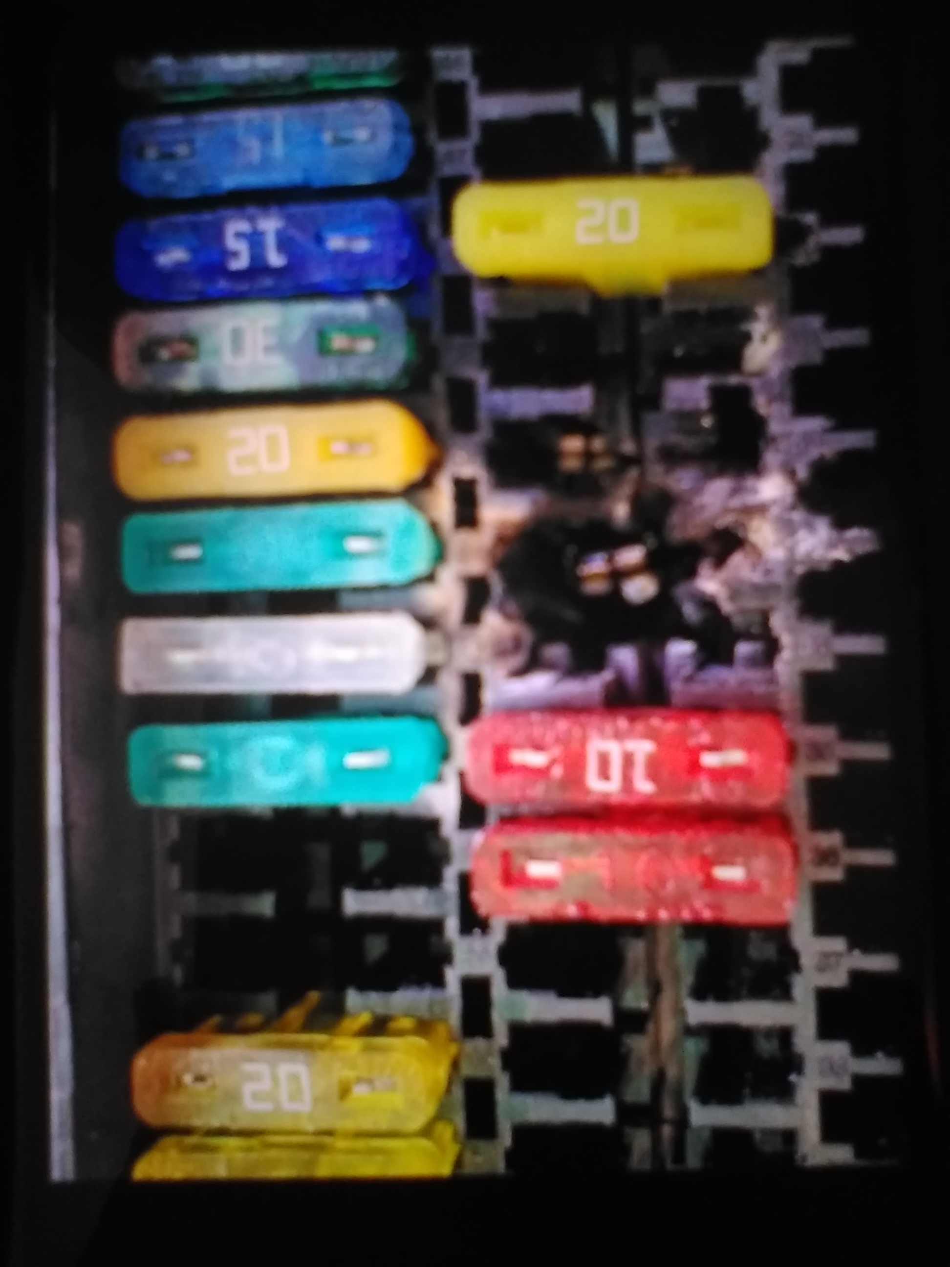

I have the car listed above TSI, it has started to blow out fuse for my A/C. Replace it with a same fuse it was originally installed. So, one day i turn on my A/C and i noticed it stopped blowing cold air and a burning smell or was in my car. so, i turned off my A/C. when i got home i removed the fuse cover and there it was my fuse was melted. Any idea why this happened?

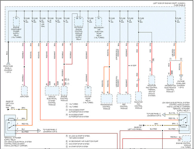

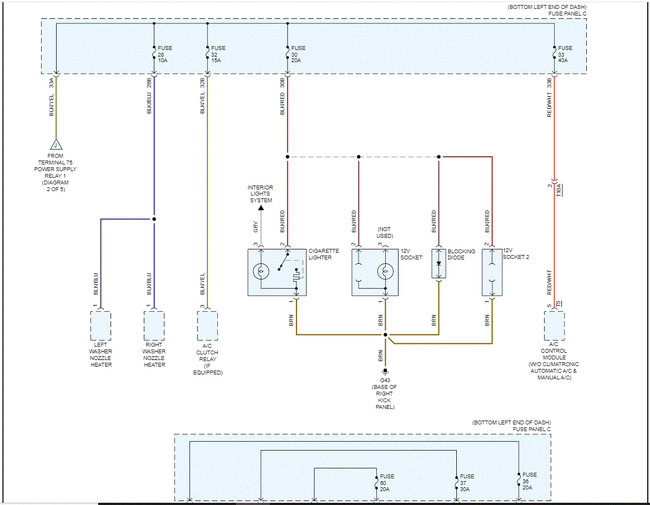

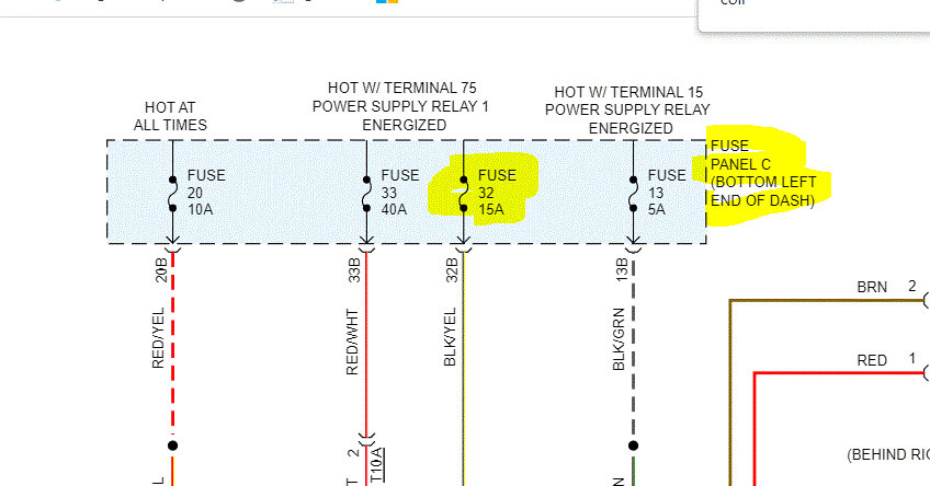

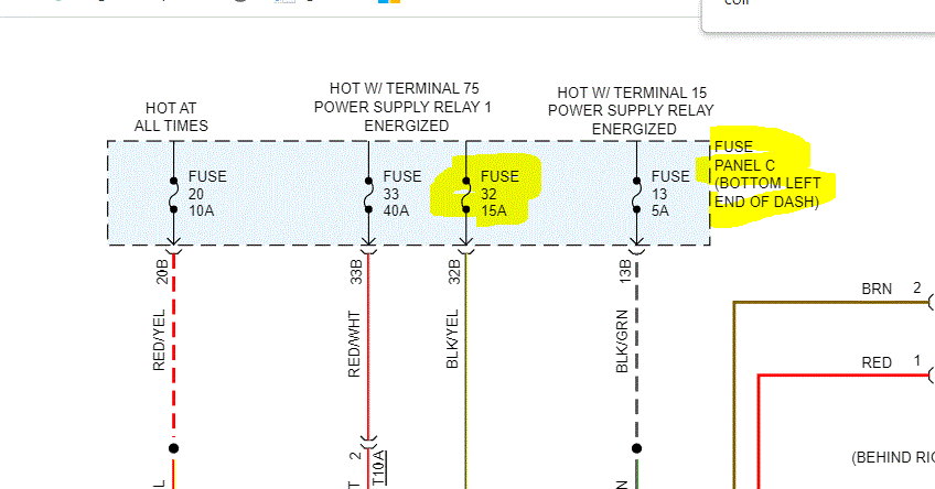

If the fuse was the correct amperage, it would have failed. How badly did it melt? It could have a spot where the fuse heated before blowing. Also, what amperage was the fuse, which fuse box, and is it the one for the AC compressor? I suspect it is a 15-amp compressor fuse in Fuse box C. See pic 1. Let me know if I'm correct.
Let me know. Also, let me know if this has automatic climate or manual climate control.
See pic below.
Jun 2, 2022 at 8:21 PM

It melted a lot so I'm going to need to replace my fuse box. So, i opened my fuse box to see if I could line up the fuse holder and i placed a new fuse and turned the fan on working good, but when I turned my A/C the fuse started to get warm. so, i pulled the fuse. It's a manual unit and yes it had a 15. I was going over my A/C and found out that my A/C pressure switch is not working.

If the pressure is getting too high, it will place an excessive load on the compressor clutch/coil. That will cause it to draw more power to operate. It sounds like you may have found the cause.
My only concern is this. The fuse is designed to fail at a specific power draw. That truly should have happened before things melted. When you took the box apart, was there anything that seemed out of the ordinary? Are there any other things that appear to have been overheated?

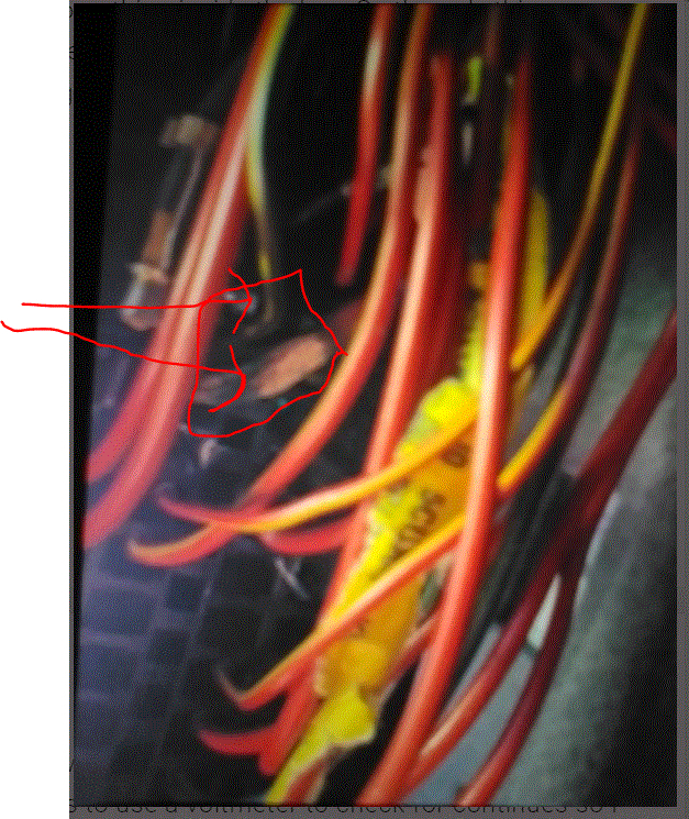

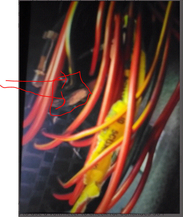

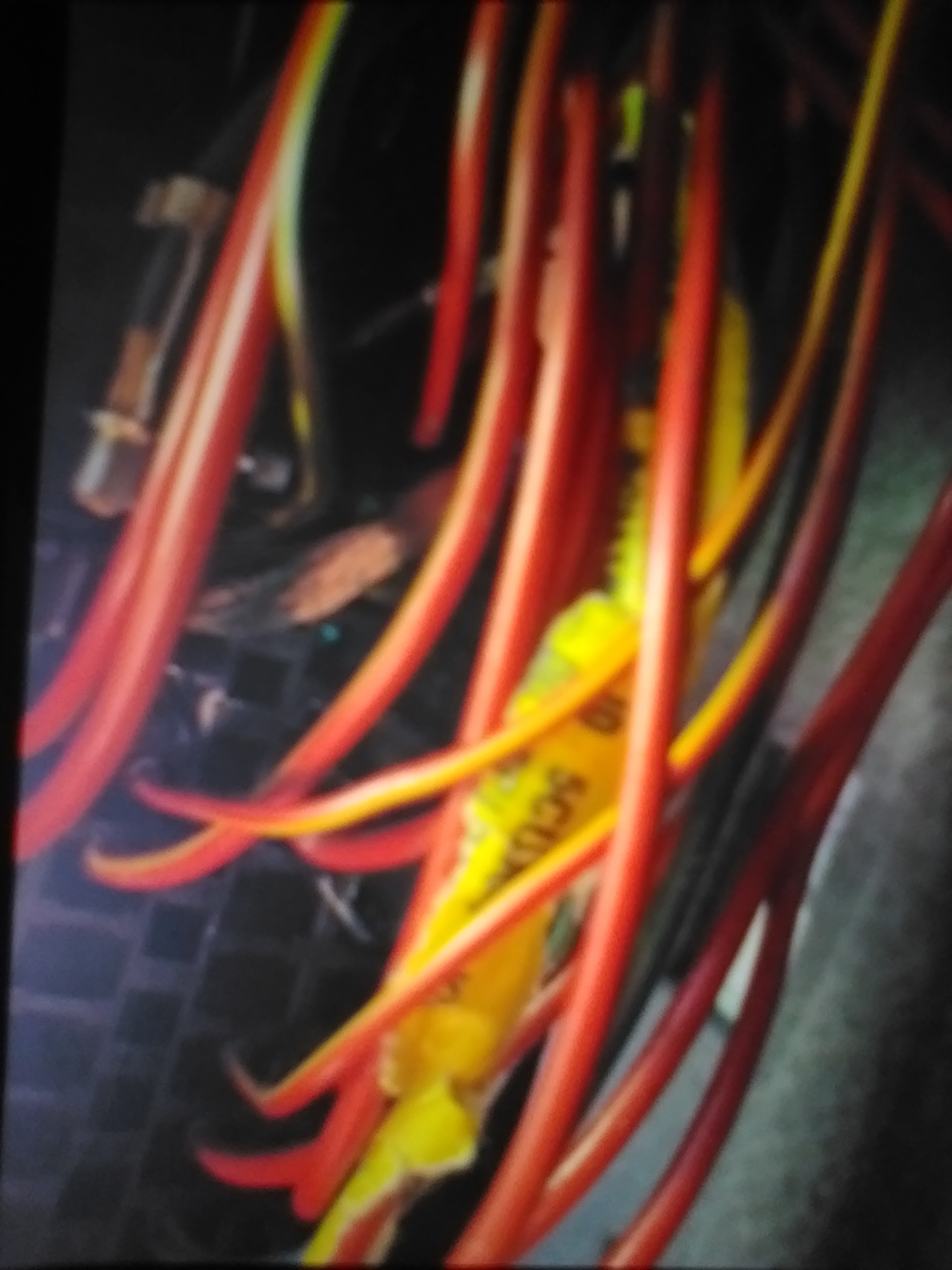

I didn't see anything out of the ordinary well, to be honest, it's the first time I open a fuse box. I have some pictures. I was planning on taking it apart to clean it out and see if I find something inside the box. So, the only thing holding me back is going to be trying to figure out where each wire goes where, maybe you have a diagram or a way to make it easy to rewire the fuse box back.

  • 110,194 POSTS
If I had the vehicle, I would replace the fuse box. I don't see how you can fix what has happened. Also, I copied one of your pics from above. Are the wires I circled going to the fuse that melted the box? See pic below
As far as wiring schematics, I can try my best, but I need to know a few things. For example, I need the production date of the vehicle, is it a hybrid, and how would you best describe it? Is it more of a base model or is it loaded with options?
See pic below.

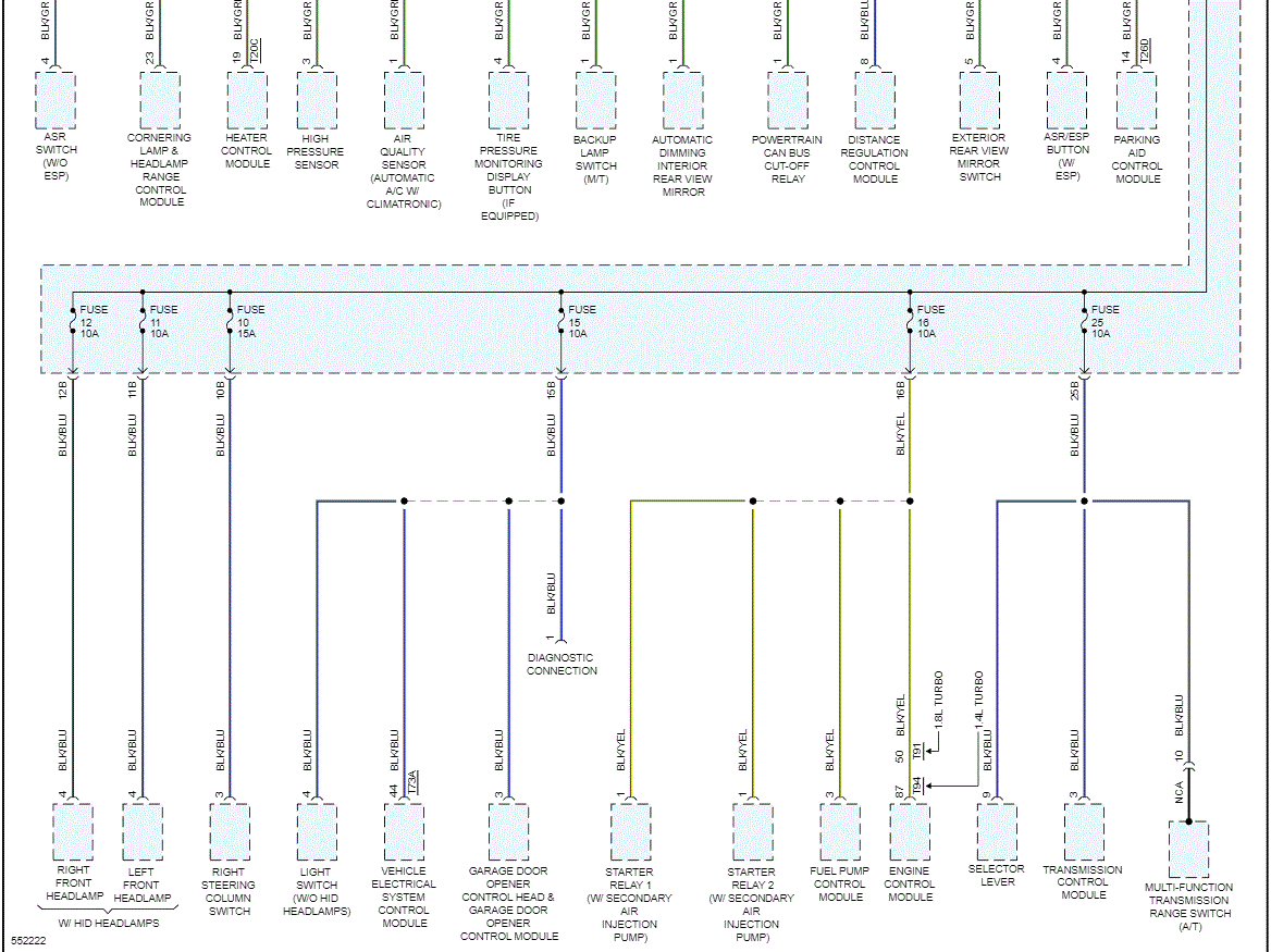

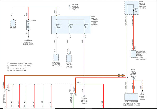

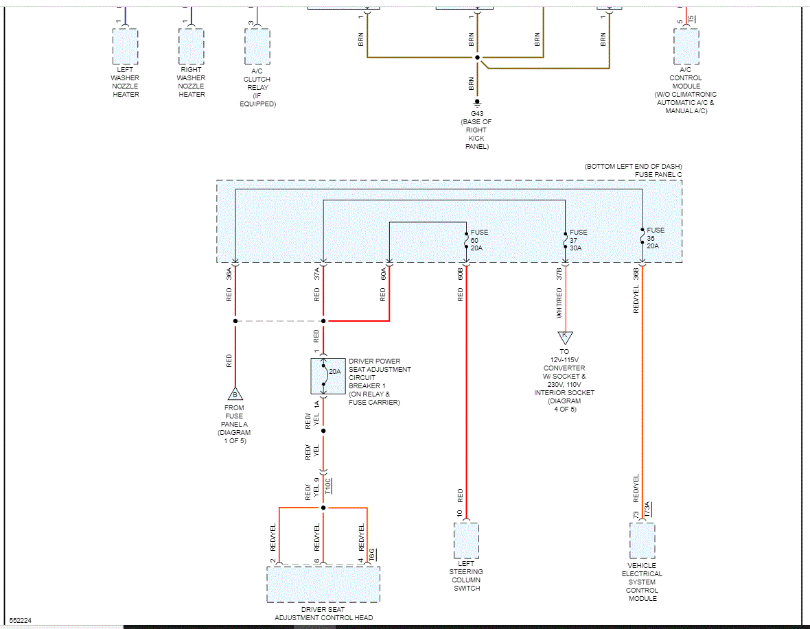

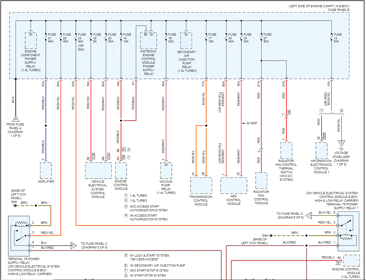

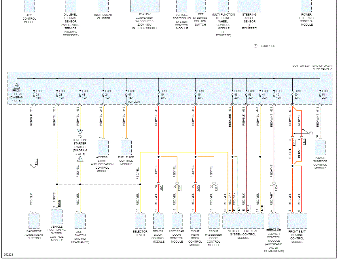

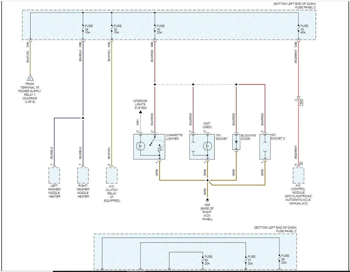

  • 110,194 POSTS

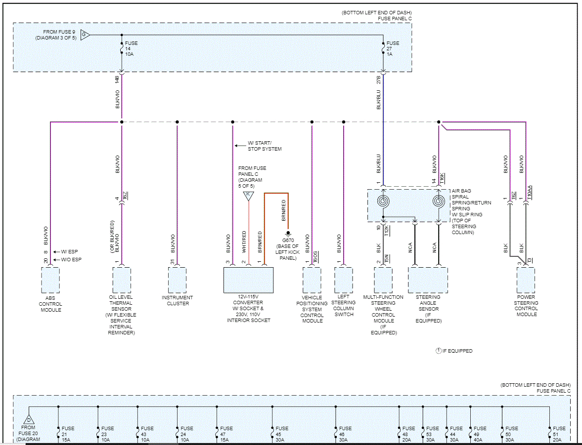

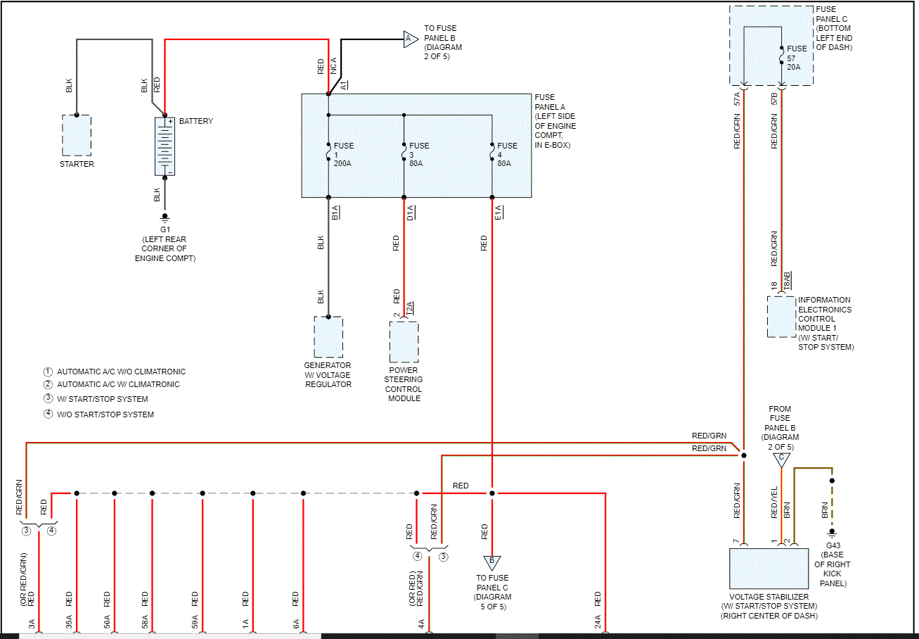

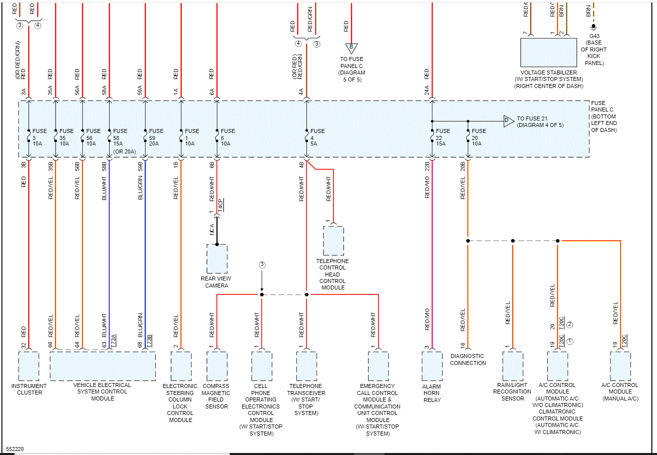

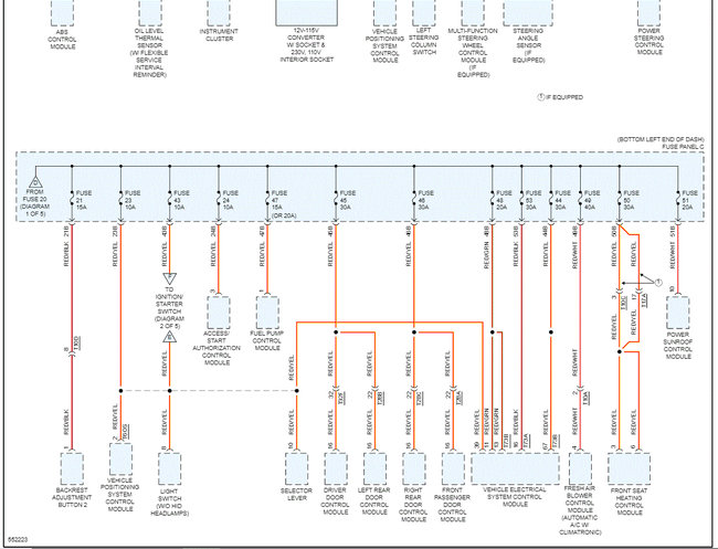

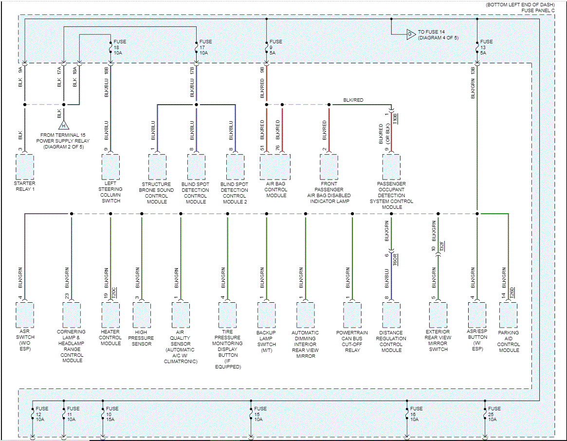

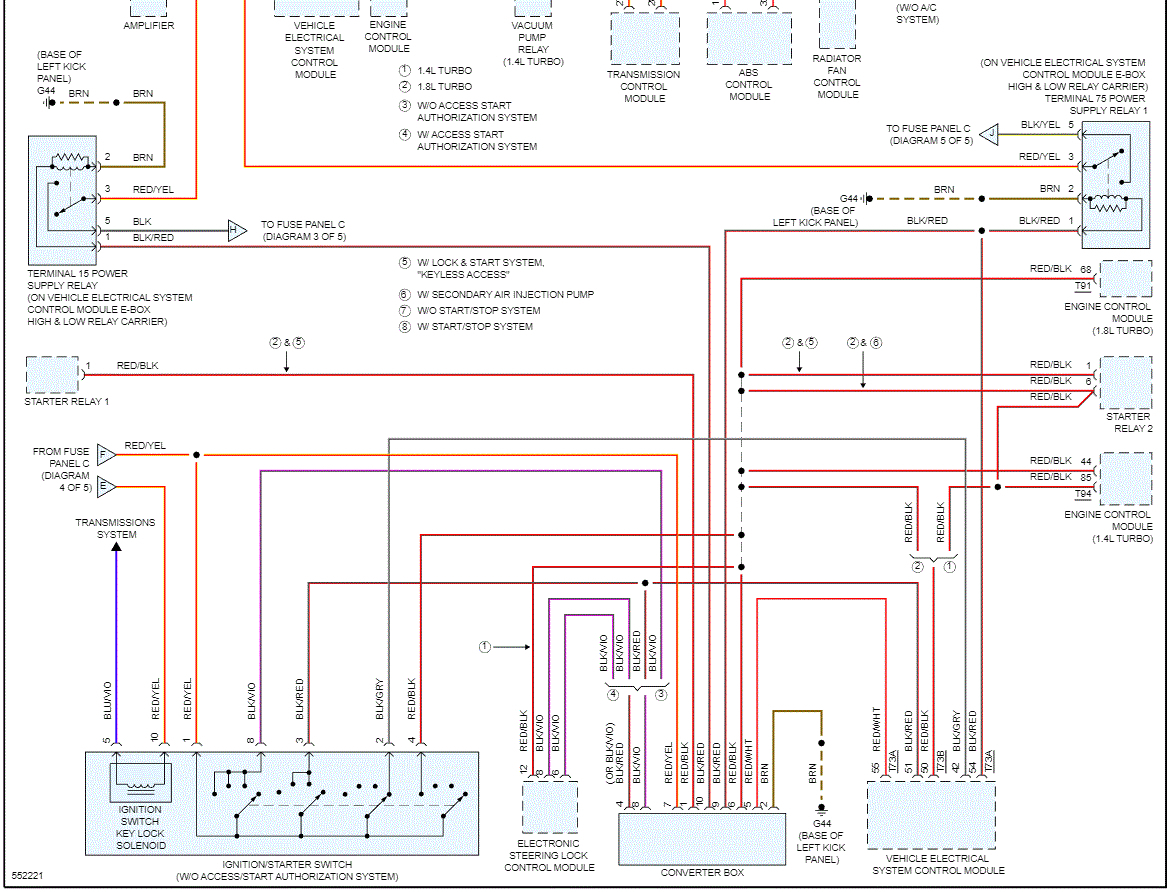

The only thing I have is the power distribution schematics. Take a look through them and let me know if they help.
Also, there are 5 pages of schematics. I had to cut each page in half to make them readable for you. I did overlap them so you can follow from one to the next.
Jun 9, 2022 at 7:57 PM
