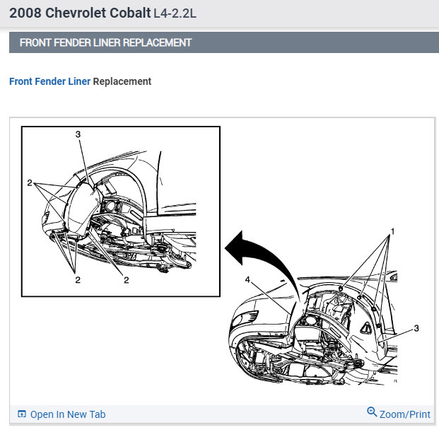

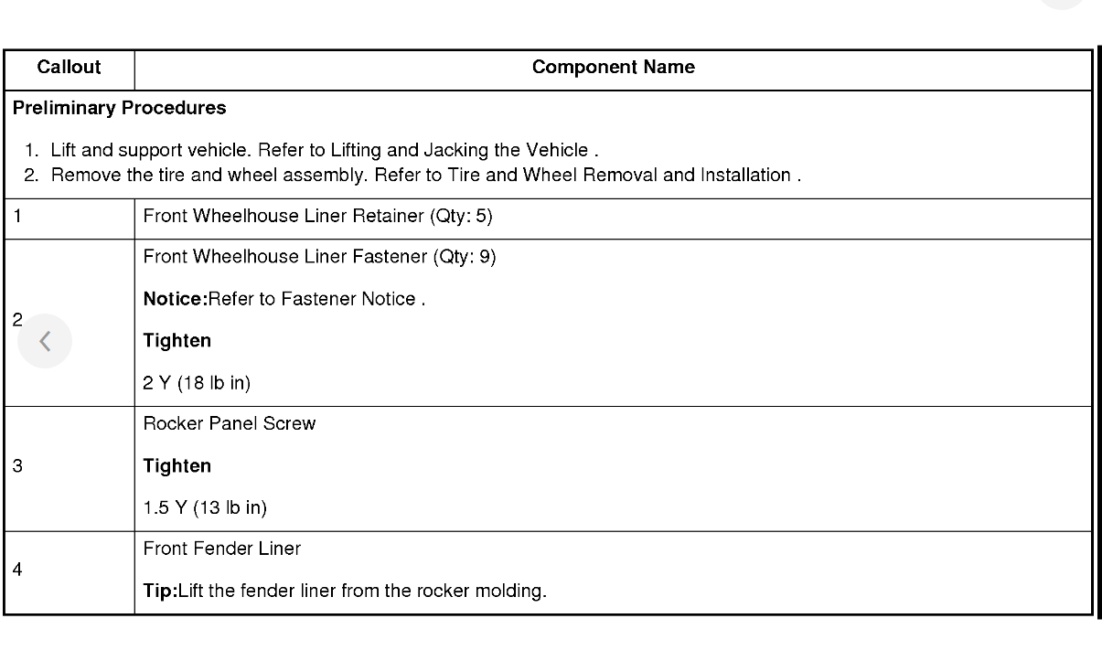

I had to remove the plastic underbody in the front. To replace the clutch components. I am having trouble replacing a small plastic piece that goes on the driver side wheel well. I just don't remember how to get it back on.
Feb 18, 2022 at 11:40 AM
SQM
  • 6,383 POSTS

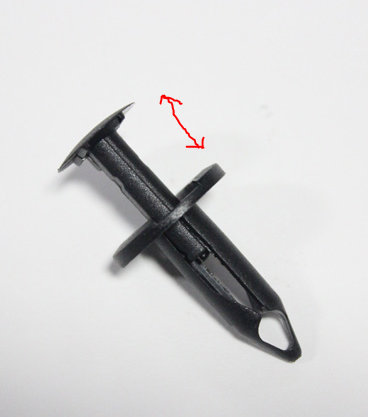

For those fasteners, you want to make sure that the push part is pulled all the way out before it can go into the hole.
Here is a helpful video, it is on a different vehicle, but the procedure is similar:
https://youtu.be/ZF7d-zE-AqI
I have attached a picture of the fastener as well as the replacement procedure below.
