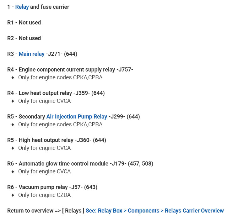

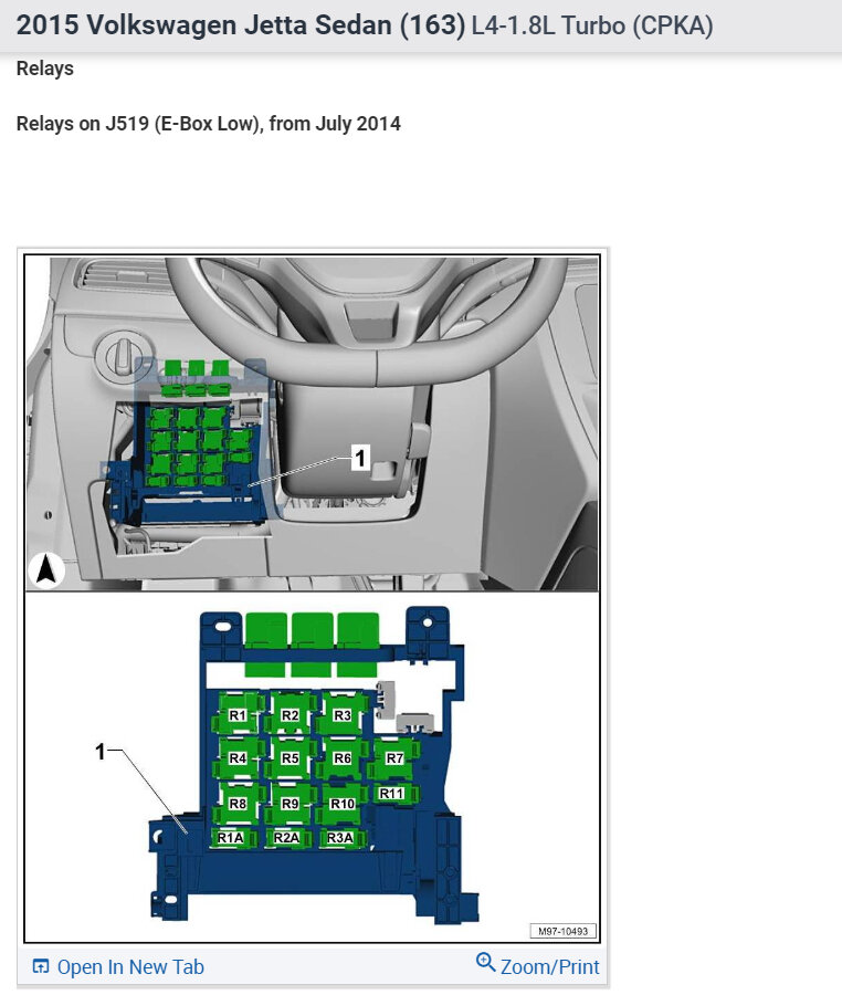

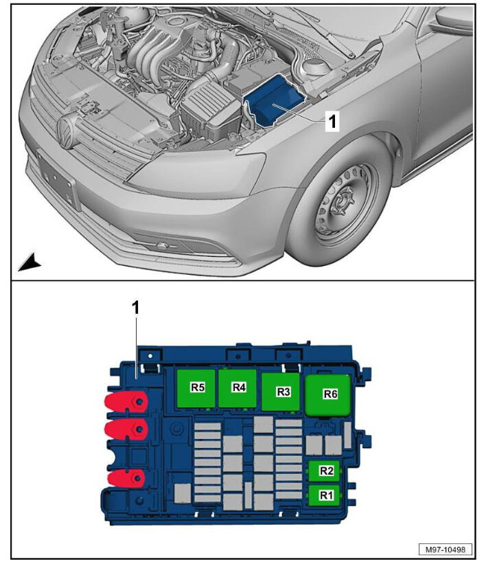

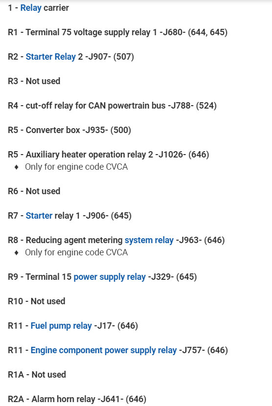

I need a diagram for my car listed above SEL; regarding a removed relay that needs to be replaced.
Sep 19, 2023 at 3:22 PM
Experienced Mechanic
55,628 POSTS
Sure, here are the relay locations and what they do, I also included a guide to help test them:
Check out the images (below). Please let us know if you need anything else to get the problem fixed.
