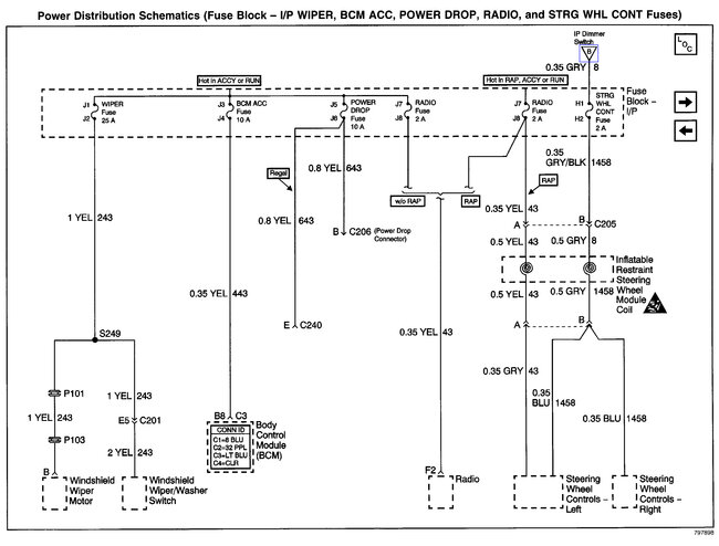

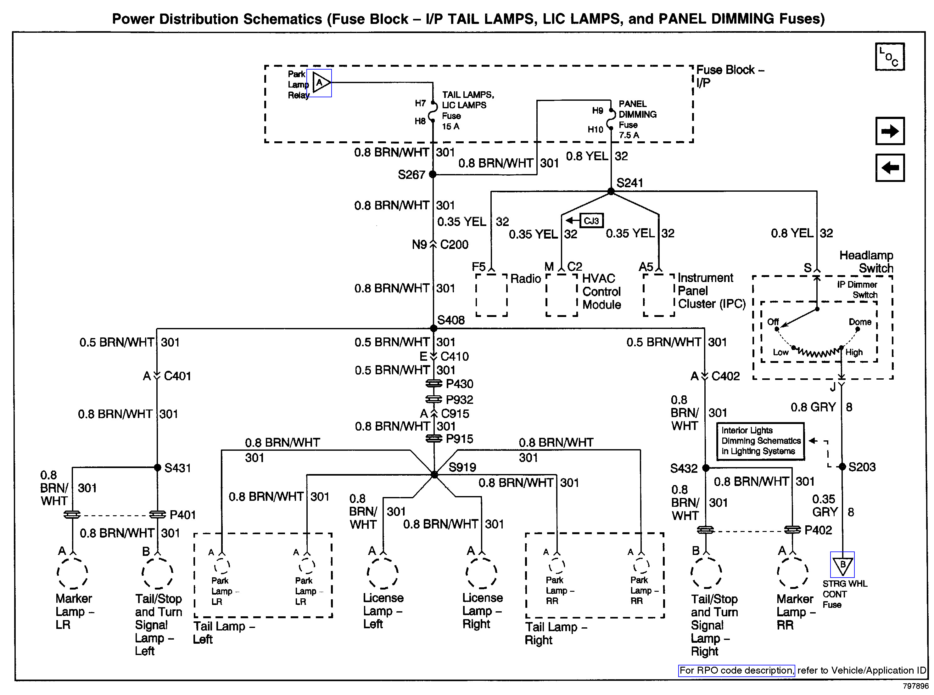

Hi, I need a wiring diagram for the under-hood fuse box.

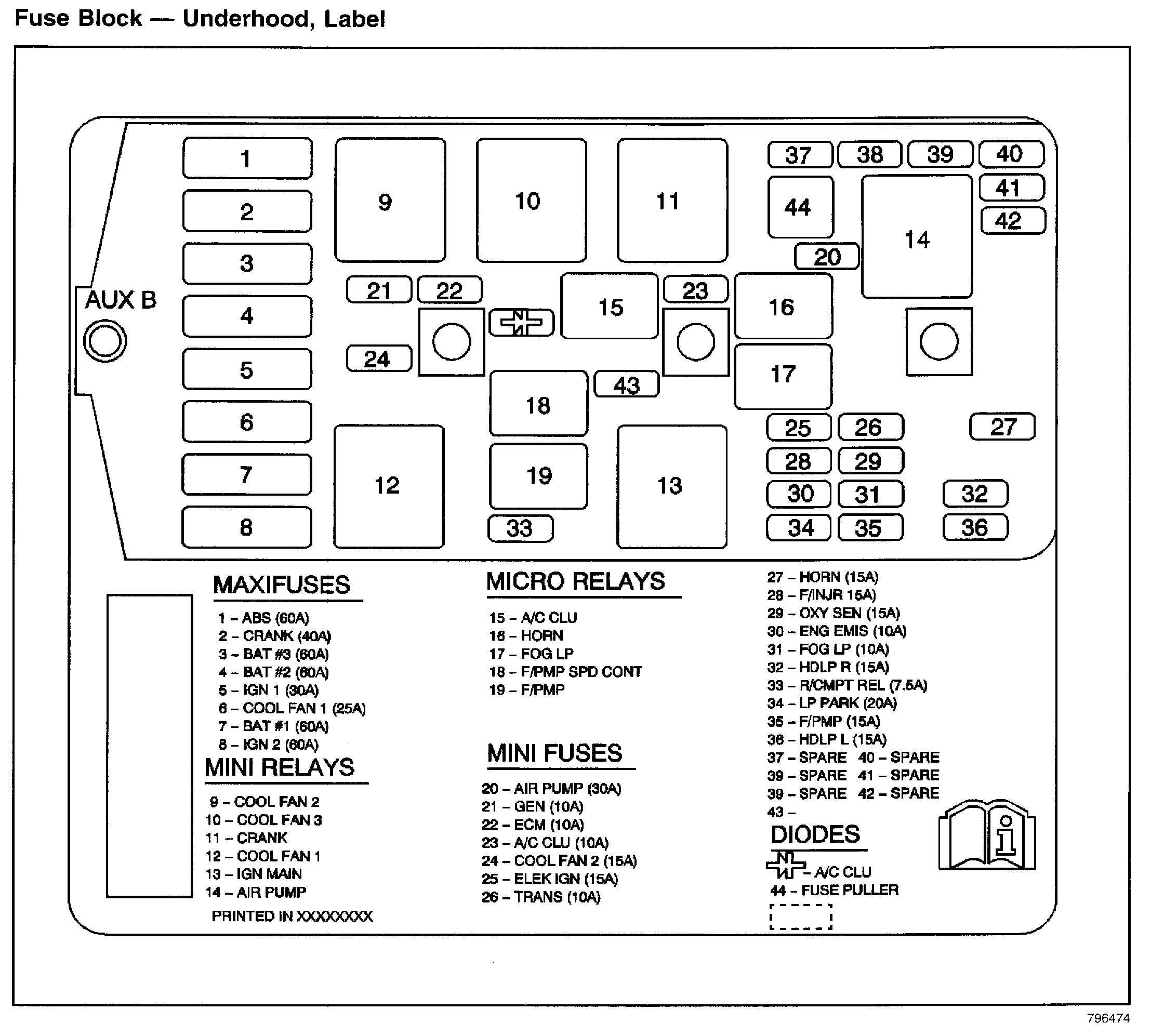

Here's the diagram for the under the hood fuse box. please click the image below.

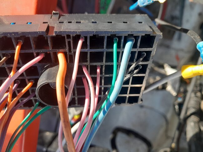

I need where the wires go into the fuse box.

I need the diagram for this.

What distribution
Power ?
Ground ?
Theres alot of them
Im assuming power
Aug 26, 2025 at 4:47 AM
HAYDEN224
  • 5 POSTS
I need it for the pink wires I screwed up and now I don't know where to put them.
Aug 26, 2025 at 4:56 AM
MECHTRIX
  • 577 POSTS

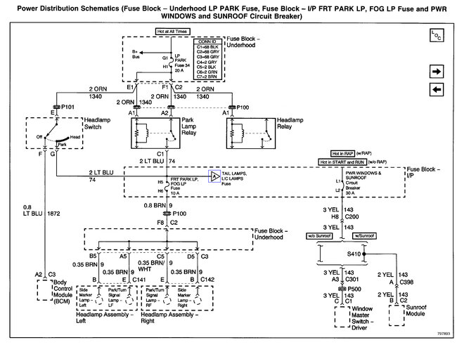

There's 3 diagrams for the underhood relay and fuze box
Each one shows up top what they're for including wire color ..just keep in mind they're combined for the one box ..just click the images below . Good luck
