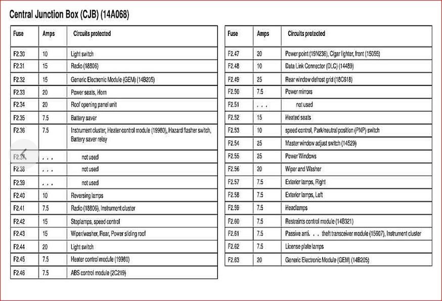

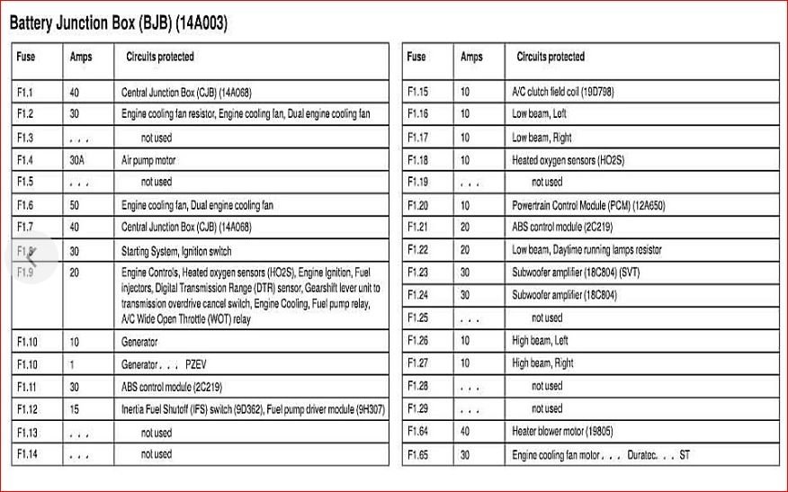

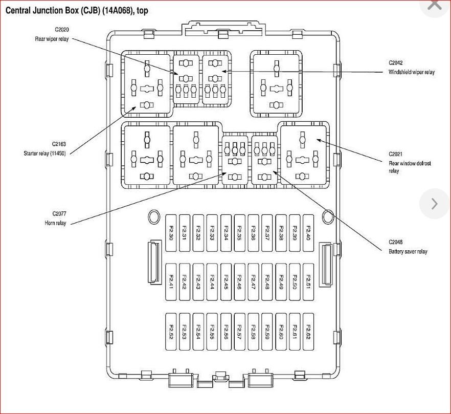

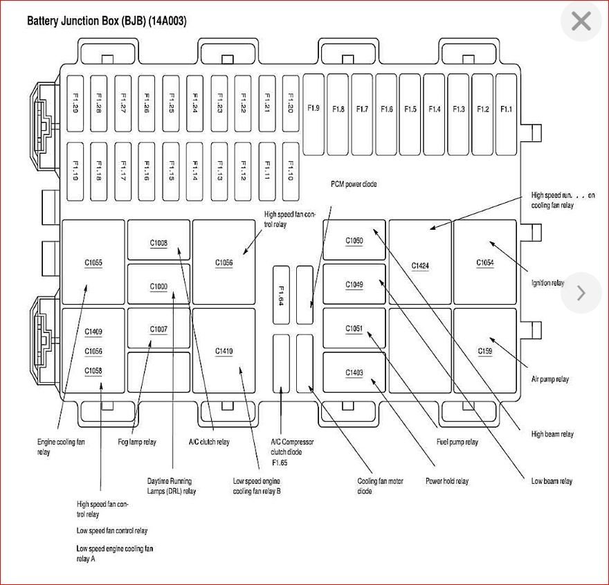

Under hood fuse box diagram needed
2003 FORD FOCUS
100,000 MILES
REYNOLDSSTACI
I would like to know the diagram and where the fuses belong if they are all there.
Jun 18, 2019 at 12:06 PM
Hi ReynodsStaci,
Here are the battery junction box in the engine compartment and the central junction box behind the dash panel.
Let me know if you need more information. Thanks
