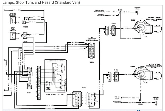

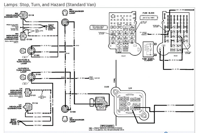

I had a fire in my van and it's basically under the dash I have to replace the dash and everything there I need a wiring diagram for the wires under the dash. I got a harness from junk yard and been piecing it together but have nothing to work from. colored would be great.

I would be happy to help, but there is one issue. There isn't a specific schematic for under the dash because the wiring there is responsible for multiple circuits. For example, there is wiring for the radio, brake lights, signals, headlamps, ignition, and so on.
Is there a specific circuit or component that you need? I would be happy to help, I just need to narrow things down.

Yes of course sorry, as I said all wiring under dash burned, I've managed to do some correctly. 'I think I need the brake light, turn signal, hazard wiring.

Regardless, because of the model year, the only thing I have for these circuits are the original schematic from the manufacturer. They are a little more difficult to follow, so let me know if you have questions.
As far as the brake lights, signals, and hazard lights, they are all tied together. See the two pics below and let me know if they help.
