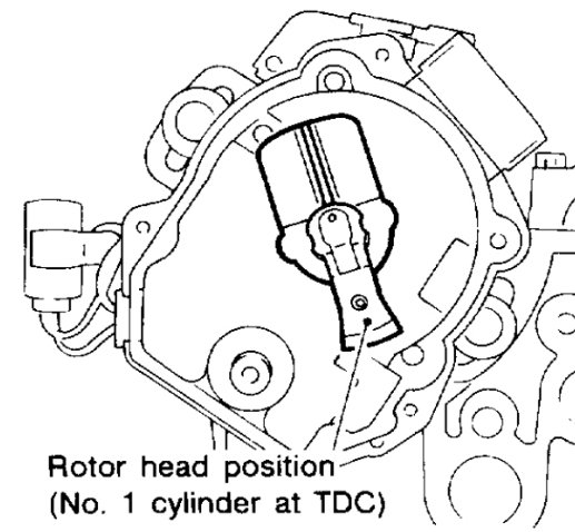

Is there a mark on the harmonic/crankshaft pulley which is for TDC? I know the timing is not adjustable and is controlled by the PCM. However, the rotor shouldn't be pointing toward the number 4 spark plug wire. It sounds like the distributor is 180 degrees off.

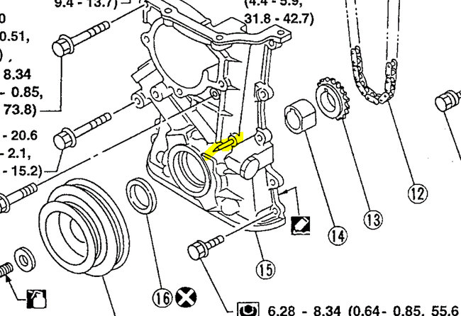

Take a look at pic 1 below. I highlighted the pin to indicate TDC. There should be a mark on the crank pulley. Check that.

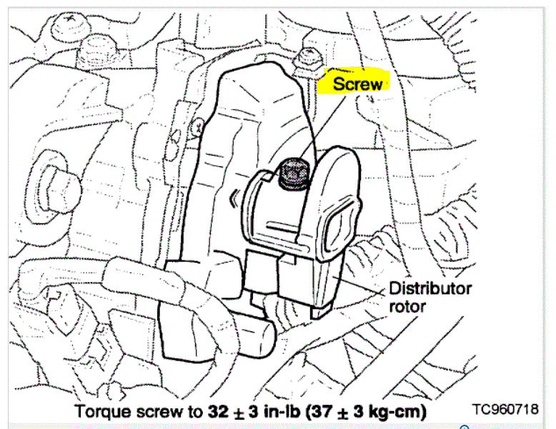

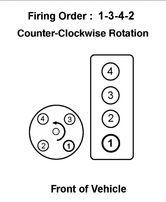

Also, pic 2 shows the firing order. Cylinder 1 spark plug wire is on the opposite side of cylinder 4. Please confirm it is pointing toward cylinder 1 spark plug. Also, make sure the rotor is tight. (Pic 3).

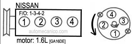

10-4. Yes, I confirmed the pointer was pointing to the second mark (from the left) on the pulley (indicating 0 TDC). However, the cylinder order picture you provided is incorrect, I am loading the correct picture for my engine (GA16DE). Sorry I forgot to provide that on the original question.
The Distro will only fit into the cam shaft with the head pointing towards the #4 cylinder. While trouble shooting, I completed the following steps and got lucky.
After installing the Distro it still ran poorly, so I removed it and rotated the distro shaft 360 degrees clockwise, reinstalled and saw no improvement. I repeated this procedure 3 more times and it finally resulted in the engine running correctly. I have the idle set at ~900 RPMs, but the timing marks are still not even close to correct, and I can't rotate the distro any more to get it closer to 10-degrees BTC. But the engine is running great again? Not sure what is happening except "maybe" the pully was installed incorrectly, resulting in the marks being off?

Yeah, I was thinking about why rotating it 360 degrees would have any effect, but then I was thinking that the Distro head has to rotate 16 times (twice for each piston) before a signal is sent at the exact moment it is pointing to the #1 cylinder. It appears that I got lucky and did not have to do it 15 times. However, the timing marks are still off. One of my mechanic friends found something that I tried.
It appears that in the 1990's some manufacturers would require you to disconnect some wire to properly set the timing. We found a YouTube video for this engine that says. 1) run engine up to normal operating temperature, 2) shut off engine and disconnect the Throttle Position Sensor wiring clip, 3) restart engine and increase RPM to 2,000 2 to 3 times, 4) check timing and rotate distributor until 8-10 BTC is achieved.
I re-read the Distributor Replacement and Timing Setting instructions in my Haynes manual and it says nothing about that at all. Anyway, I tried, and it works perfectly and the timing are right at 8-10 BTC.
