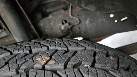

Haven't driven it, just been starting it and making sure it goes in p or drive. Here is the sound.

I hear a couple of things. First, there is like a ticking or clicking sound. Is that what you are referring to? Next, I hear a howling sound which reminds me of a Ford power steering pump. Is that correct?
The clicking noise is an interesting one. I just can't place it. I'm going to ask another person here to listen to it to see if he picks up on something.
I want you to try something. Remove the serpentine belt and start it to see if the howling sound is gone. If it isn't (thinking it's the PS pump), it may be a failing front pump in the transmission or even a plugged trans filter.
Don't run it long at all with the belt off. Just long enough to see if the sounds are gone.

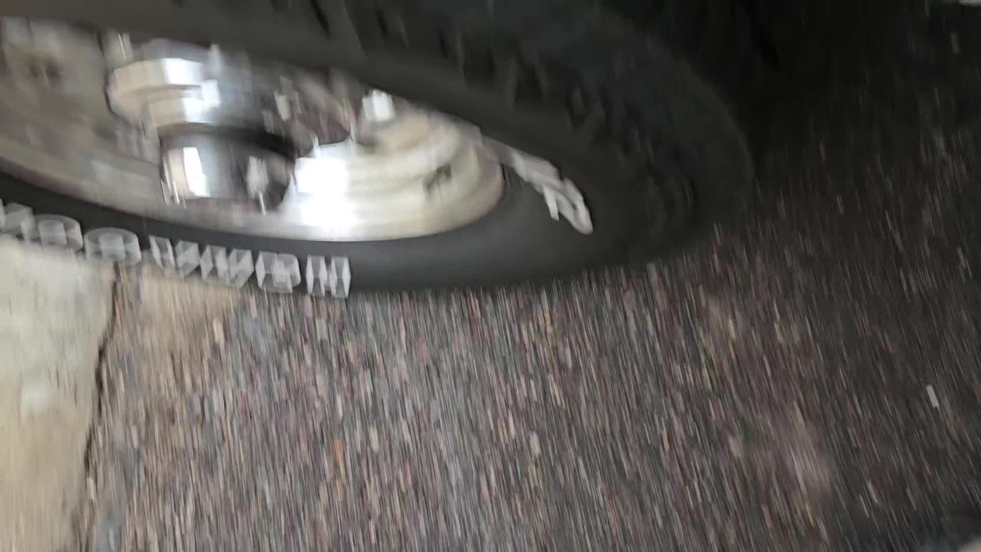

Maybe this is a better audio. I am concerned about the howling, I noticed it when we had some major cold here I. Colorado Springs.

The most dominant sound (howling sound) could be a couple of things. If you have a helper in the vehicle while you are outside, first have them turn the steering left and right to see if that sound changes. If it doesn't, have the helper shift in and out of gear to see if that changes.
