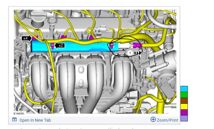

Where is the fuel rail sensor located on the car listed above SE model? I'm also struggling to locate the fuel pressure sensors. I've been told there are high and low fuel pressure sensors as well as a fuel rail sensor. None can be located. Please help and also provide directions and diagrams, if possible. Thank you in advance for any help provided!

I believe the fuel rail pressure sensor is right where the fuel line connects to the fuel rail. Actually, the fuel line has a quick connect where it attaches to the sensor, and the sensor is attached to the rail. (see pic below)
Unless you are referring to the fuel tank pressure sensor. That is located at the top of the fuel tank.
See pic below.
