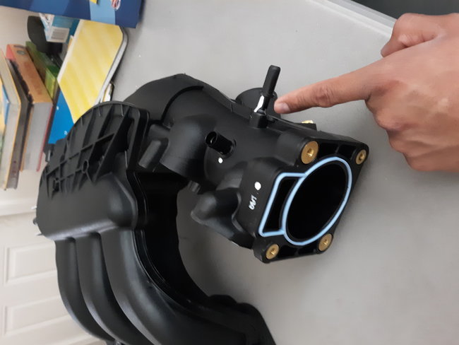

So, i'm having a hard time finding the small plastic clip that goes here. i'm not sure if I will have to buy the whole hose as an assembly or does it come individually?

ASALVICIO
Here it is:
May 14, 2020 at 9:49 AM

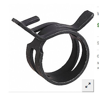

That appears to be the evap return line for the intake manifold. That should just use a tension clamp as pictured below. However, if it has a push clip that is part of the hose, then they are available as well. They are called fuel line clips and are in the second picture. Let me know if one of these are what you are looking for. If not, send a picture of the line that goes there and I can get a better idea. Thanks
