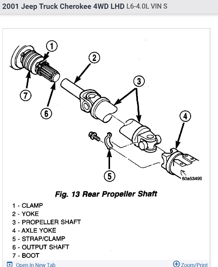

I have the u joint replaced on the driveshaft just fine. However, the spindle where the u joint sits to the rear axle, where the brackets are, the bolts from the old brackets or broken in the holes. I'm using a screw extractor kit, but I'm not really making any progress. This is day 3 that I'm under the vehicle and nothing seems to be making a difference. What am I doing wrong?

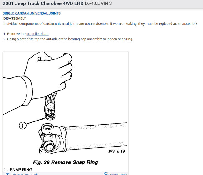

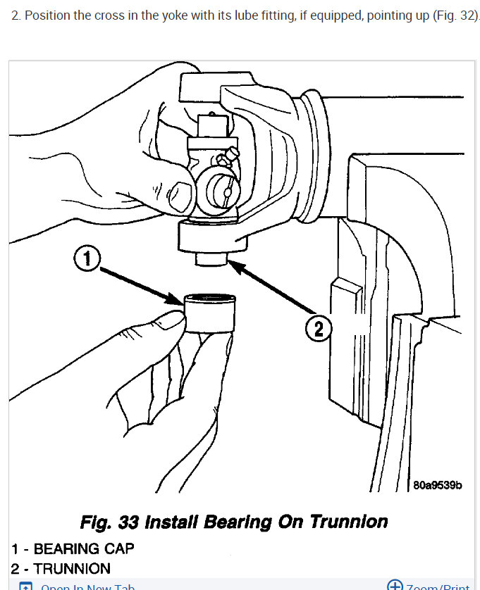

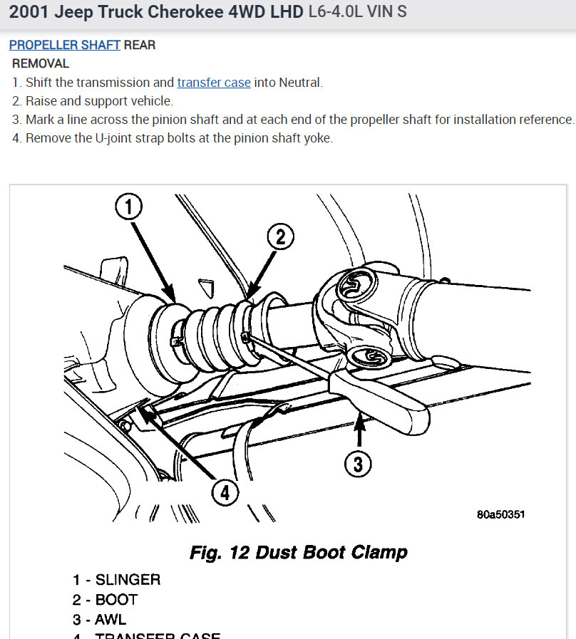

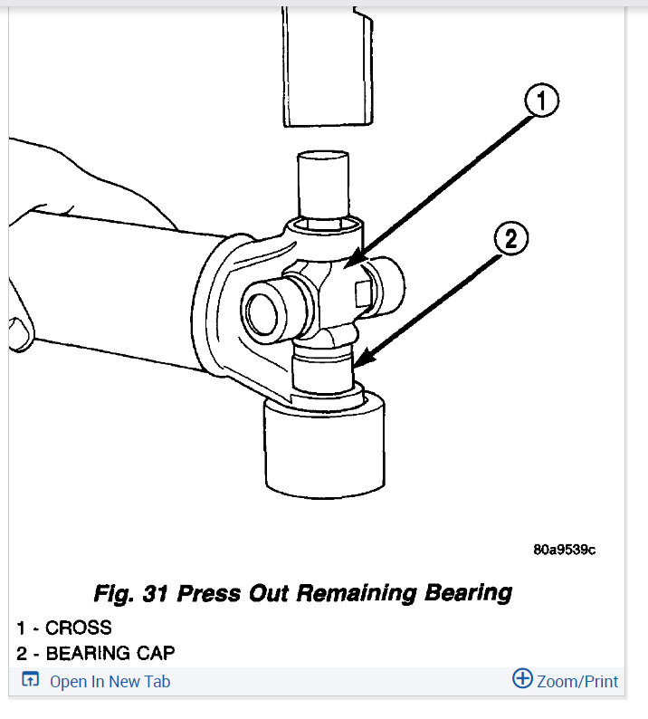

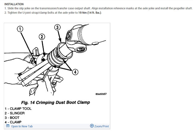

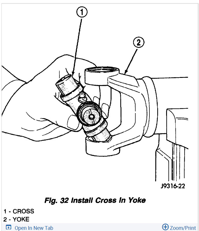

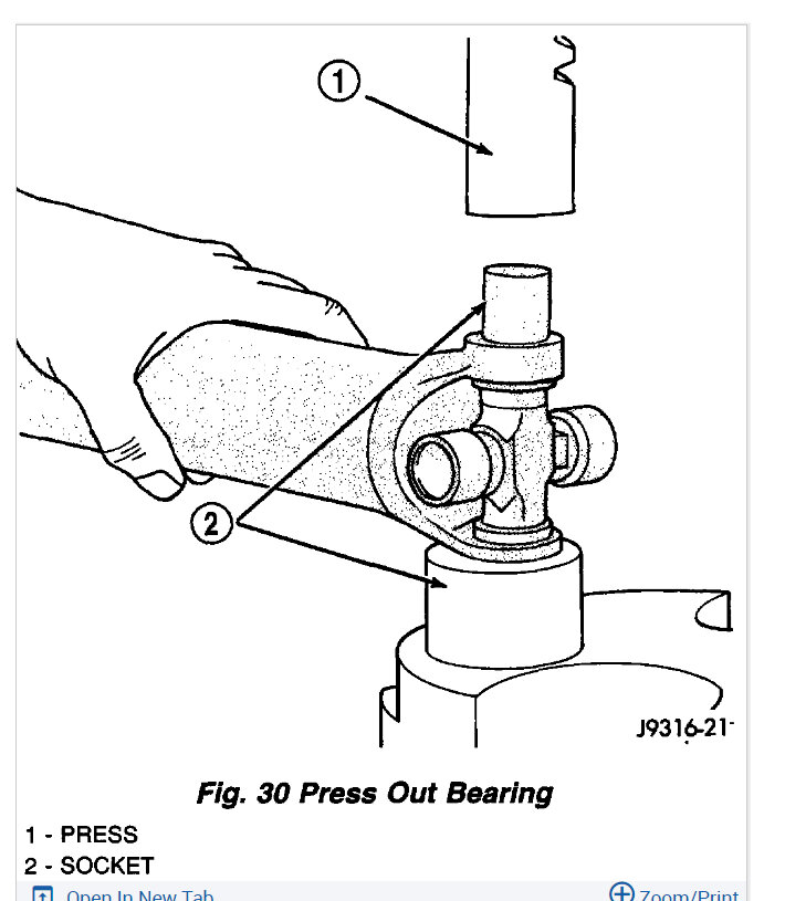

It sounds like the U joint cup retainer mounting bolts have broken. Here are videos on how to extract or drill out the broken bolts:
https://youtu.be/py-rIWATchY?si=diGqbrUBSyf87TZO
and
https://youtu.be/YDt5OUIZTs0?si=AM_uoLt7a3i_MFDe
Also, here is how to remove the driveshaft to avoid any confusion. Check out the images (below). Please upload pictures or videos in your response to the problem so we can see what's going on.
