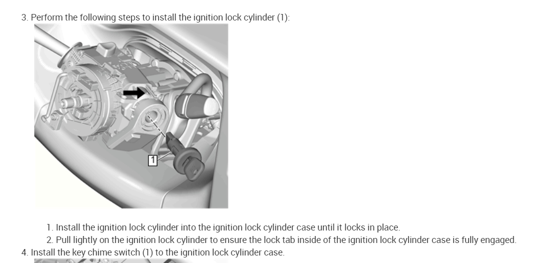

U-Haul truck had been stolen and recovered?
236 MILES • 6.0L • V8 • AUTOMATIC
HOTDOG777
The key does not have a chip and there is no key fob. It says service theft deterrent system and doesn’t crank over. How can I reset it?

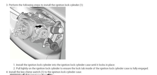

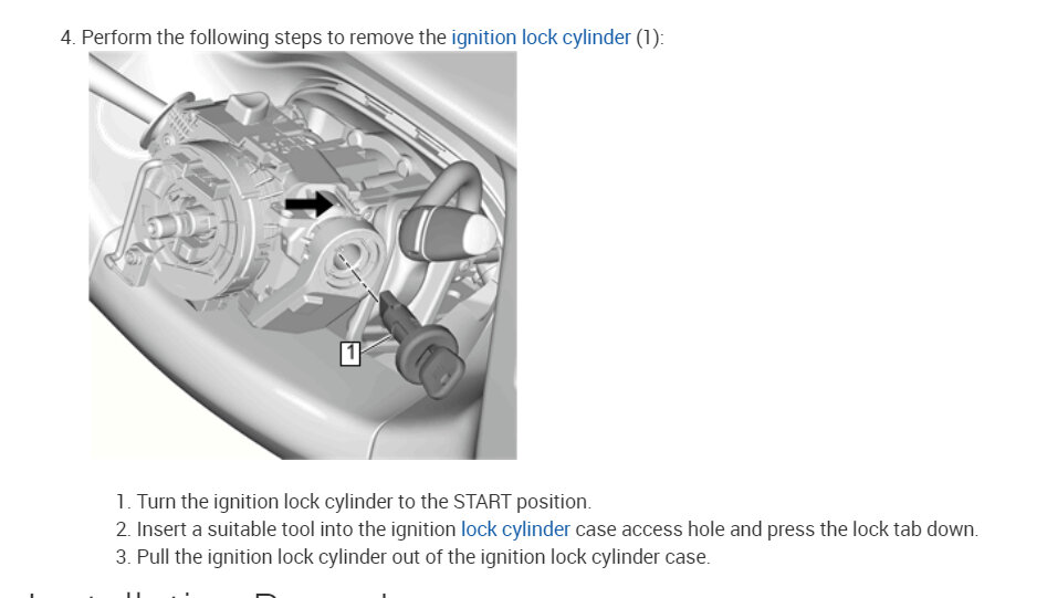

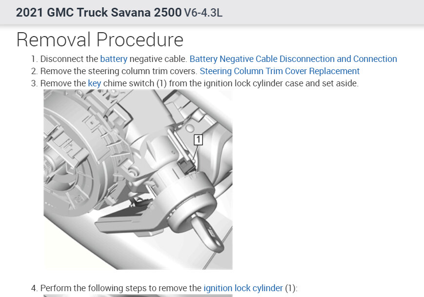

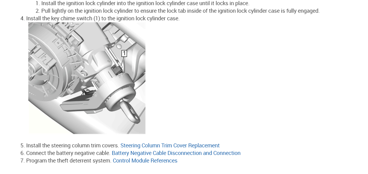

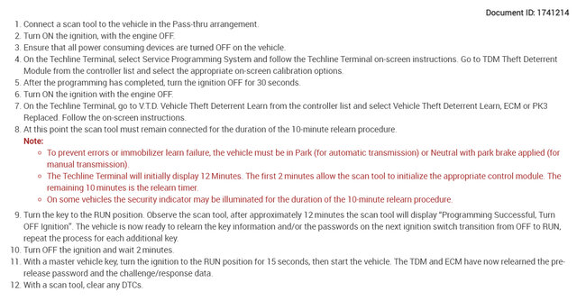

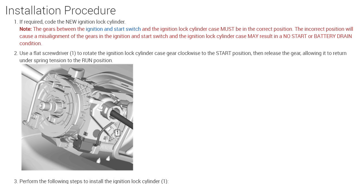

The key does have a chip in it, is the security light flashing when you crank it over? If so, the ignition switch must be coded to the van before it will run. here are the instructions on how to do the job in the images below. Check out the images (below). Let us know what happens and please upload pictures or videos of the problem.
