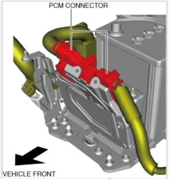

I would get a preprogrammed unit by searching Google or Ebay. Here is the location next to the battery so you can swap it out. Also, I would check the PCM electrical connectors for corrosion. Check out the images (below). Please upload pictures or videos in your response of any problems

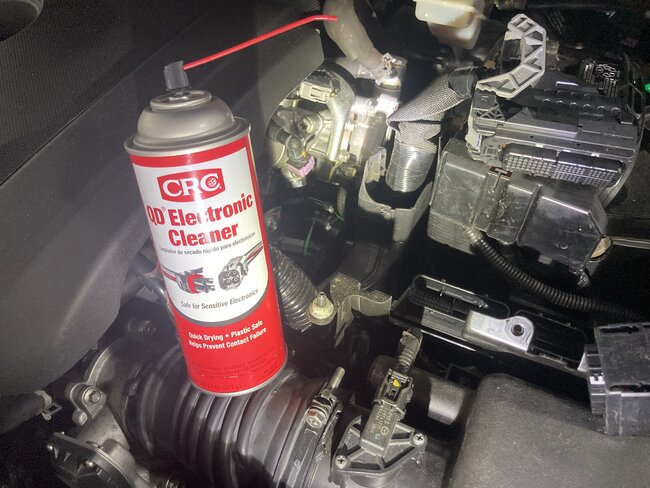

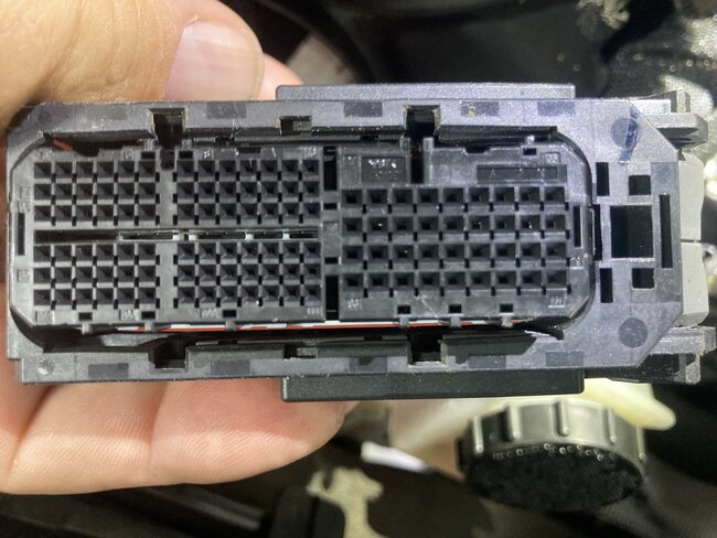

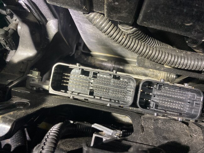

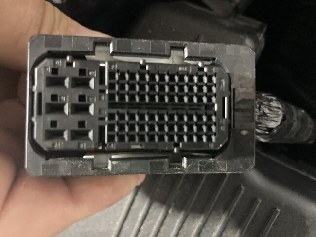

Appreciate your input Ken. I did pull the PCM connectors off and check for any pin irregularities. Didn't find any, and used electrical contact cleaner on both sides of each connection, with a little compressed air to ensure they were dry.
Also, I did see in some detailed Mazda shop manual pages the U0415-68 code links the m/c brake pressure sensor to decision circuitry inside the PCM. Wonder if that circuitry went flaky, and this is the culprit. I haven't had any individual wheel speed sensor codes ever and the integrated safety cameras and front grill LIDAR work just fine reporting lane departures, speed adjustable cruise control and emergency braking.
Couple of pics on the PCM connectors below.

Yep, those electrical connectors look okay. I am still thinking PCM due to the:
Invalid data received from ECM/PCM 'A' no sub type information
This is telling us there is no or corrupted data coming from the PCM.
