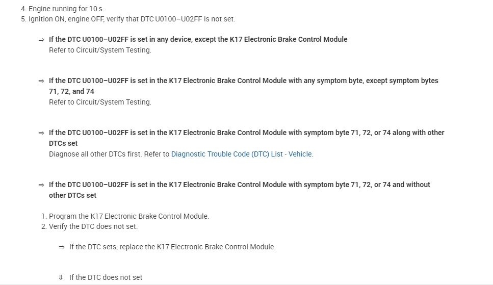

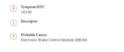

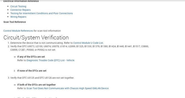

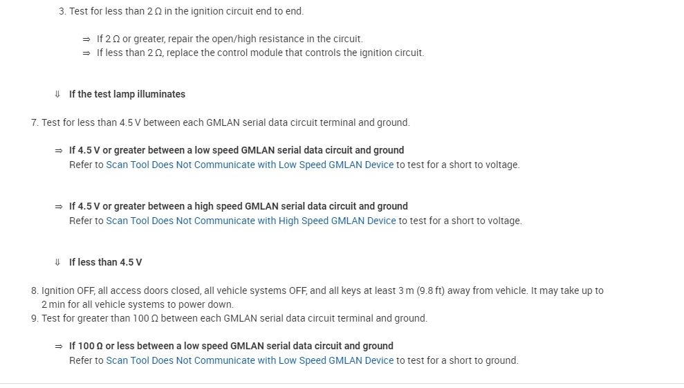

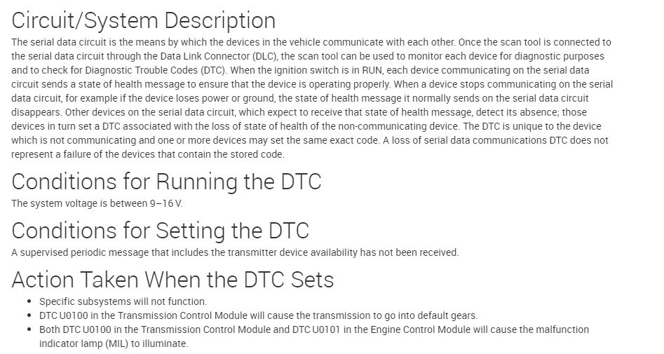

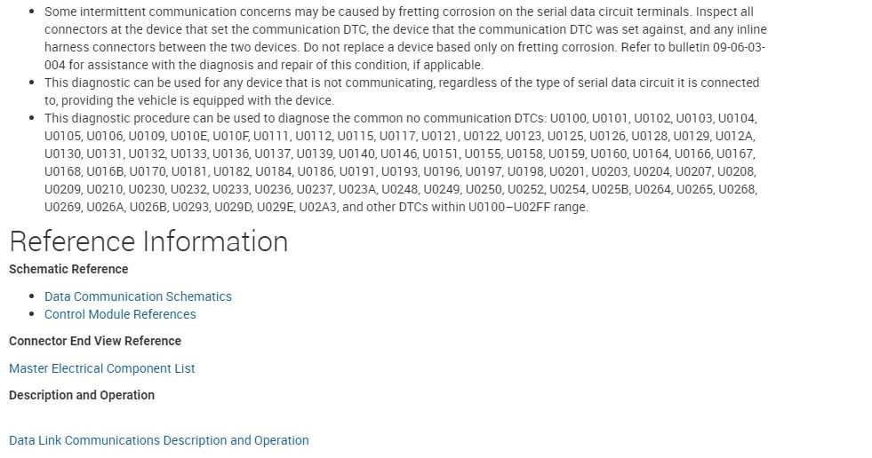

Good afternoon,

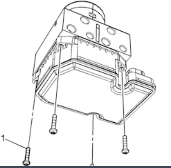

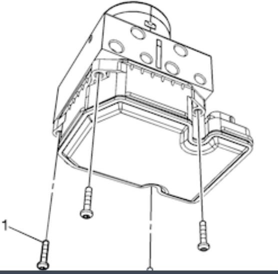

This is a communication code. It indicates the ABS module is not communication and that may be the issue with the no start as it has taken down the serial data line of communication with all the modules.
I would disconnect the Harness from the ABS module and see if it starts.

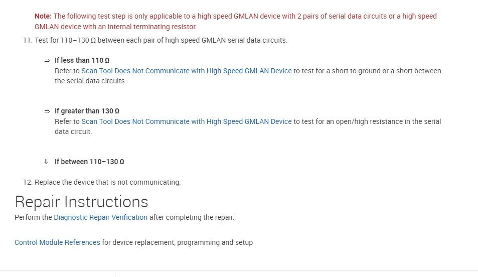

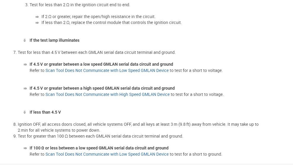

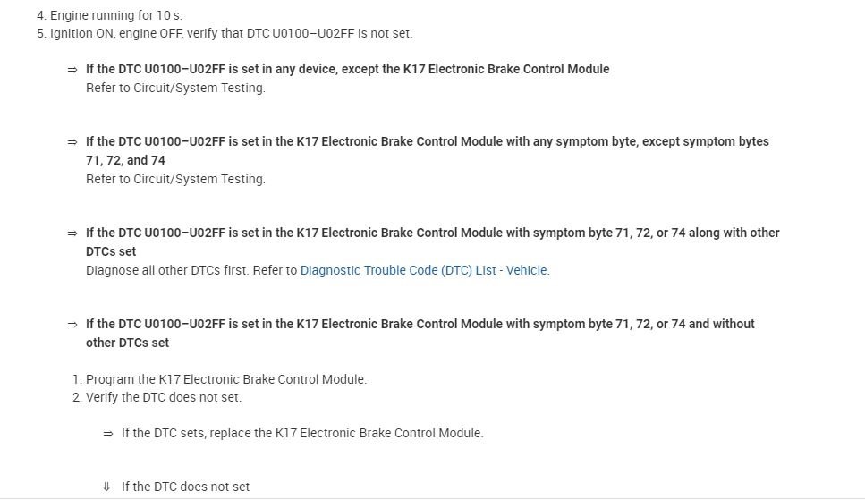

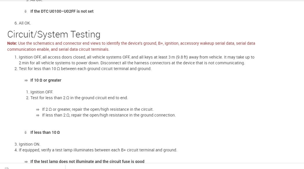

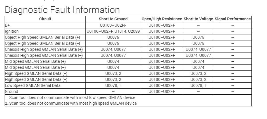

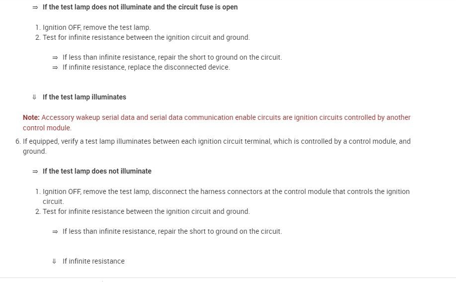

I attached the flow chart below for it. You will need a scan tool to follow the steps.
