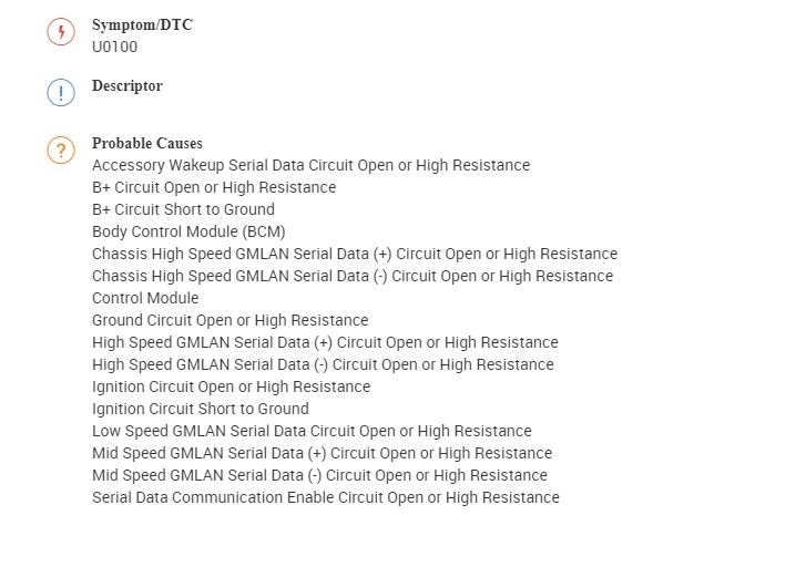

Code U0100
2011 GMC ACADIA
159,000 MILES • 2.4L • V6 • 2WD • AUTOMATIC
JULIUS FANTROY
Turned ignition switch to on and I hear a clicking sound in my transmission.
Mar 29, 2020 at 11:59 PM
Good morning.
That is a self test for the solenoids when the key is turned on.
Do you have an issue with the transmission?
Circuit/System Description
The serial data circuit is the means by which the control modules in the vehicle communicate with each other. Once the scan tool is connected to the serial data circuit through the data link connector (DLC), the scan tool can be used to monitor each control module for diagnostic purposes and to check for diagnostic trouble codes (DTCs). When the ignition switch is in RUN, each control module communicating on the serial data circuit sends a state of health (SOH) message to ensure that the control module is operating properly. When a control module stops communicating on the serial data circuit, for example if the control module loses power or ground, the SOH message it normally sends on the serial data circuit disappears. Other control modules on the serial data circuit, which expect to receive that SOH message, detect its absence; those control modules in turn set a DTC associated with the loss of SOH of the non-communicating control module. The DTC is unique to the control module which is not communicating and one or more control modules may set the same exact code. A loss of serial data communications DTC does not represent a failure of the control modules that contain the stored code.

Circuit/System Verification
1. Determine the control module that is not communicating. Refer to Control Module U Code List (See: A L L Diagnostic Trouble Codes ( DTC ) > Diagnostic Trouble Code Descriptions > Control Module U Code List).
2. Verify that DTC U0073, U2100, U0074, U1814, U2099, B1428, B1370, B1380, B1440, B1441, B1325, or P0562 is not set.
If any of the DTCs are set, refer to Diagnostic Trouble Code (DTC) List - Vehicle (See: A L L Diagnostic Trouble Codes ( DTC ) > Diagnostic Trouble Code Descriptions > Diagnostic Trouble Code (DTC) List - Vehicle).
3. Engine running for 10 seconds.
4. Ignition ON, engine OFF, verify that DTC U0100-U02FF is not set with symptom byte 00.
If the DTC U0100-U02FF is set with symptom byte 00, refer to Circuit/System Testing.
5. Verify that DTC U0100-U02FF is not set with symptom byte 71 or 72.
If the DTC U0100-U02FF is set with symptom byte 71 or 72 along with other DTCs set, diagnose all other codes first. Refer to Diagnostic Trouble Code (DTC) List - Vehicle (See: A L L Diagnostic Trouble Codes ( DTC ) > Diagnostic Trouble Code Descriptions > Diagnostic Trouble Code (DTC) List - Vehicle).
If the DTC U0100-U02FF is set with symptom byte 71 or 72 and without other DTCs set, reprogram the control module. If the DTC resets, replace the control module.
Note: Use the schematic to identify the following:
Control modules the vehicle is equipped with
Control module locations on the low and high speed GMLAN serial data circuits
The control modules B+, ignition, ground, communication enable and serial data circuit terminals
1. Ignition OFF, disconnect the harness connector at of the control module that is not communicating.
2. Test for less than 10 ohm between each ground circuit terminal and ground.
If greater than the specified range, test the ground circuit for an open/high resistance.
3. If equipped, ignition ON, verify that a test lamp illuminates between each B+ circuit terminal and ground.
If the test lamp does not illuminate, test the B+ circuit for a short to ground or an open/high resistance. If the circuit fuse is open, test the control circuits of the control module for a short to ground. If the circuits test normal, replace the control module.
4. If equipped, ignition ON, verify that a test lamp illuminates between each ignition circuit terminal and ground.
If the test lamp does not illuminate, test the ignition circuit for a short to ground or an open/high resistance. If the circuit fuse is open, test the control circuits of the control module for a short to ground. If the circuits test normal, replace the control module.
Note: Only the high speed GMLAN modules have a serial data communication enable circuit OR an accessory wakeup serial data circuit, and the body control module is the output for these circuits. Refer to the control module schematics to identify which modules have these circuits.
5. If equipped, ignition ON, verify that a test lamp illuminates between the communication enable circuit terminal OR the accessory wakeup circuit terminal and ground.
If the test lamp does not illuminate, test the entire circuit, including the B+ circuit to the K9 body control module (BCM), for an open/high resistance or short to ground. If the circuits test normal, replace the K9 BCM.
6. Ignition OFF for 60 seconds, test for less than 5 ohm between the serial data circuit terminals and the appropriate X84 data link connector (DLC) terminal listed below:
Class 2 serial data circuit terminal 2
Low speed GMLAN serial data terminal 1
High speed GMLAN serial data terminal 6 or 14
Mid speed GMLAN serial data terminal 3 or 11
Chassis high speed GMLAN serial data terminal 12 or 13
If greater than the specified range, test the serial data circuit for an open/high resistance between the non communicating control module and a module setting the DTC or a serial data splice pack.
7. If all circuits test normal, replace the control module that is not communicating.
