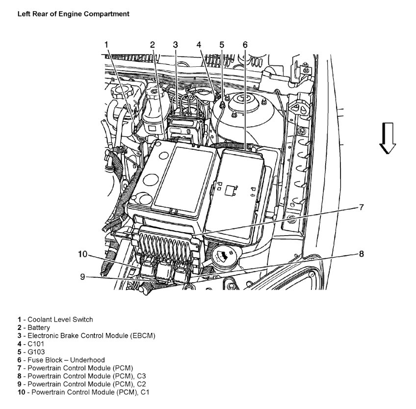

This is what is coming up on the scan tool “U0100” .
Oct 29, 2018 at 8:47 AM
  • 55,746 POSTS
Yes it means the CAN or computer is down. I would try to find a used computer and plug it in. Check out the diagrams (below). Please let us know what happens.
