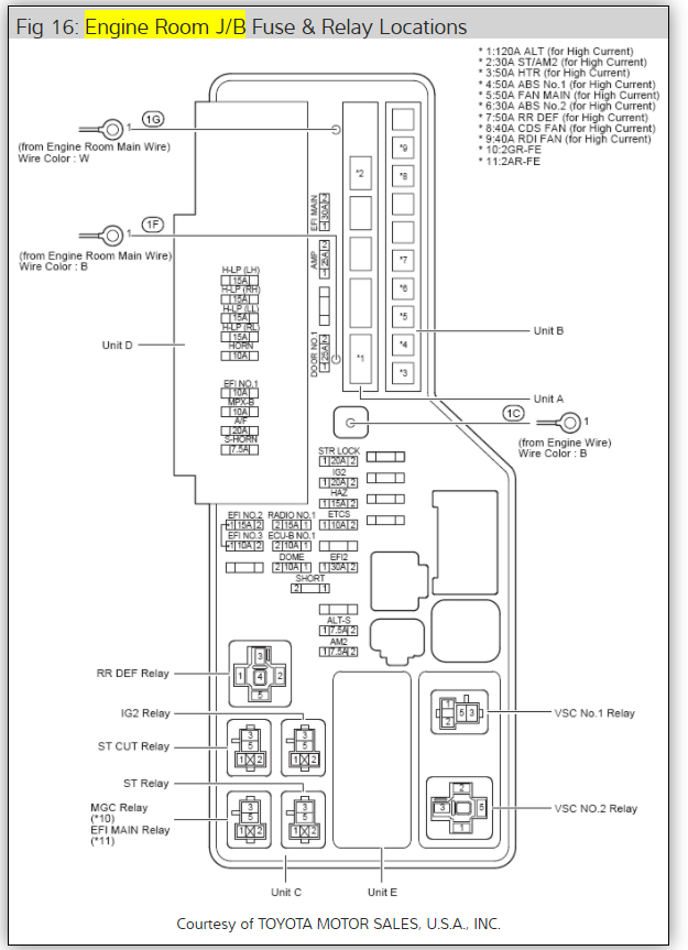

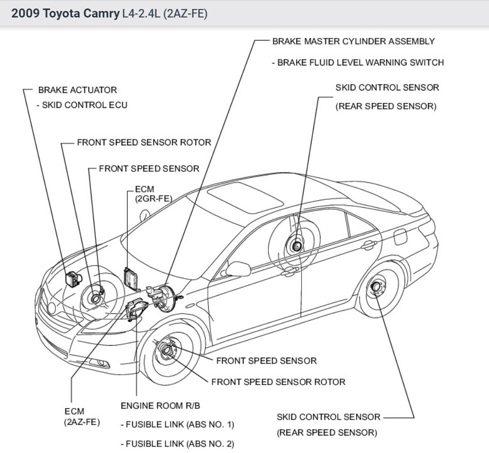

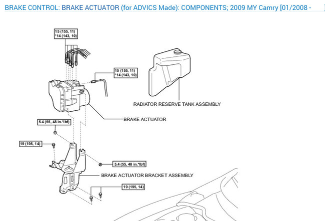

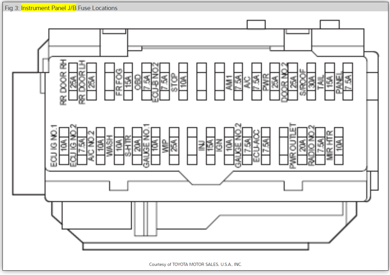

U0073 code?
2009 TOYOTA CAMRY
80,828 MILES • 4 CYL • 2WD • AUTOMATIC
FABIAN CHARLTON
  • 53 POSTS
I have the this code up along with 2 TPMS error that I know I need to change pressure sensor. Battery perhaps. The u0073 error is showing in the ABS module on Innova scanner.
Oct 21, 2022 at 1:01 PM
  • 55,423 POSTS
The U0073 code is for the lost communication with the ABS module. I would check the fuses first and if okay replace the module.
Here is how in the images below:
Check out the images (below). Please let us know what happens
