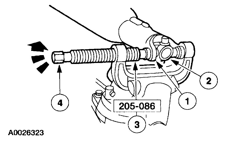

I'm in a really desperate need to replace my driveshaft u-joints by next weekend. I pretty much know how to get the shaft off the rear axle and slide it out from the transmission (after I mark it's positions) but my challenge comes after removing the snap rings, a lot of people use a ball joint press and an impact to get the caps out of the ports. but I really don't want to go that route and buy extra equipment I more than likely will never use again. I know there's loan a tool but they either don't have the press or there's pieces missing from it. I was hoping it was possible to gently knock them out with a rubber mallet or some other way, or maybe if there being a trick to it. can you guys help me? Thanks!

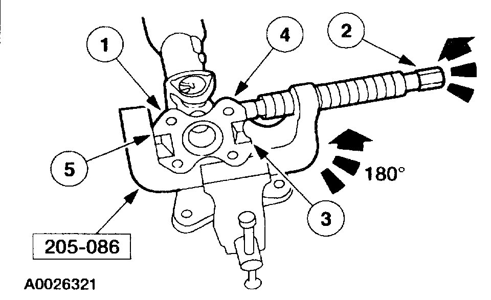

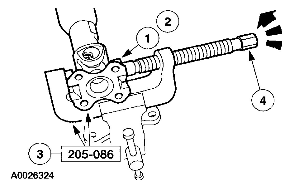

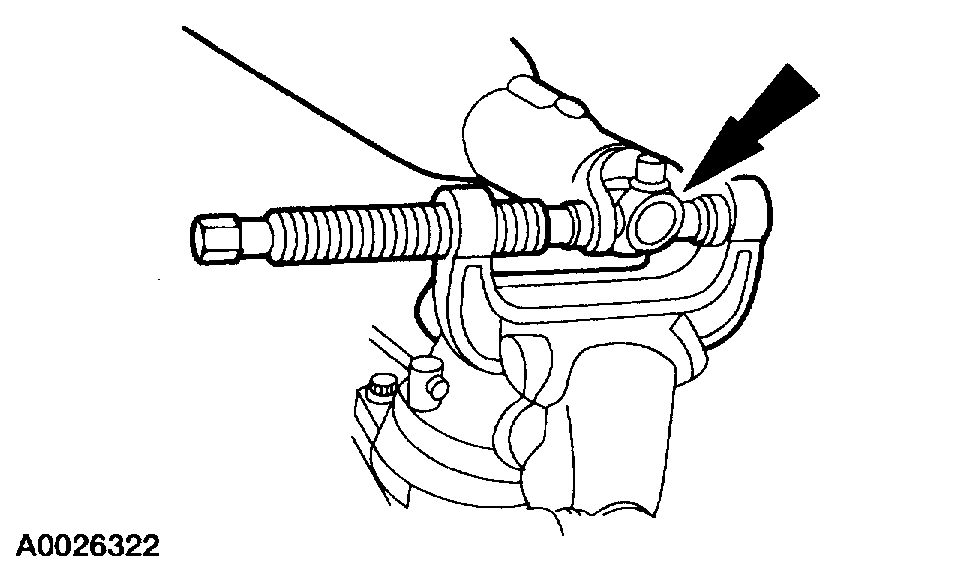

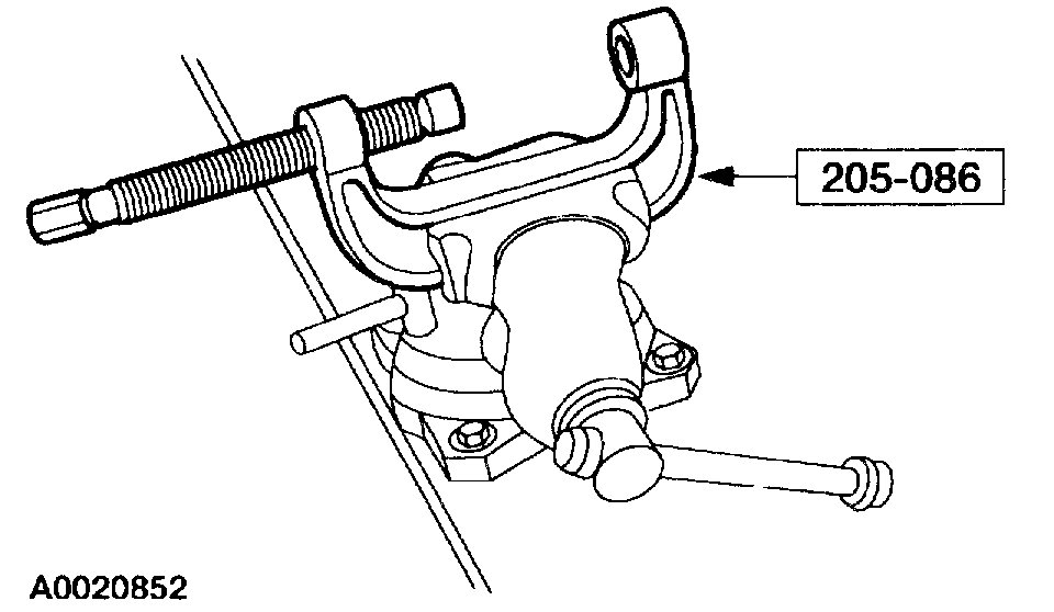

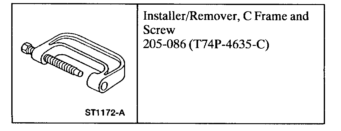

Honestly, you need a good C-Clamp. I have also used a vise and two sockets. Once that is slightly smaller in diameter than the end cap on one side and one that is larger that the outside diameter. Using a vise, I place the sockets on the joint. And by tightening the vice, the smaller socket will force the end cap into the bigger socket. Honestly, you won't get them out with a rubber mallet.
Here are the directions specific to replacement using the C-clamp or a c frame screw as described in the directions. The attached pics correlate with the directions.

Special Tool(s)

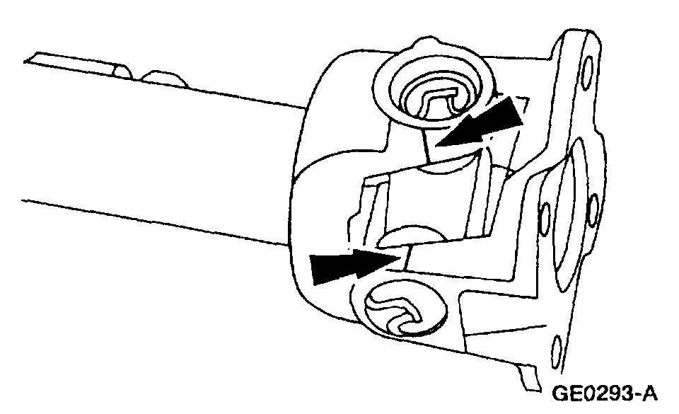

1. CAUTION: Do not, under my circumstance, damp the driveshaft in the jaws of a vise or similar holding fixture Denting or localizing fracture can result, causing driveshaft failure during vehicle operation.
Place the driveshaft on a suitable workbench. Do not damage the tube.
2. NOTE: If components are not marked and installed incorrectly, driveline imbalance can occur.
Index-mark the driveshaft components.
3. Remove and discard all four of the snap rings.
4. Clamp the special tool in a vise.
Bearing cup removal
5. NOTE: If necessary, use a pair of pliers to remove a bearing cup that fails to press out all the way.
Remove the bearing cups and the flange.
1 Position the flange in the special tool.
2 Press out a bearing cup.
3 Rotate the flange 180 degrees.
4 Press on the spider to remove there main bearing cup.
5 Remove the flange.
Final disassembly
6. Repeat Bearing cup removal in this procedure to remove the remaining bearing cups and the spider from the driveshaft.

Assembly
Bearing cup installation
1. NOTE: Install the Universal Joint Kits as complete assemblies only. Do not mix components from other Kits.
Install a new spider and bearing cups.
1 Start a new bearing cup in the driveshaft yoke.
- Check the needle bearings for correct positioning.
2 Position the new spider in the driveshaft yoke.
3 Position the driveshaft yoke in the special tool.
4 Press the bearing cup to just below the snap ring groove.
- Repeat to install the new bearing cup on the opposite side of the driveshaft yoke.

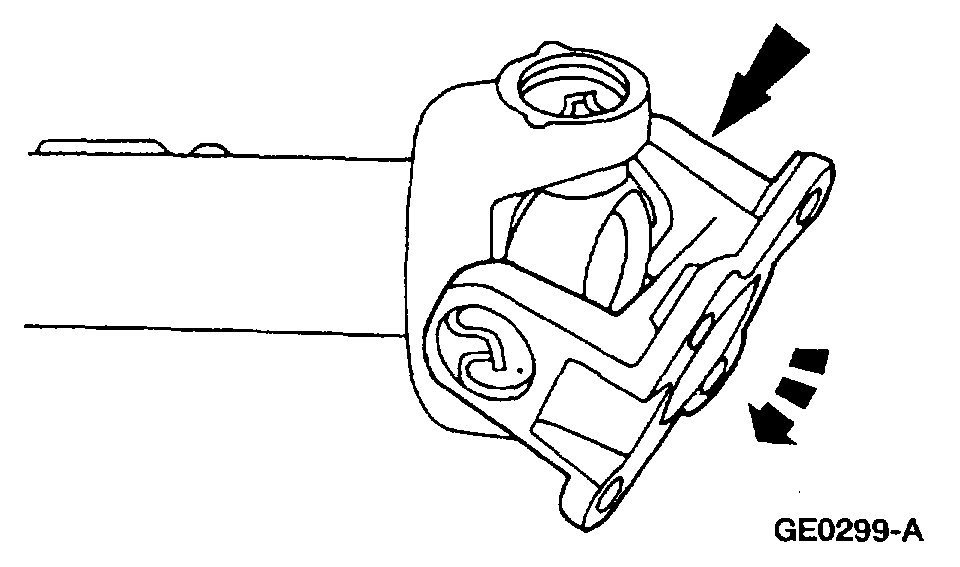

Flange installation
2. Inspect the flange. Install a new flange, if necessary.
3. Install the new bearing cups and the flange.
1 Start a new bearing cup in the flange.
- Check the needle bearings for correct position.
2 Position the flange on the spider.
3 Position the assembly in the special tool.
- Repeat to install the new bearing cup on the opposite side of the flange.

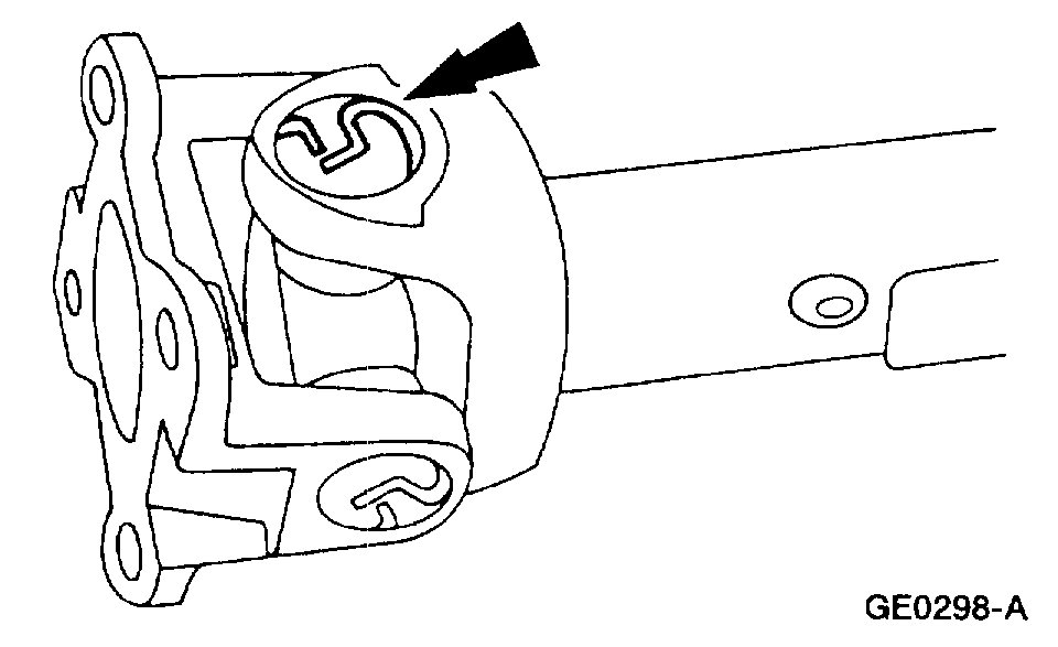

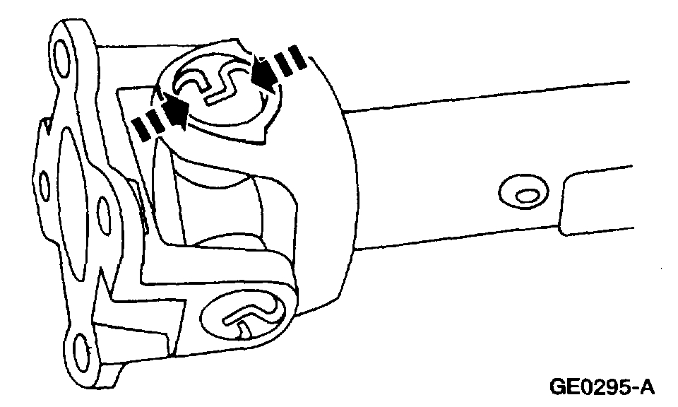

Final assembly
4. NOTE: Use the yellow snap rings supplied in the kit to assemble the universal joint (U-joint). If difficulty is encountered with the yellow snap Rings, install the black snap rings.
Remove the driveshaft from the special tool, and install the four new snap rings.
5. CAUTION: Do not strike the bearings. Check the U-joint for freedom of movement.
If binding, strike the yoke with a brass or plastic hammer.
