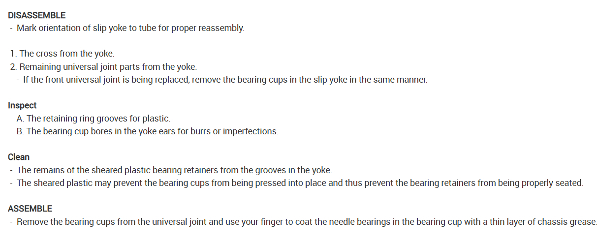

Hello I have the vehicle listed above and I am having to replace my rear u joint, but my pinion gear has a lot of movement.
Dec 4, 2024 at 12:06 PM
  • 55,214 POSTS

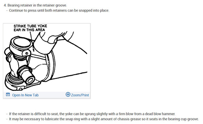

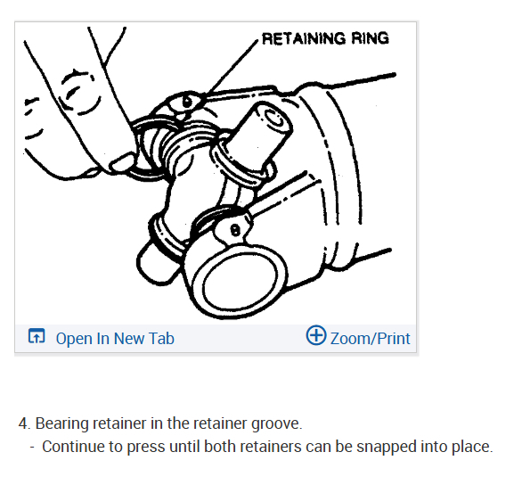

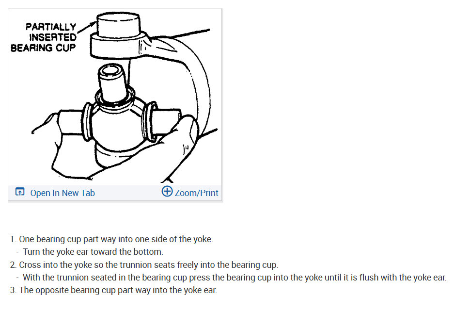

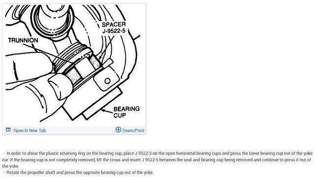

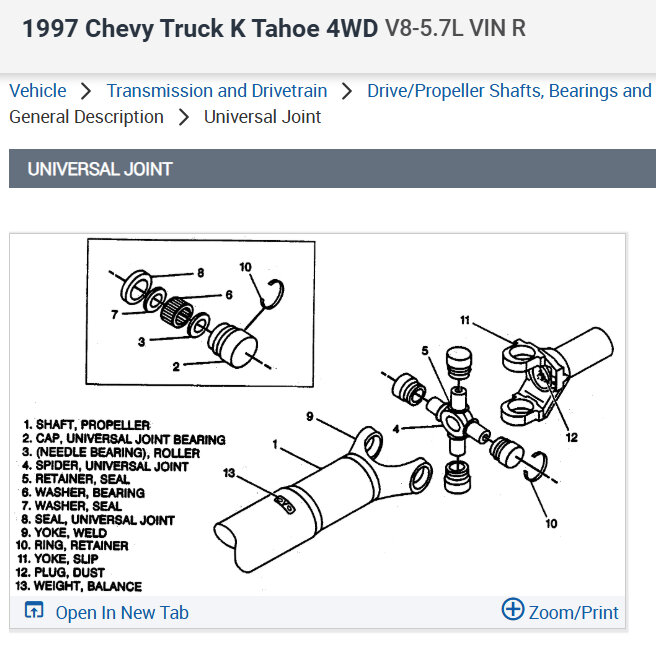

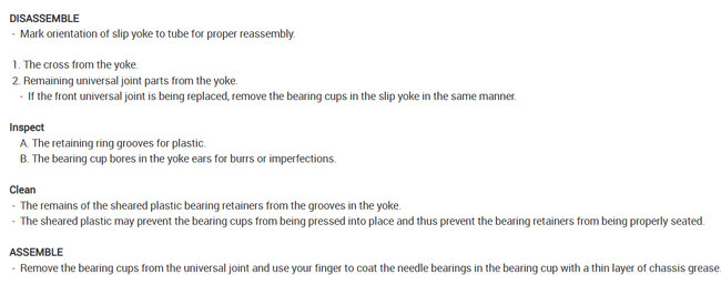

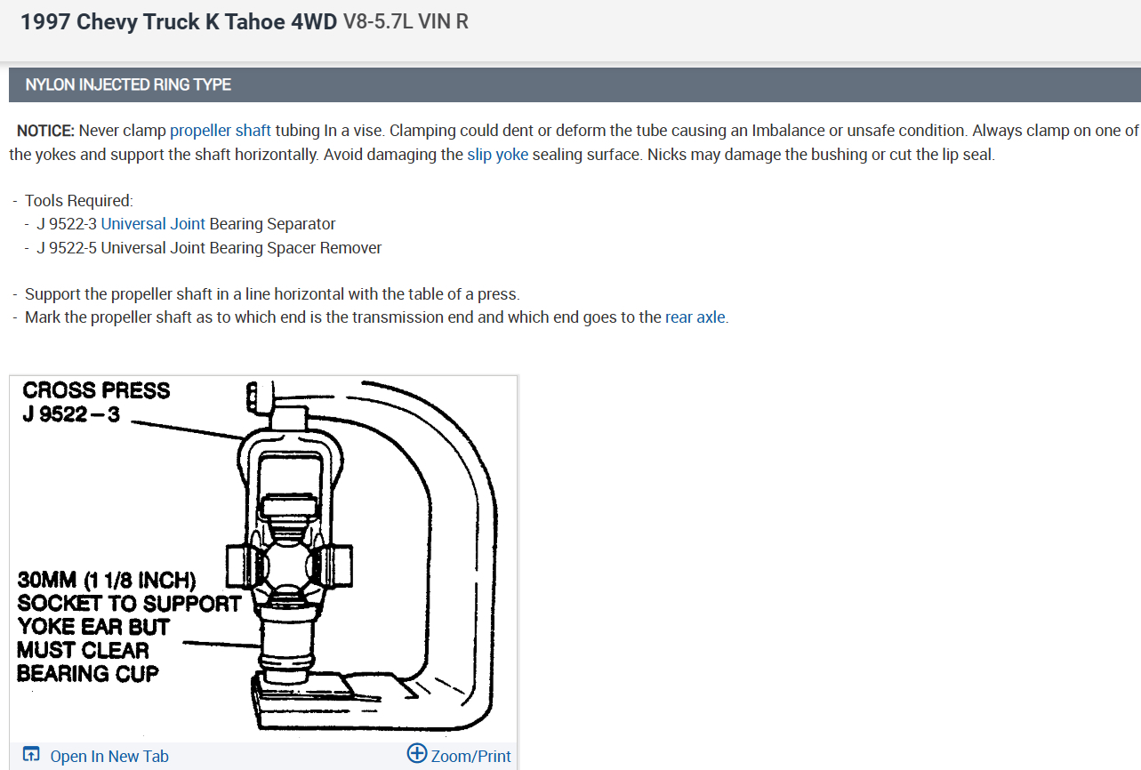

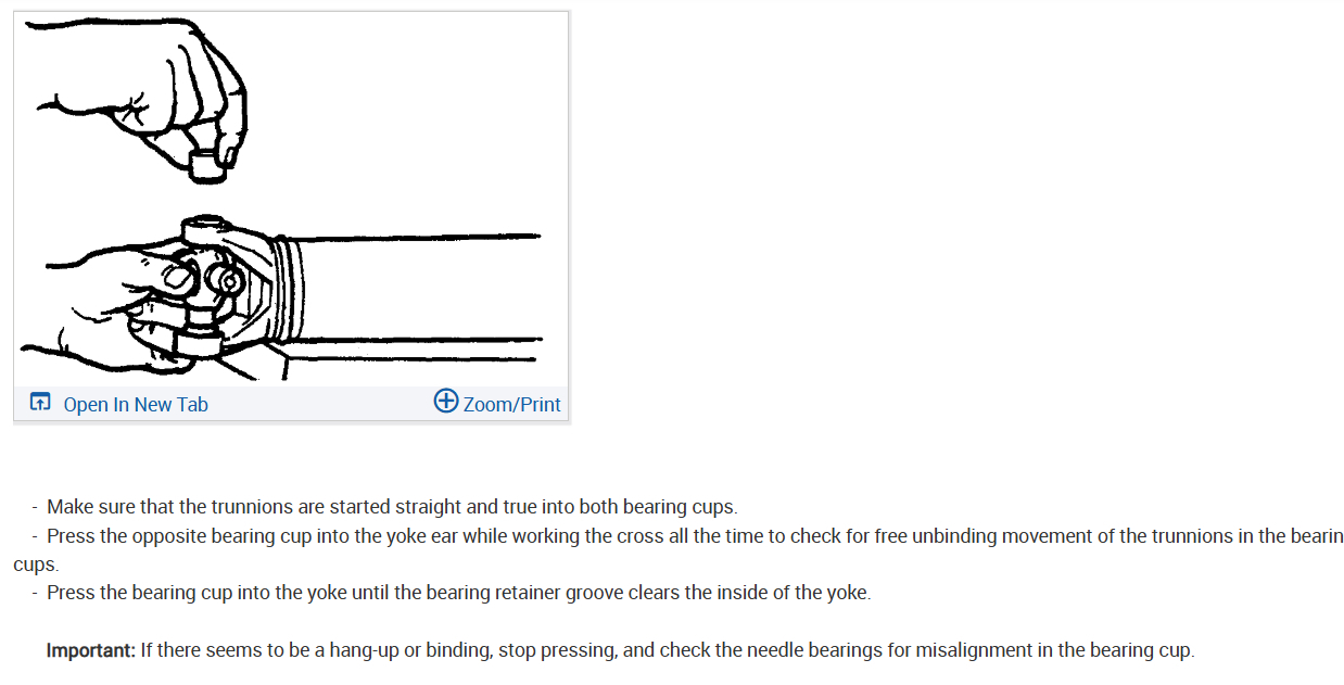

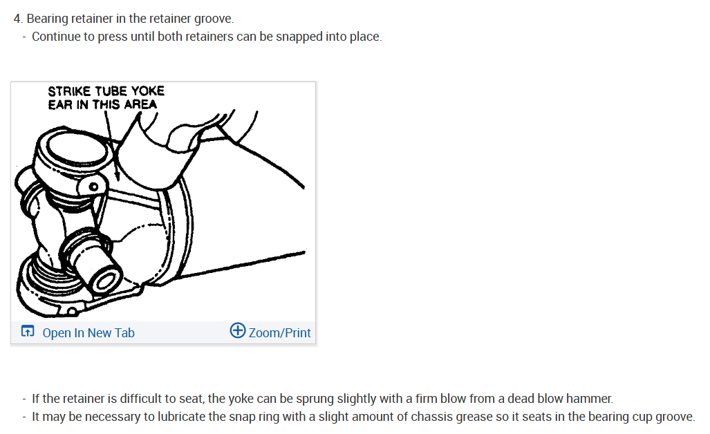

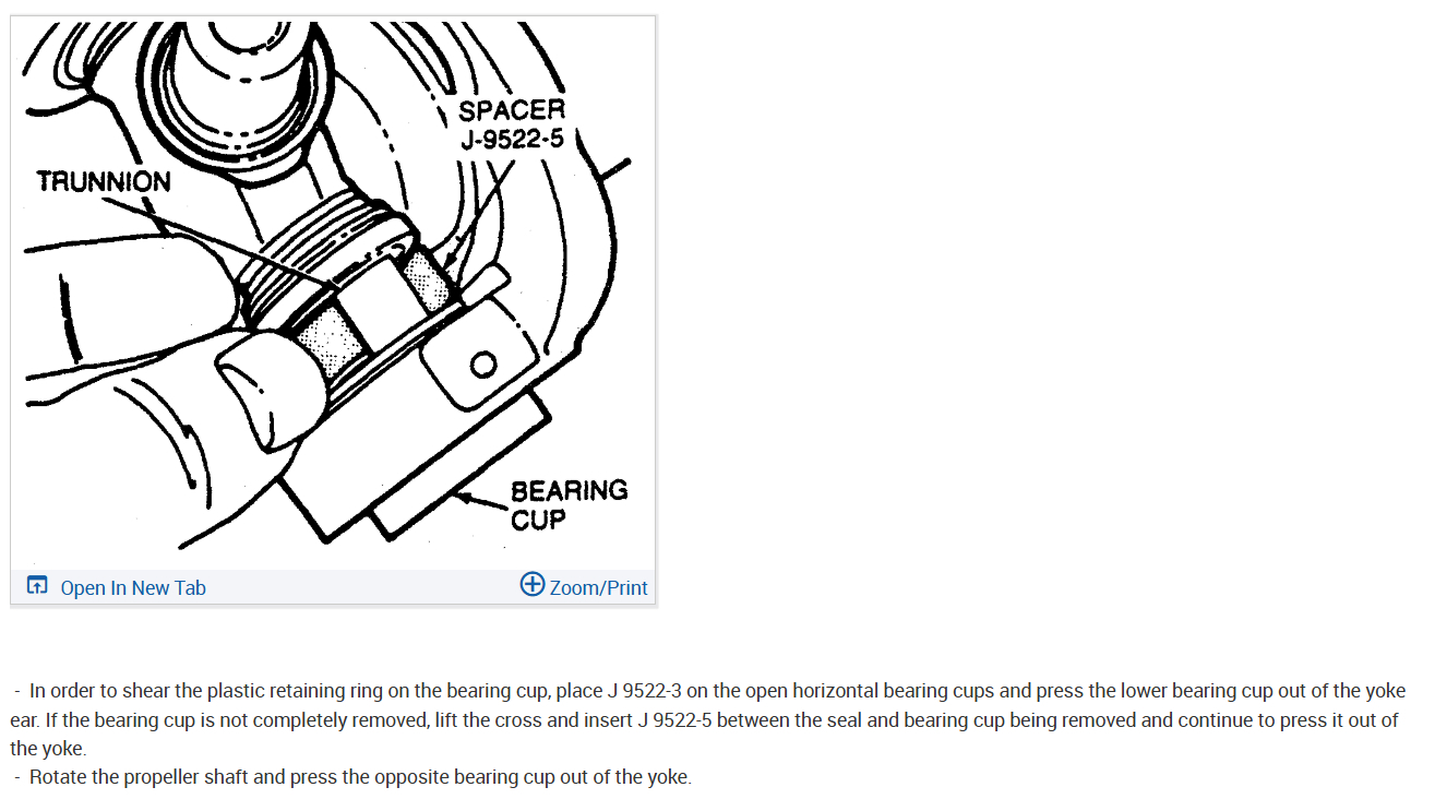

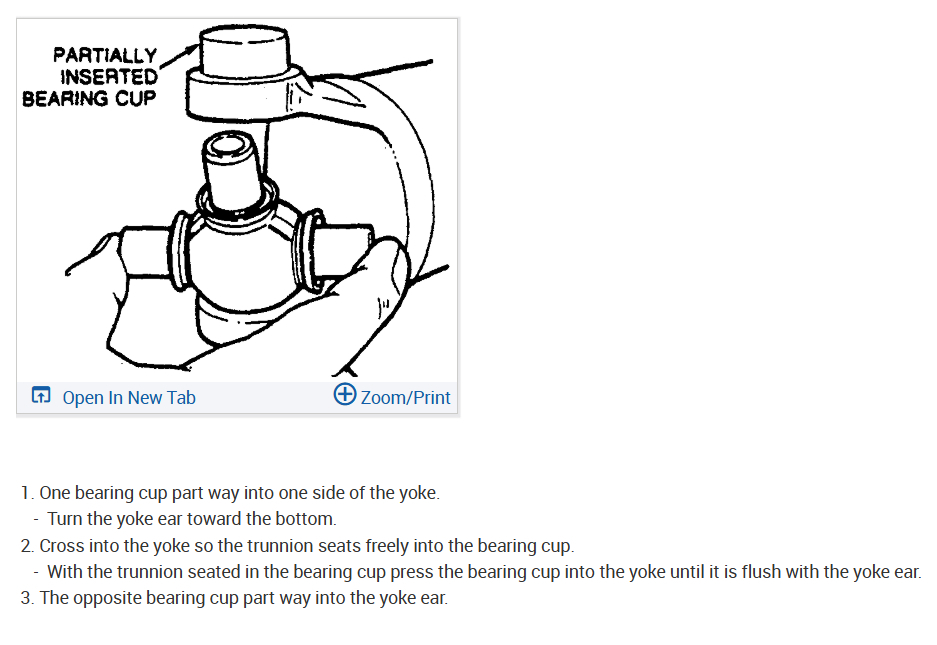

Can you upload a short video of the moment? Some movement is normal, can I ask of the rear end howls while driving? Here is a guide to help you change the U joints out:
https://www.2carpros.com/articles/how-to-replace-a-universal-u-joint
Here is how to replace the U joints on your truck. Check out the images (below). Please upload pictures or videos in your response of any problems so we can see what to help you with.
