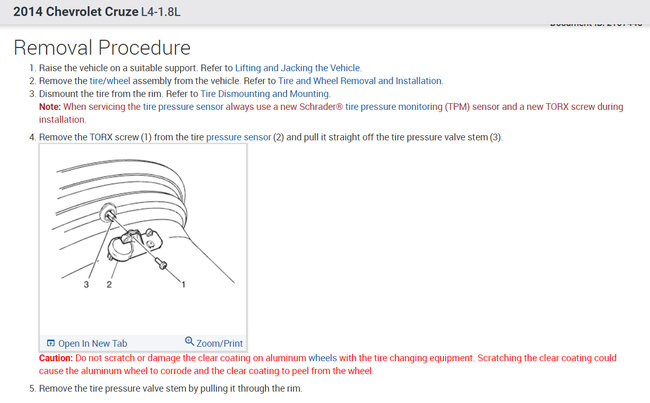

I have replaced my rear tires but the tyre pressure sensor light still stays on. what will be the problem?
May 18, 2021 at 1:40 AM
  • 55,399 POSTS

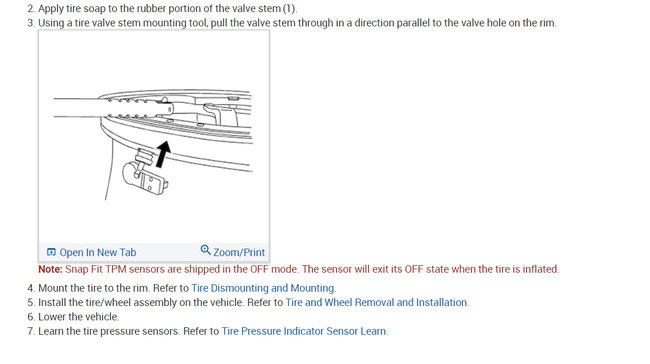

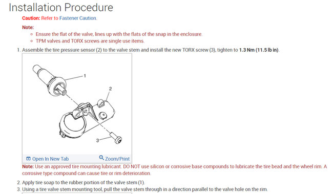

Yep, this happens when they damage the tire pressure sensor when changing the tires out which is common. Here are the instructions on how to change the tire pressure sensor out. Check out the diagrams (below). Let us know what happens and please upload pictures or videos of the problem.
