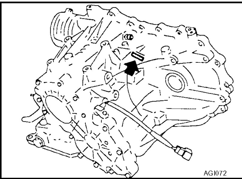

I want to know what transmission was put in this car off the assembly line.
2003 NISSAN ALTIMA
115,157 MILES • 3.5L • V6 • 2WD • AUTOMATIC
ZUNIGA512
Sep 8, 2019 at 8:57 AM
DANNY L
  • 5,648 POSTS
Hello, I'm Danny.
It's possible to have either the RE/RL4F03 or the RE4F04 transmission. I've attached a picture below showing where the transmission ID tag is located.Hope this helps and thanks for using 2CarPros.
