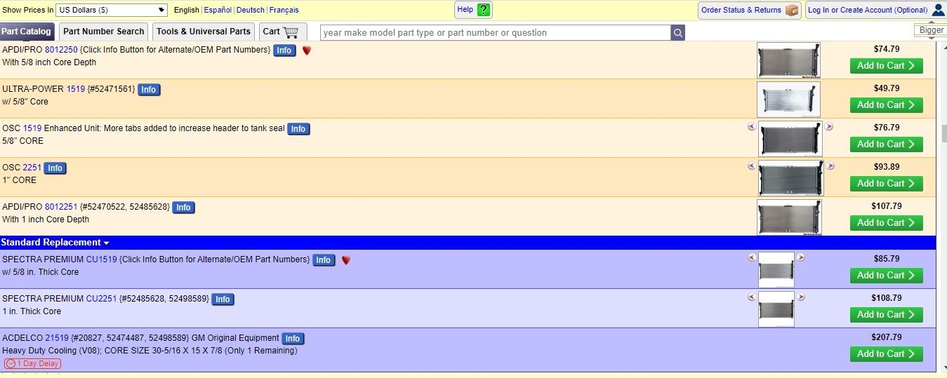

The car listed above is the LS model. May have possibly put a hole in the bottom of my radiator. if it needs replaced how do I find out what type of radiator I need to replace it? Car is not at my house right now so I cannot go out and just check and see without trying to find a ride and that's hard to do. I should have looked this morning when it happened but it was very early and still dark out. thanks in advance.
Oct 24, 2019 at 4:36 AM
Good afternoon,
There are 2 options for the radiator. They are both listed below. Rock auto has them both for you.
