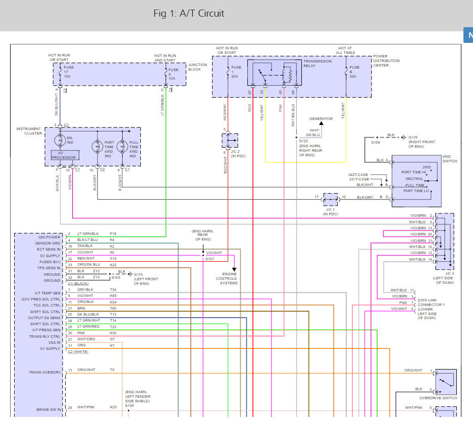

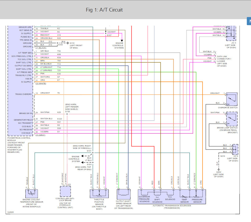

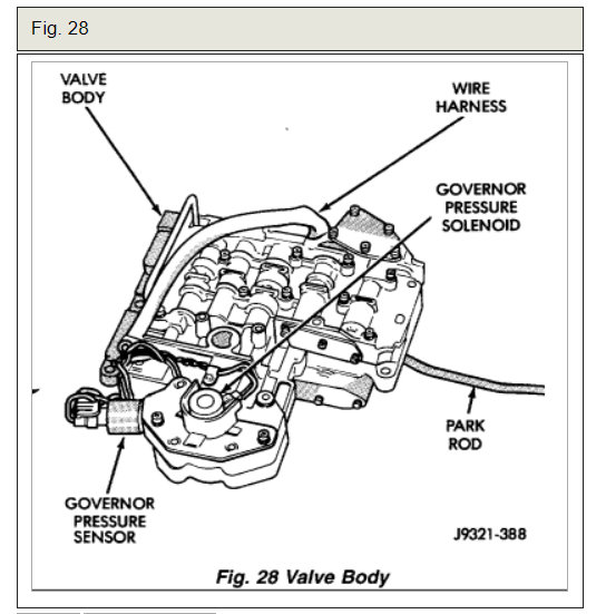

My transmission will not shift out of second, I assume, while in drive. I can reach about thirty mph but my rpm's run at like 3600-4000, it is supposed to shift around 2500, oddly it only happened while trying to go one direction on my road. when I went the other way after resetting my computer, it did fine, turned off vehicle, went inside, came back out, went back the other direction to go to gas station and it would not shift again. I did a filter kit fluid replacement, changed both transmission and rear end speed sensors (though my transmission sensor has bare wire which might be the cause I plan on fixing that today with electrical tape).
I read online about a transmission solenoid, could that also be part of the problem? What does this actually do?
