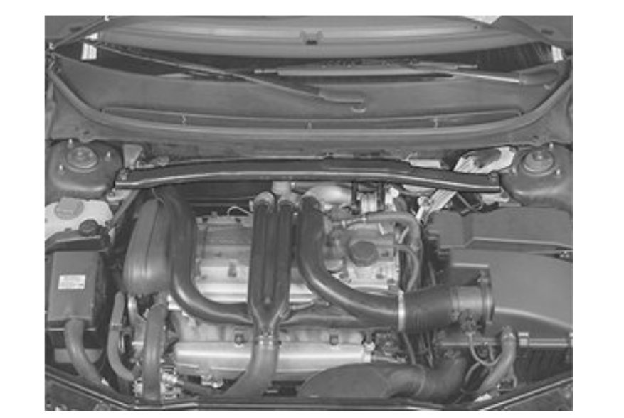

Preparation
imageZoom/Print
Remove the splash guard from under the engine.
Remove:
- the connectors for the heated oxygen sensors (HO2S)
- the wiring for the heated oxygen sensors (HO2S) from the mountings
- the screw for the mounting for the engine stabilizer brace on the engine
- the engine stabilizer brace between the suspension turrets
- the plastic charge air pipe. Place to one side
- the plastic intake pipe. Put it to one side.

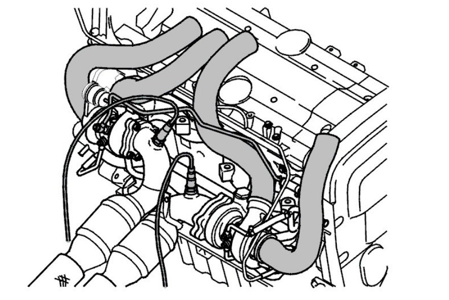

Removing components
imageZoom/Print
Remove:
- the intake and charge air pipes from turbocharger (TC)
- the heat deflector plates
- the upper heated oxygen sensors (HO2S)
- the expansion tank cap.

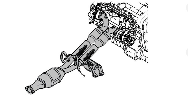

Removing three-way catalytic converters (TWC) / front exhaust pipe
imageZoom/Print
Remove:
- the nuts. Disconnect the front exhaust pipe from the turbocharger (TC)
- the nuts where the exhaust pipe divides downstream of the three-way catalytic converter (TWC)
- the center SIPS member.
Disconnect the brake pipe from the clips on the front SIPS member.
Remove the screws from the front SIPS member.
Slide the three-way catalytic converter (TWC) (with the heat deflector plate) back and then lower it.
Note! For tightening torques, see: Tightening torque See: Engine > Mechanical > Tightening Torque.
Note! To ensure that there is no exhaust leakage, see: Flanged joint, assembling See: Exhaust Pipe > Removal and Replacement > Flanged Joint, Assembling.

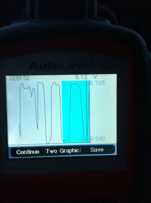

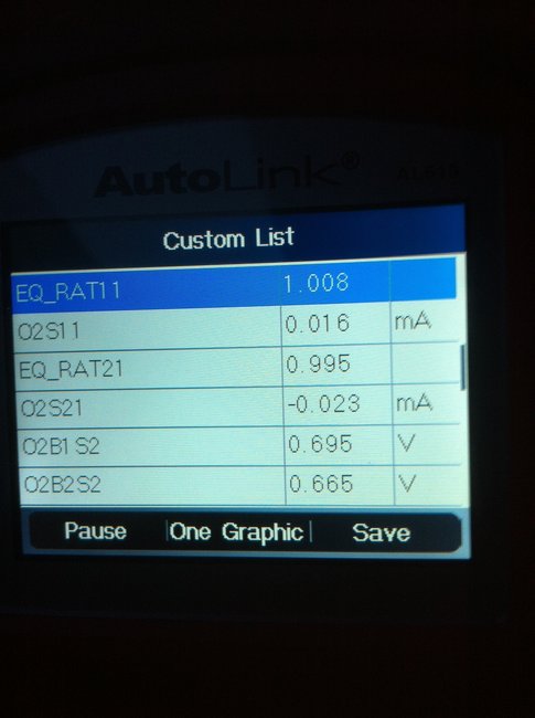

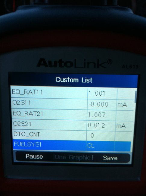

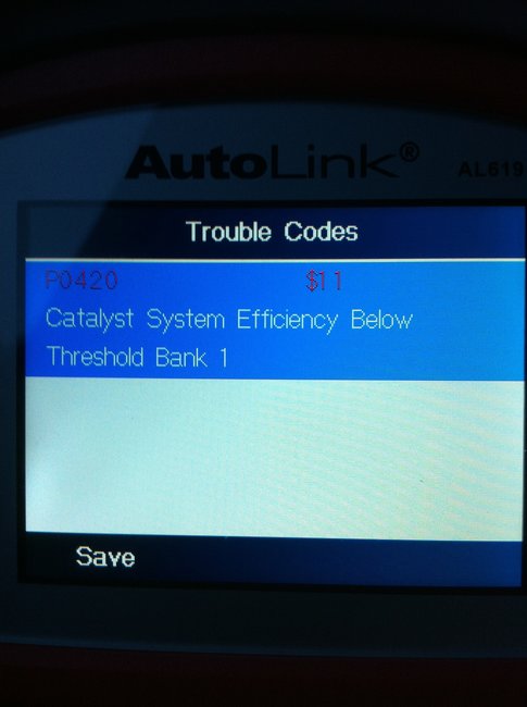

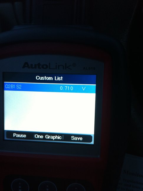

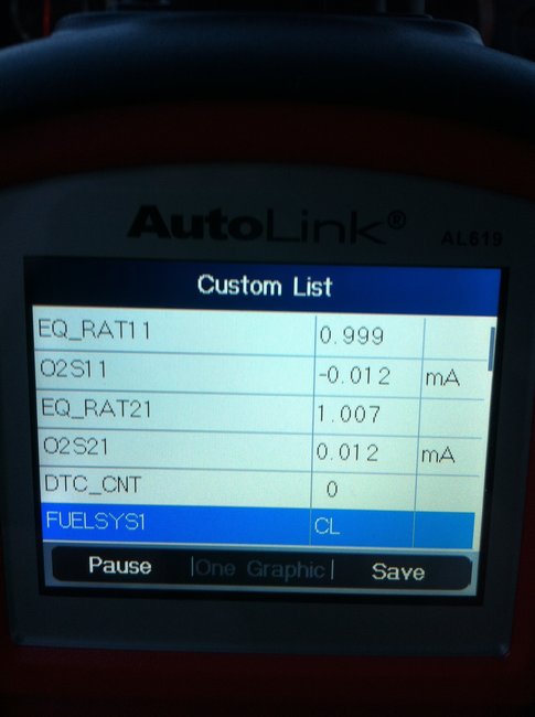

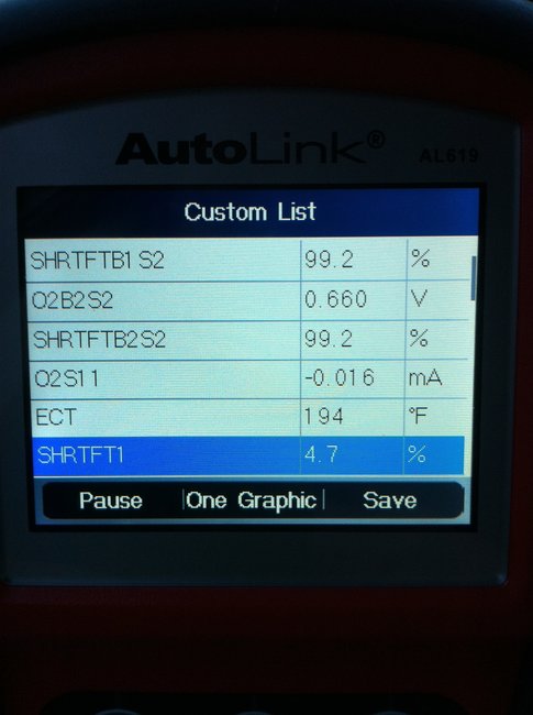

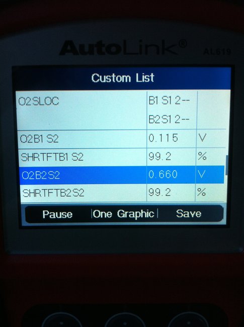

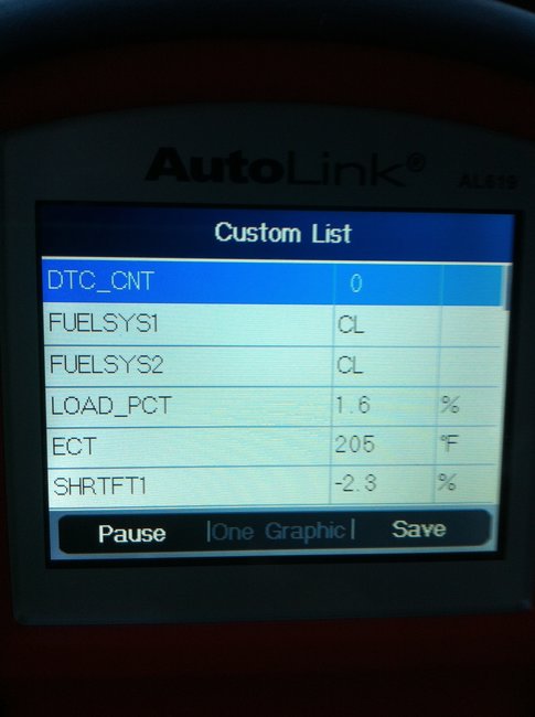

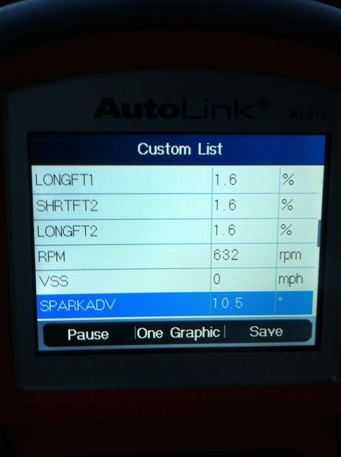

OBD2 scanner code reader images.
Jul 19, 2018 at 1:54 AM
Okay, when the downstream O2 voltage is the same as the upstream voltage, that is when the catalytic converters are not doing their job anymore and need to be replaced.
Those readings indicate a bad catalytic converter.
