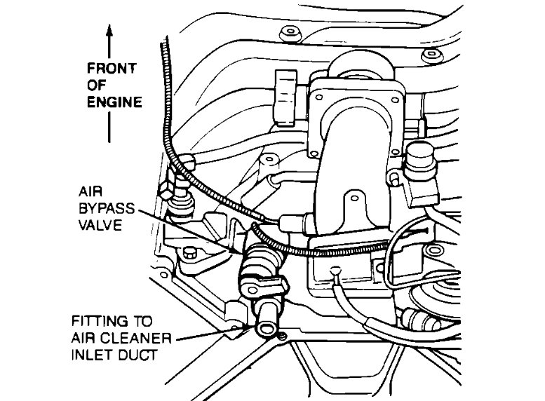

Revs high when put in park.
Jan 3, 2019 at 1:02 AM
Good morning,
The fist thing I would do is check the idle air control valve. it has a habit of sticking and the idle runs high. try removing the wire connector and see if the idle drops down to normal.
https://www.2carpros.com/articles/engine-idles-too-high
REMOVAL
- Disconnect electrical connector from air bypass valve assembly.
- Remove the two bypass valve retaining bolts.
- Remove air bypass valve and gasket.
Jan 3, 2019 at 1:23 AM
TRACEY MCMORRAN
it only high idle in park in drive it is okay. code check said EGR valve. thanks
Jan 3, 2019 at 3:30 AM
What is the code number? I doubt it is the EGR valve at all but if you get me the code number, I can look at the flow chart for the code.
