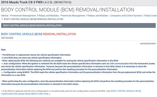

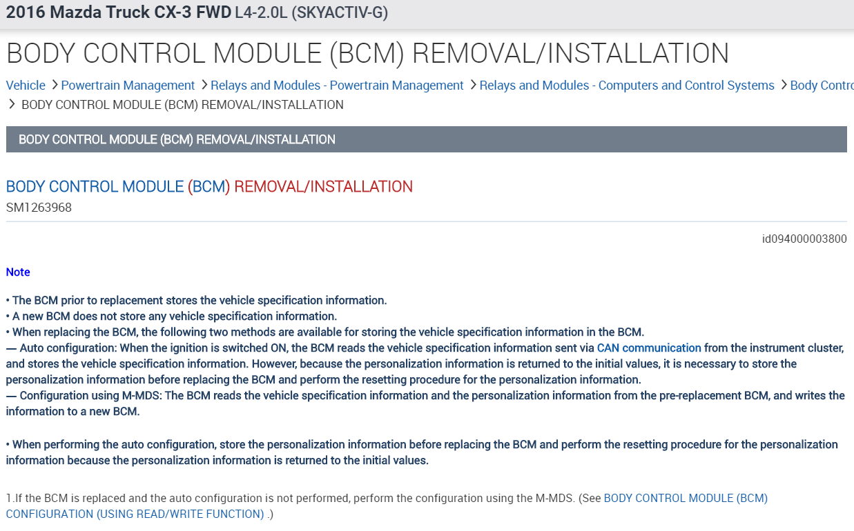

Turn signal bulbs are good (light up when putting emergency flasher and when locking/unlocking car) they just do not work when the turn signal is activated.. What can I do?
Nov 26, 2019 at 2:20 AM
  • 55,433 POSTS

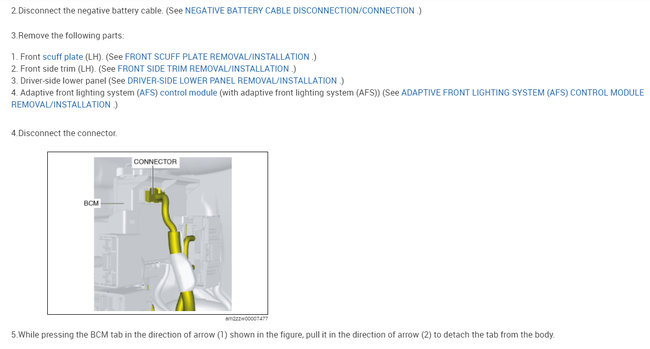

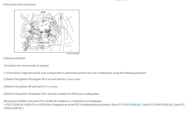

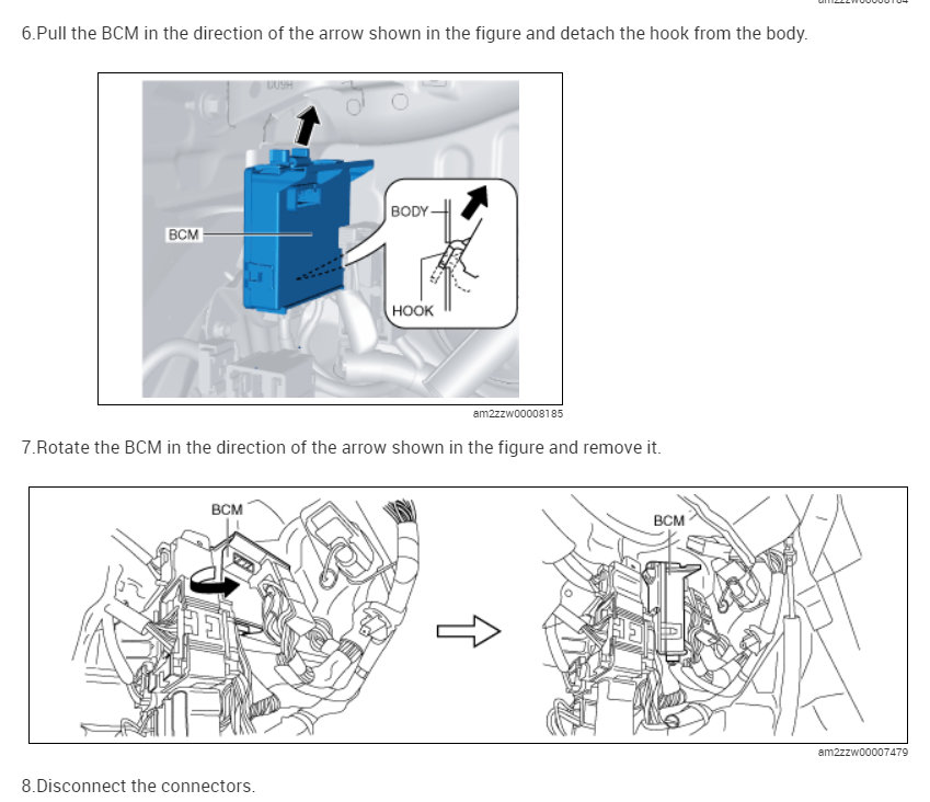

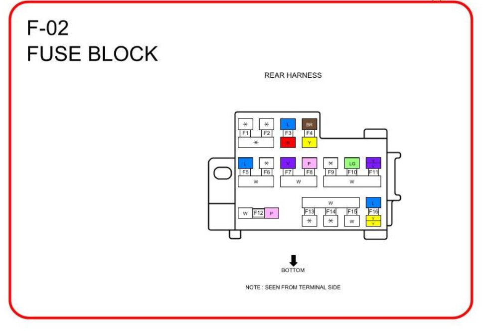

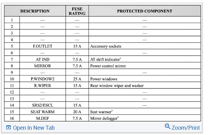

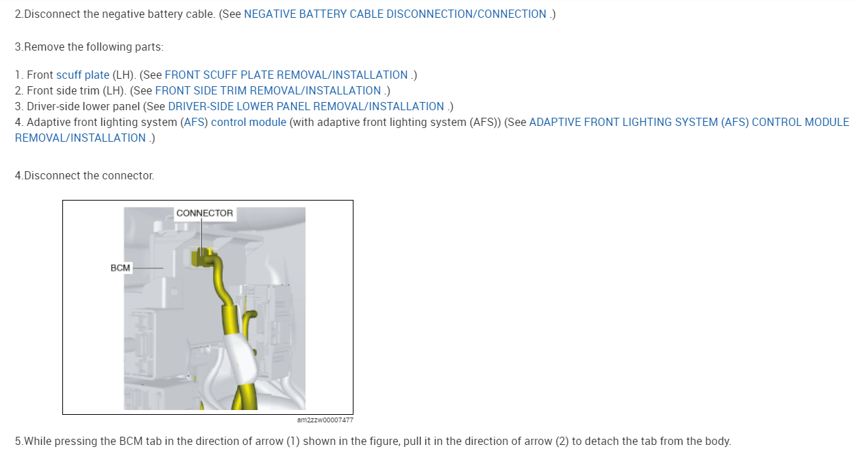

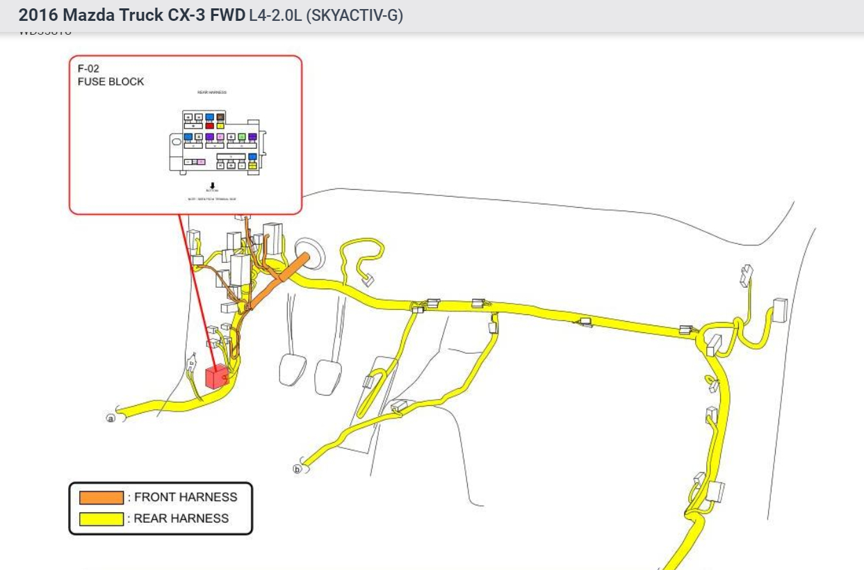

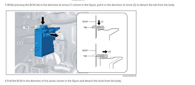

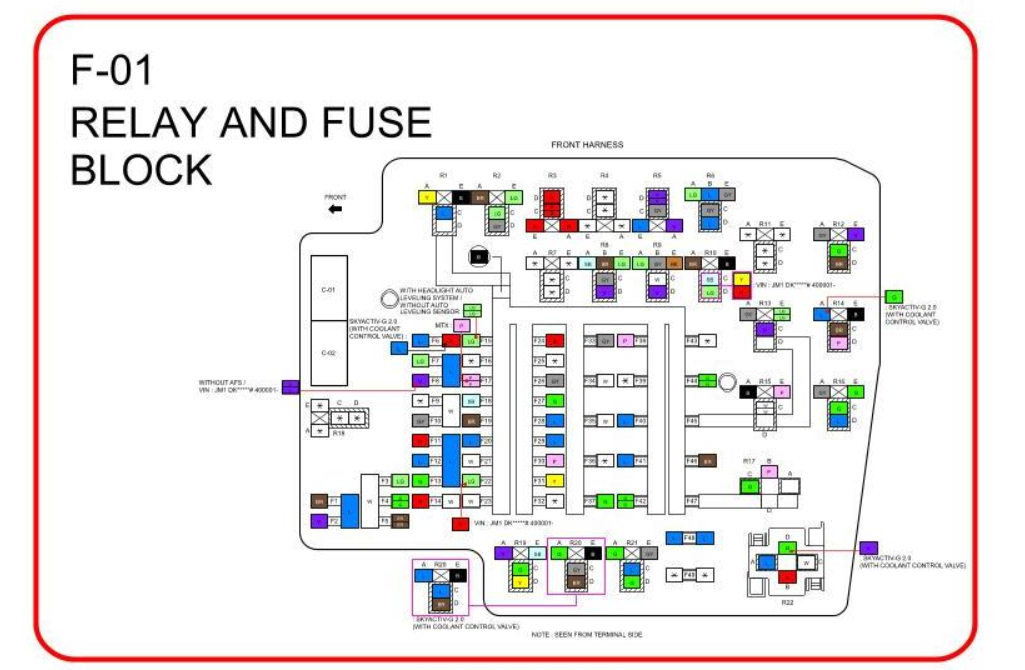

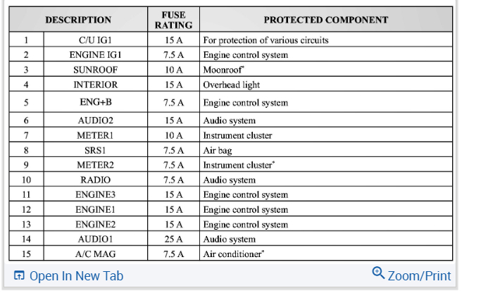

It sounds like the BCM is out. here is the location and how you replace it in the diagrams below. Also I have included the wiring diagrams for the lighting system as well so you can see how the system works.
Body Control Module - DB4G67560B - $152.84

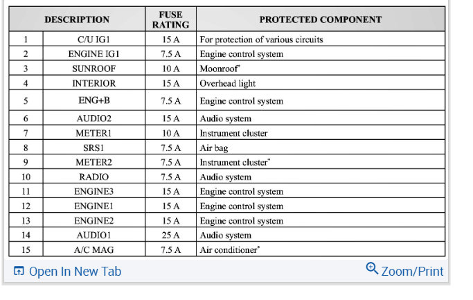

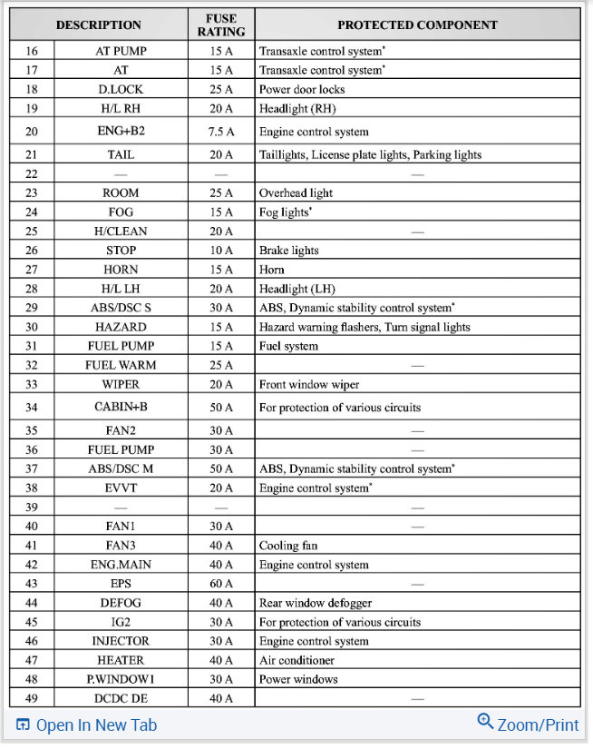

Please check the fuses before you begin.
